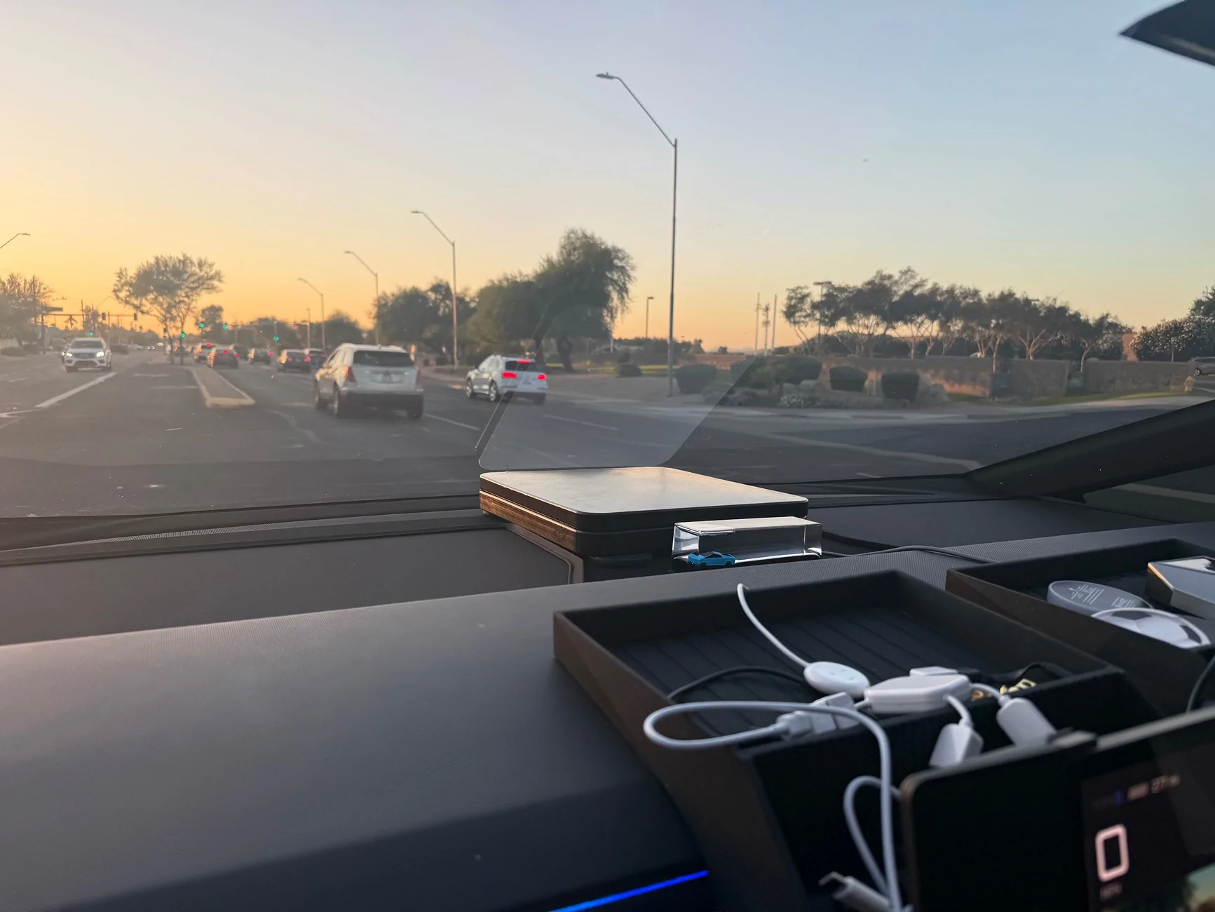

I use string 150lbs magnets which hold my flat black wrapped veritas vans mount to the defroster grill.
Not visually intrusive and works well there.

Thanks. It’s not on any pad. Just has four magnetic feet on it. The dash itself is non-ferrous so the ones closest to the driver are not really stuck but they serve to level the whole thing and if you wanted to remove the mini and stick it to the hood or anywhere else on our steel trucks while parked.
turns out that grill back there where I think the defrost heat comes out IS ferrous. With strong enough magnets (in this case 150lbsx2) it doesn’t budge even with very aggressive driving and off-roading. Once you feel how it sits on there the projectile concern becomes almost moot. At least it did for me.
This is the mount:
https://a.co/d/0de2IwAF
I wrapped the white part with flat black to stop the glare.
In the picture I have my two top shades sitting on the dash on either side which is where I store them for quick access use.
Being black they sort of hide there
https://a.co/d/0fm22Fic

ohhhhh the shades are creating a negative space in front that the starlink just sits in. looks bespoke!
last questions (for today…maybe): wrapped with flat black what? and I saw on the veritas site some kind of add on adapter for the peakdo battery…are you using that?
116
8,363
9,604

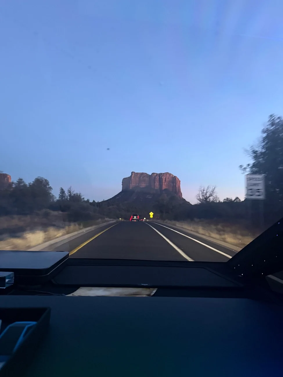

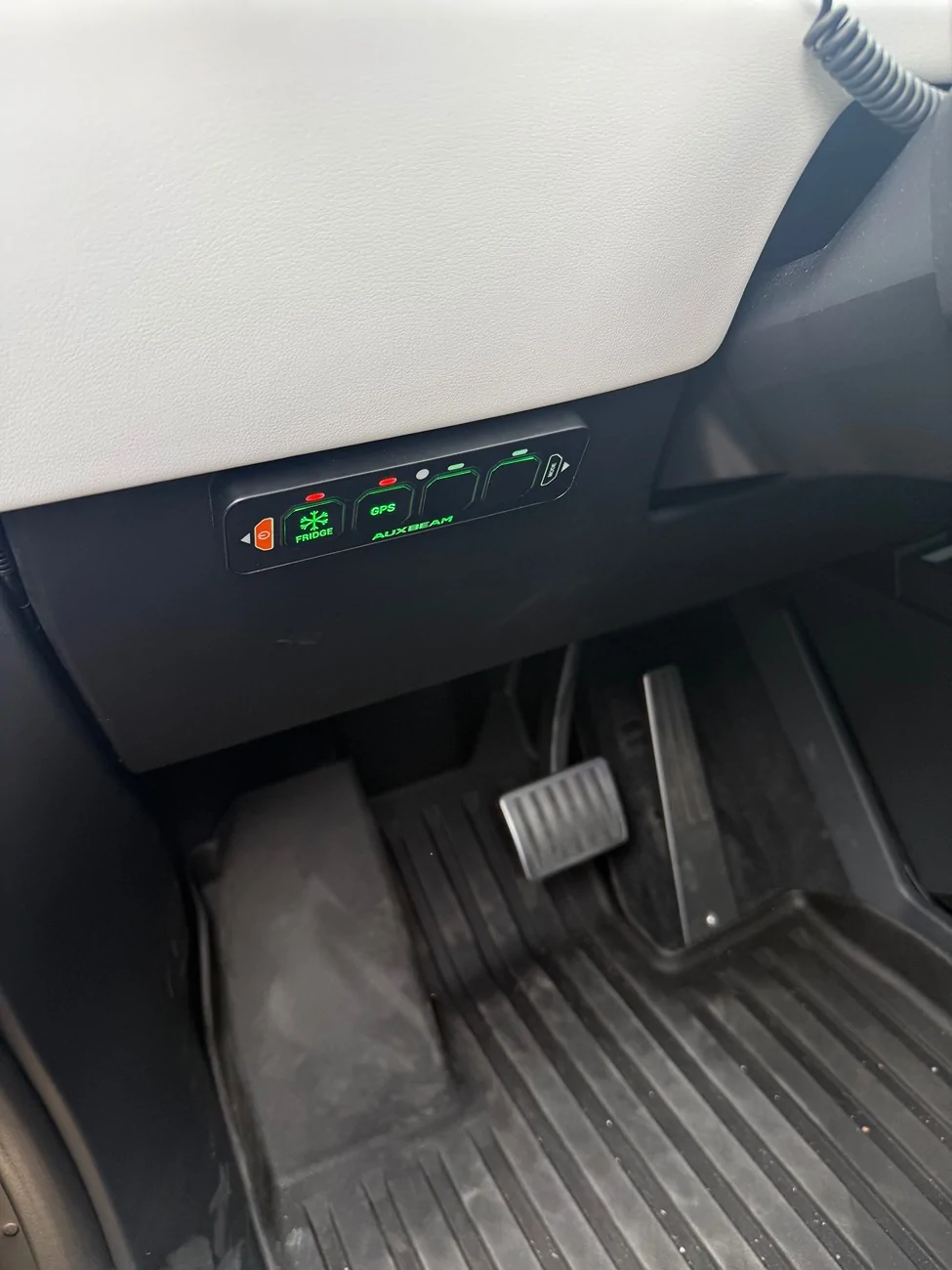

No. Mine runs on my frunk power outlet along with my center console fridge through an auxbeam. This stays on even when level 2 charging, supercharging or the car is asleep so it consumes basically no detectable juice and there is continuous refrigeration and WiFi in the car. Only time that turns off is during a software update.
I ran with a battery for a while but they get uncomfortably hot anywhere you leave them continuously running in the car. I’d advise just keep the peak-do or similar charged somewhere if you really want to retain the ability to take the mini away from your truck.
The wrap is just a piece of excess flat black ppf my wrap guy had in his shop he was going to trash. I want to say flexishield but I don’t remember to be honest. You could use anything really as long as it is flat black or even just put some black cloth over it.
there is a huge difference in glare from white though by doing that. It basically entirely eliminates the reflection .
I’ve never had any thermal issues with it here in Arizona but my windshield is also tinted.
not crazy limo tint but tinted nonetheless.

The button labeled “GPS” is the on/off for the Starlink mini
