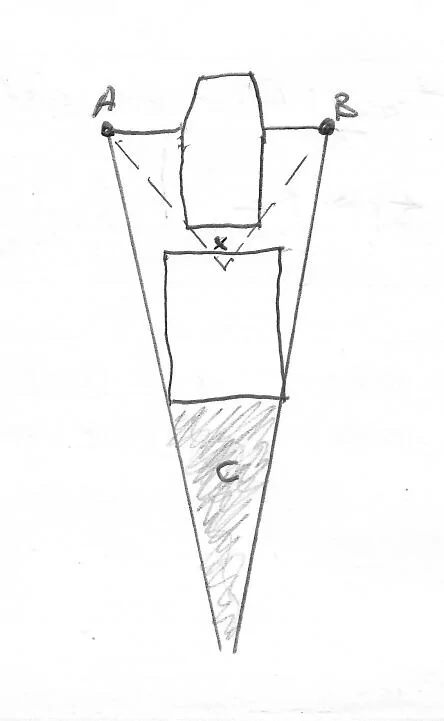

So the driver with a mirror at A would not be able to observe a motorcycle at C but a camera mounted at B would?

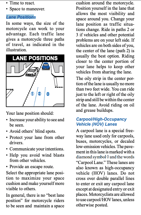

Tesla Cybertruck NO SIDE MIRRORS (Side View Cameras Instead) Lane positio
The guidance a motorcyclist should take from No. 61 is to not ride in the shaded triangle! If you can't see the tractor's mirrors or cameras they can't see you. Don't some trucks have signs on the back that say "If you can't see my mirrors I can't see you."?
Regulatory bodies contemplating allowing vehicles with cameras instead of mirrors should think about marking the cameras in such a way that following traffic can determine with certainty where the cameras are located for just this reason.

Also the diagram makes it quite clear that the mirror has to be further out to show the entire side of a trailer in a turn to the passenger side.

Hmm. The blue line is straight and parallel but funny how the straight lines turn red and intersect. Did they bend? Maybe it's a black hole. You use math which is a very precise language but like the scalpel in the hands of a surgeon with Parkinsons the result isn't a successful surgery. Its hamburger. With precise tools you cannot skip small details like completing the image path to the eyes of the driver. The reason mirrors are placed outboard for long vehicles is not to provide a better look behind the vehicle, it is so that the angle of the mirror in relation to the drivers eyes allow the driver to see what is beside his vehicle for the whole length. Indeed placing it forward on the vehicle allows shorter outboard with the same size mirror and the same view. I'm guessing if you can see behind your car with the side view mirrors that you can also see your car in the mirrors and that you cannot see a car that is beside you. Lucky for us FSD is coming.

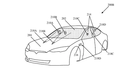

Looks like Tesla might have the camera cleaning issue sorted already : )
Tesla Patents Frickin' Laser Beams That Clean a Car's Glass
The technology could ensure cameras used for the Autopilot driver-assist system have a clear view of the road.
Tesla Cybertruck NO SIDE MIRRORS (Side View Cameras Instead) 16f63cdc-f6f1-41da-ae08-c3124a955056_1543373149
By Eric Tingwall
NOV 29, 2019
Tesla Cybertruck NO SIDE MIRRORS (Side View Cameras Instead) -pm-1574895282.png?crop=0.879xw:0.852xh;0.0544xw,0
Tesla
  • Tesla has filed a patent for the process of cleaning a vehicle's glass surfaces using laser beams.
  • The laser cleaning process could clean dirt and other debris blocking the view of a camera used for advanced driver-assistance features.
  • Tesla also says the lasers could be used to clean the surfaces of solar panels.
Yes, but they didn't curve. Looking at this and the post I originally responded to

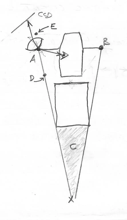

I've put the onward paths from the collector aperture in the diagram and I've drawn it in such a way that it shows what happens with either a lens or a mirror. First consider the curved surface closest to the letter A to be a curved, silvered surface. A light ray from X strikes that silvered surface at some point such that the incidence angle is equal to the angle between that point and the driver's eye. Note that this surface does not have to be curved but if it is flat it's normal must bisect the angle between the incident and the reflected ray which reaches the driver's eye. A ray from C cannot reach the driver's eye because it is blocked by the back of the trailer. Move the mirror closer to the vehicle if you want or closer away. The concept remains the same.
Tesla Cybertruck NO SIDE MIRRORS (Side View Cameras Instead) CTMirrors1 2
Now let the mirrored surface be the front surface of a simple camera lens. An incident ray from X impinges on this surface and is refracted as it propagates (in a straight line) through the glass and then is refracted again at the rear surface from which it travels (in a straight line) to the CCD. As with the mirror, a ray from C cannot reach the lens and cannot be imaged by the CCD. Thus, whether the ray from the mirror to the eye is shown
Were that true there would be no reason for a truck driver to purchase a sign cautioning following drivers to stay far enough behind that they are out of the C zone and can, consequently, see his mirrors. Thus it is demonstrably not true.
.. it is so that the angle of the mirror in relation to the drivers eyes allow the driver to see what is beside his vehicle for the whole length.
It should be clear from the diagram that as drawn the driver, be he using camera, flat mirror or curved mirror can see the whole side of the trailer and the road further behind him than X. It should also be clear that if he move the mirrors or camera in the subtense of the side of the trailer on his retina or on the CCD of the camera is lessened so that he cannot see as much detail (the image of the leading edge and trailing edge are merging) while at the same time X is moving backward. It should also be clear that if the mirrors are moved in to a distance half the width of the trailer from the vehicle axis that he will not be able to see the sides at all. It should also be clear that in none of these cases does it matter in the least whether the sensor is a mirror or a camera.
It should also be clear that if you move the mirror forward to the front of the vehicle you would have to move it outboard to position E in order to have the same angular subtense of the side of the truck and same size rear blind zone and you would have to make it larger whereas if you move it all the way to the back you can move it inboard to position D (though clearly it would have to be a camera and you wouldn't be able to see the side of the car).
Remember that there is an image world behind the mirror and the mirror is a small aperture in a wall that gives you a view on that world. You chose the part of that world you want to see by tilting and/or rotating the mirror and positioning your head. In the X the mirror (and thus the window) are too small to let you see what's behind you well and at the same time a car that is closing from behind unless you move your head around a bit. This is the oft discussed X blind spot. The solution to this problem is supposed to be the sonic sensors which, if they detect the approaching vehicle will image it on your driver display and if it is really close make all kinds of noises. But the sonic sensors are pretty short range. The cars really need another radar in the back,
