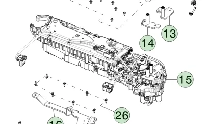

Ok, was able to get my CT back today. Looks like the fuse on the device cluster that attaches to the ancillary harness was blown. They did confirm my HV wiring harness was shorting out as well. Looks like they replaced the device custer and wiring harness. I can now AC charge with no issues. To be honest, I don't know exactly what the device cluster is...I assume it attaches to the battery. While at the service center I noticed my driver side A pillar was protruding toward the back only to find the double sided tape was coming loose. Ugh! The joy of being an early adopter. Haha! Still Love my CT!
May 27, 2024
4,730
5,786
Device cluster is most of the guts of the PCS HV section part 15:
Tesla Cybertruck Not Again....No charging (AC) after update. SmartSelect_20241010_083037_Firefox
Procedure with photos
https://service.tesla.com/docs/Cybe...UID-0DEC6C08-C88C-4C78-AB8E-C90D6E58A49C.html
