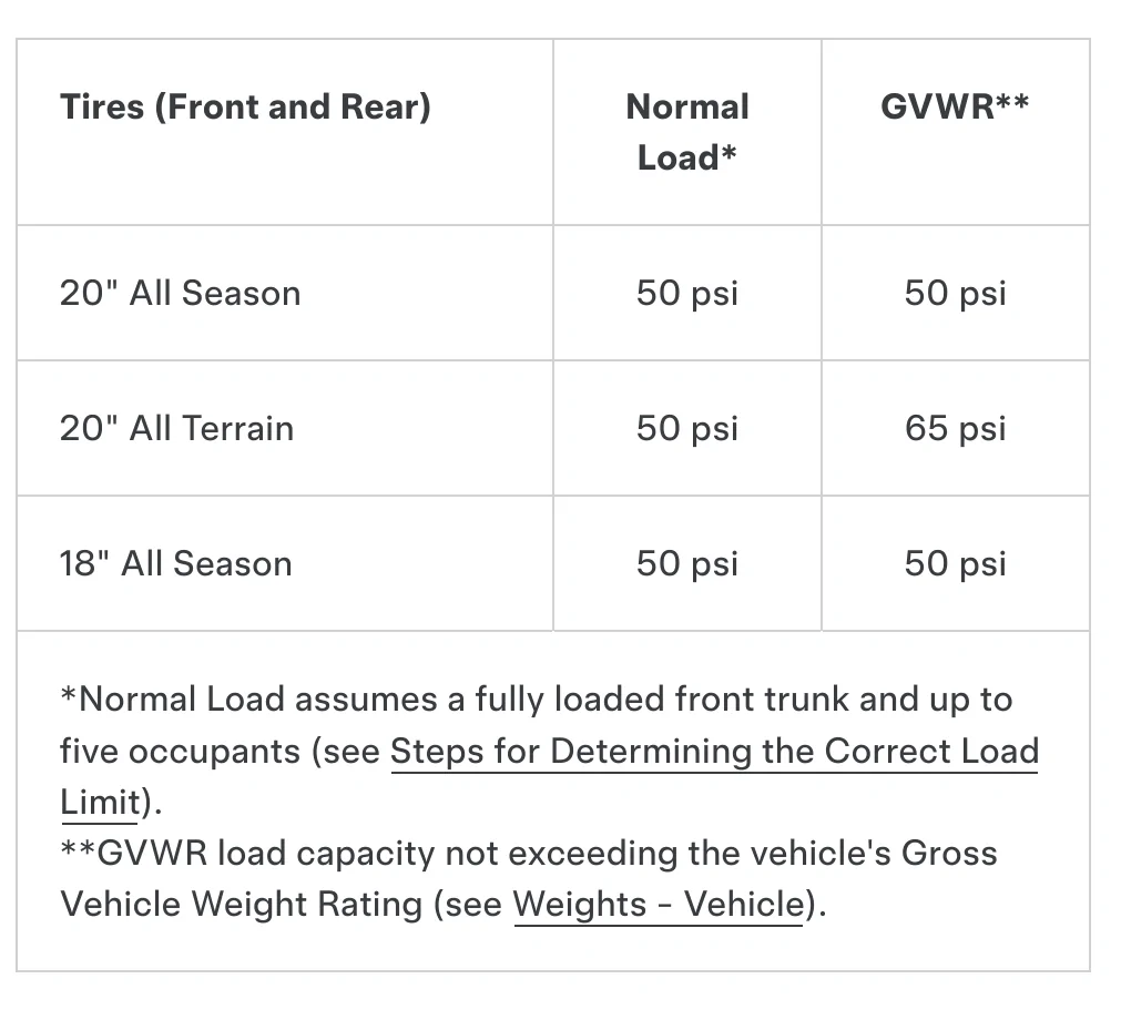

Is it actually a warming, or just saying 50 psi is recommended?
Stock all terrains when at max GVW or towing call for 65 psi, so over 50 isn't necessary wrong.

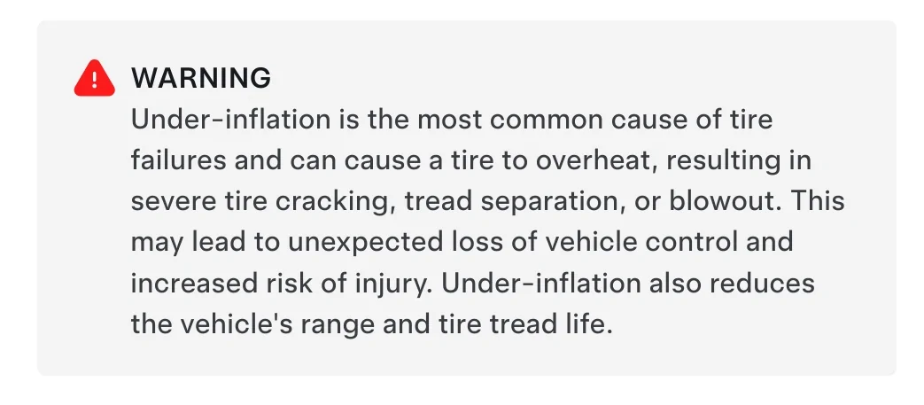

Tire loading rating depends on pressure. 50 psi may be underinflated for non-OEM tires which isn't good.

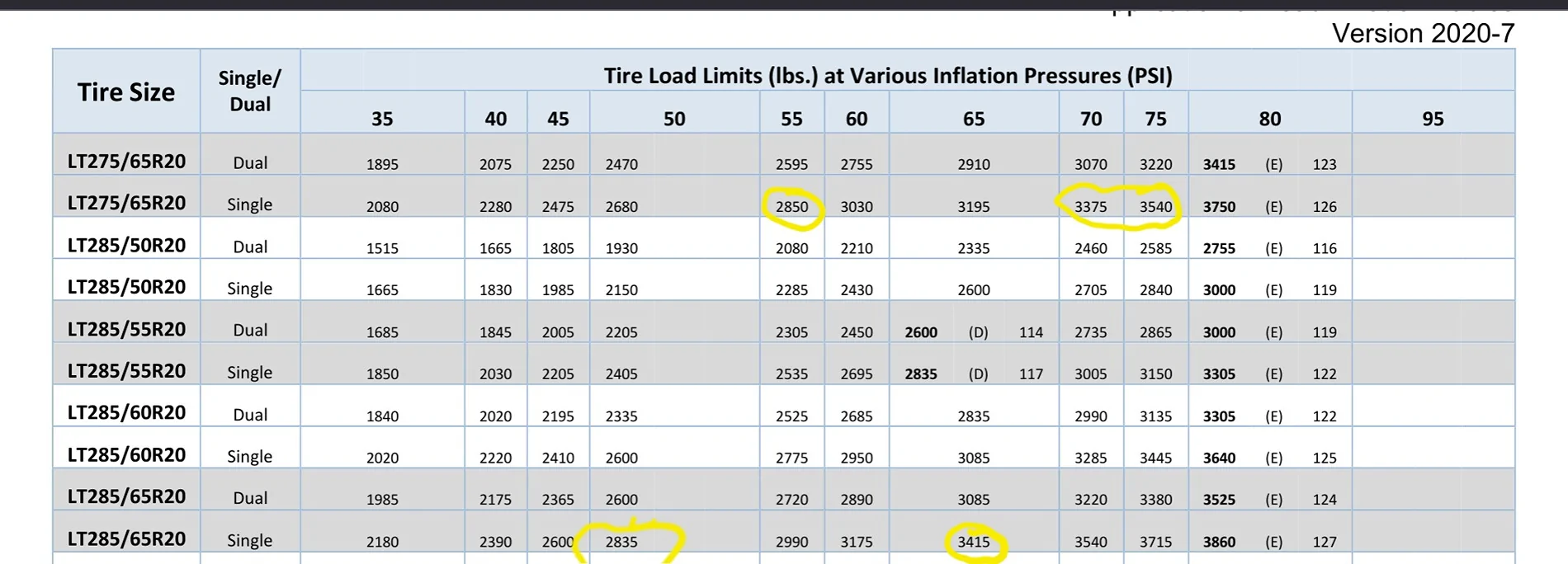

This table calls out equivilent load handling at 55 vs 50 and ~71 vs 65
Tesla Cybertruck Now running an E rated tire! New tire pressure question. AISelect_20250922_095926_Firefox
https://www.toyotires.com/media/pxcjubjs/application_of_load_inflation_tables_20200723.pdf

You are correct and I was hoping not to get into using a slightly different size tire. But I wanted the LT in the EV format. The closest I could get is the 275/65R20 which is about a 1% difference in overall diameter which is minimal. For a 55lbs LT tire it's hard to beat. And I am not seeing much of a range hit and I am using energy used for a similar section of road not Wh/mi since the diameter is slightly off. Slightly smaller contact patch is worth the benefits for my use. 600 mi so far and I am very happy with the feel etc.
