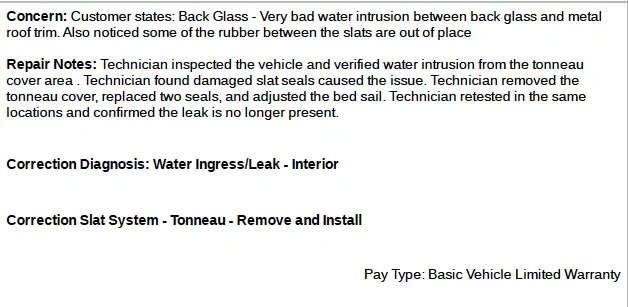

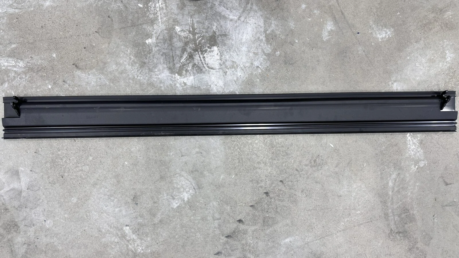

I'm in NY, had the same experience. Took it to one service center last year they added a slat but nothing changed. Took it to another one last week as part of a PCS issue and they did the below:
Correction Inspect For Exposed Water Management Channel;
Install Additional Tonneau Slat
CHAIN BUSHING HULL PART - TONNEAU SERVICE KIT(200698700-A) 2.00 SLAT
BOLT - ROLLER TONNEAU SERVICE KIT(2006980-00-A) 2.00 BUSHING SLAT - SEAL ASSEMBLY - TONNEAU SERVICE KIT(200697800-A)
Correction Test To Confirm Water Ingress No Longer Present

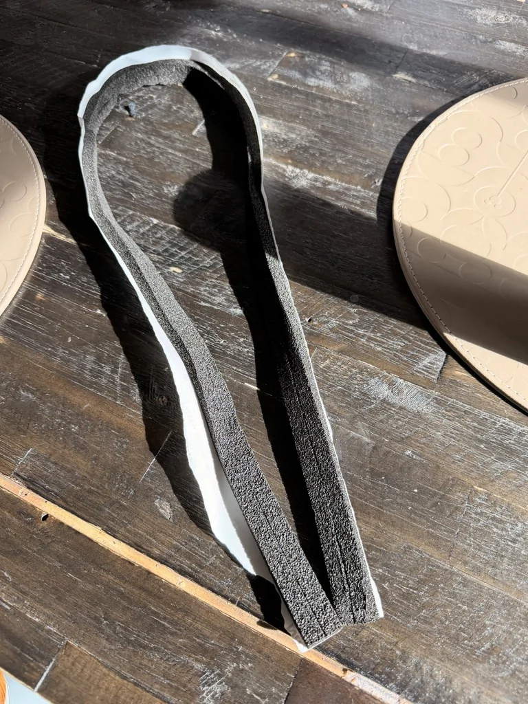

Correction Applique - Upper - Tonneau (Long Range) - Remove and Install Parts Replaced or Added Part Quantity SEALING FOAM(1098720-00-B) 2.00
