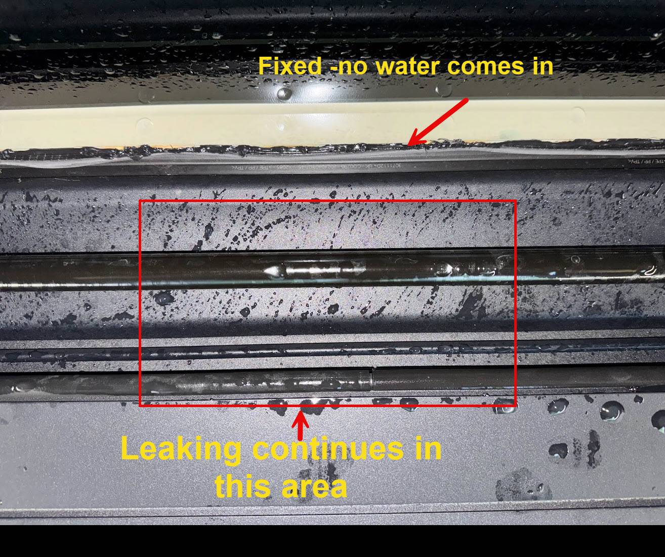

I followed all the suggestions adding both caulk and a weather strip to seal the glass portion, but water is still coming in from another area. Also, it should be noted, I didn't have any foam attached to the glass to remove (I followed this: ).
Here what I see when looking upwards:

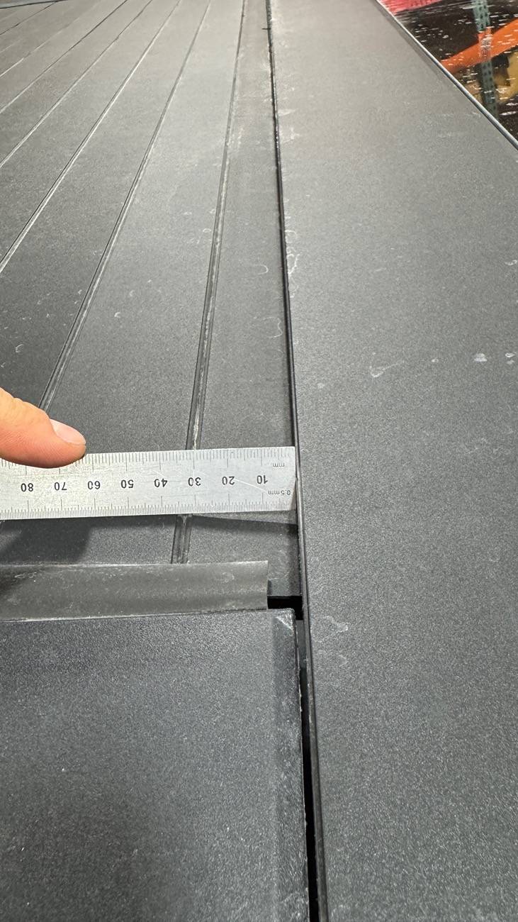

My tonneau didn't leak at all for months, but now it does because the cover somehow became misaligned leaving a gap at the top on the driver's side for water to get in. Calibrating the tonneau cover (Service menu) doesn't correct the misalignment. I'll have to take it into my SC one of these days.
I had a similar skew and it took them a bit to sort it out but its all nice and parallel now.

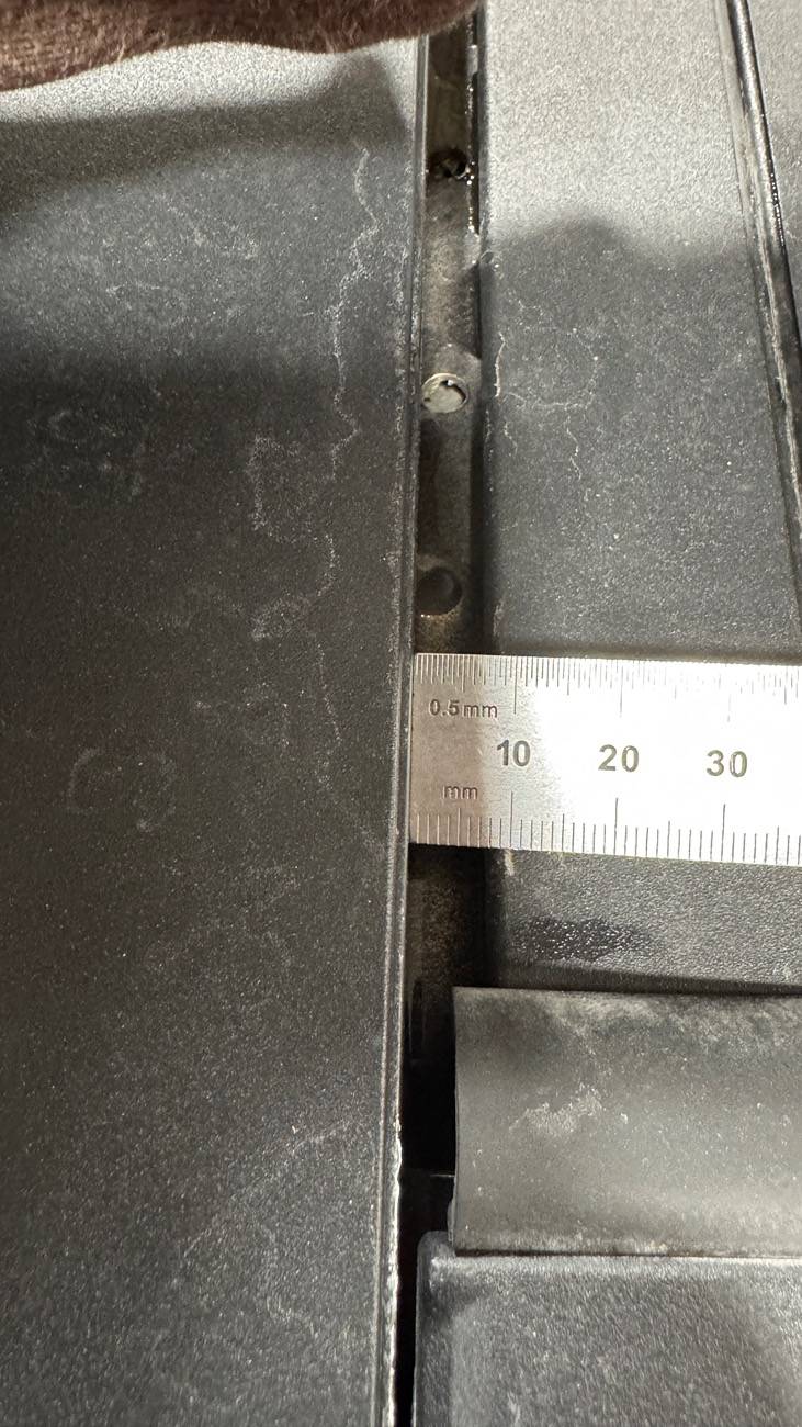

Do you know what your SC did for the tonneau fix? My tonneau is shifted 10mm
Verified concern, at start of service found tonneau cover performing as described.
Inspected and found the tonneau rail width out of spec, and the motors twisting on their housings.
Adjusted the rails and replaced both motors. Further found consistent binding in the right rail when
approaching 100% closed. Replaced the right tonneau rail and verified healthy tonneau
calibration. Cycled tonneau over multiple sleep and wake cycles and verified behavior is consistent
and no further issues are present.

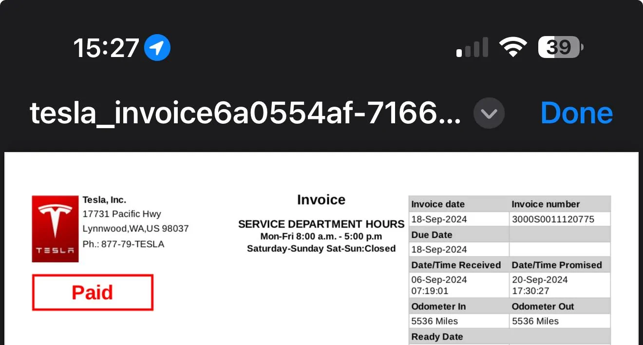

Do you mind sharing what Tesla service center performed your maintenance, what state, city? I’m going to pass along your service note in chat while my truck is in service and want to reference your service center used. Thanks!
Lynwood,WA that was from September 24
