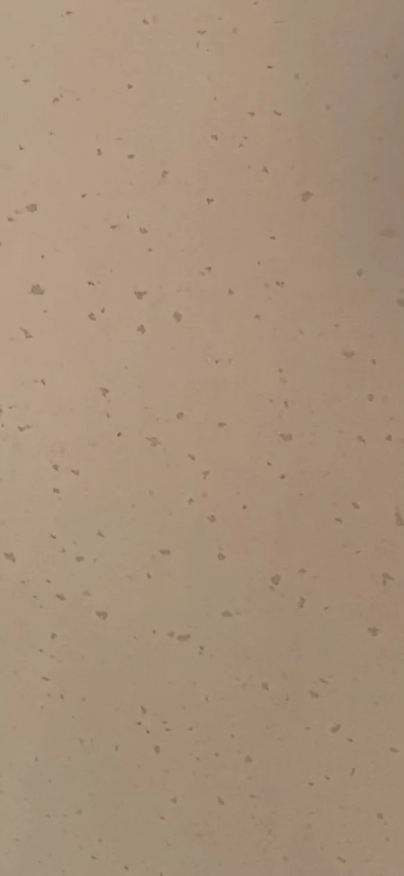

Before and after. Better…. I’m not sure.
Hi, The pic is a little difficult to fully see what's going on. Are these spots over the entire truck? Has the truck ever been coated with anything? Ceramic or other protective coating. Did you allow Cyberbrite to stay wet on the truck for a minimum of 15 min. (longer would be better) Did you apply the second coat over the first keeping the application cloth clean? Any application details you can share may help me to diagnose the problem.

Nothing has ever been applied to the truck. Only car wash sprayer soap and rinse. Spots are mostly on the sides and back of the truck. The spots appeared early 2025 when we were driving in snow up in the mountains of Vail Colorado. Thinking it was something put on the roads or something. Followed written directions that indicated 10 minutes per each coat. I feel like it brightened the steel but didn’t do much for the spots. Larger pic, zoom in to see spots.

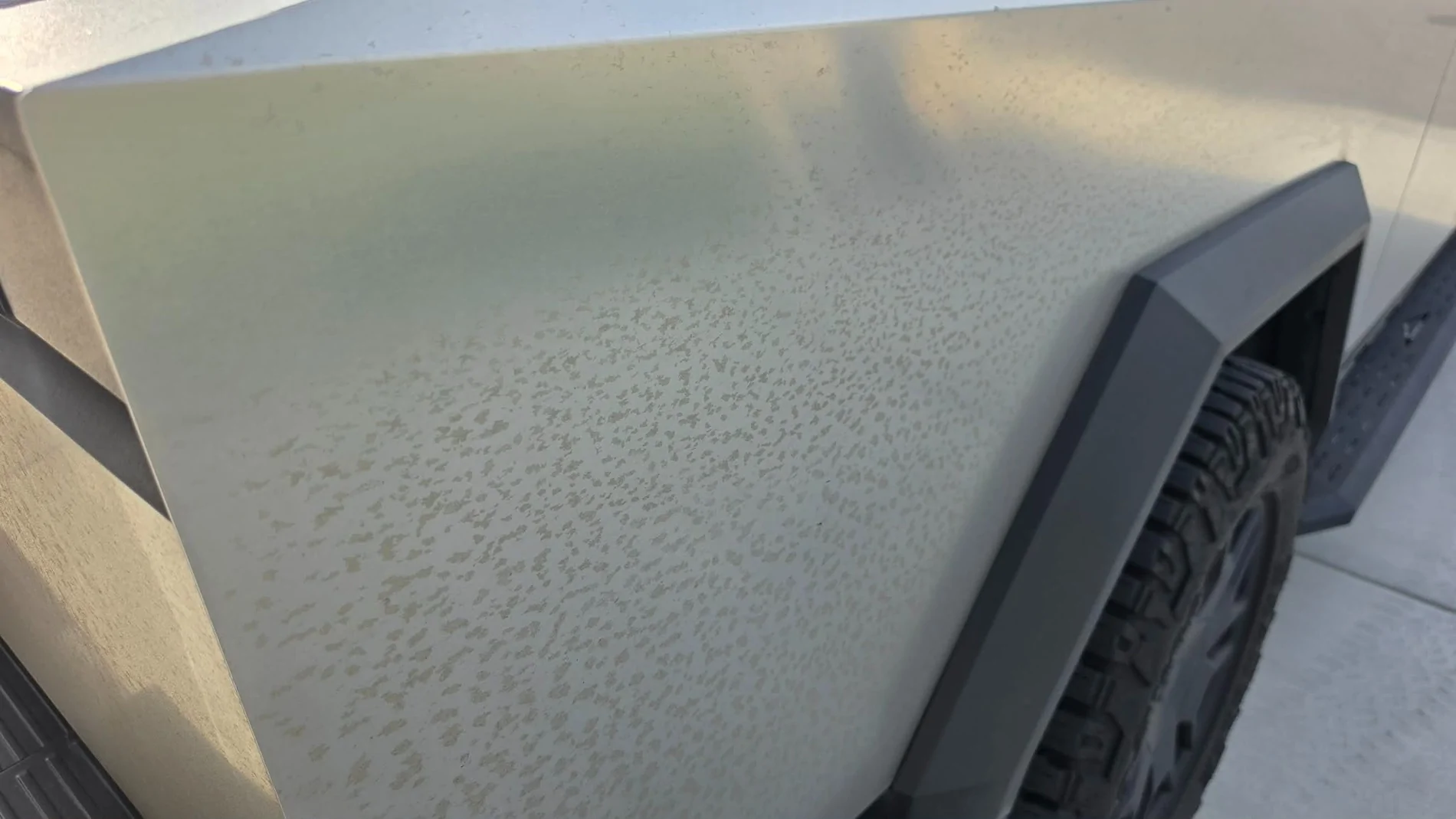

Front fender contamination on the leading edge of the metal, pre-wash.
Tesla Cybertruck CYBERBRITE--Cybertruck De-staining and Passivation Solution (REDUCED INTRODUCTION PRICE $23.95) PXL_20260430_172944020
Front fender contamination after soap/hand wash. This would be removed by the Cyberbrite application either by chemical process, or mechanical buffing with the cloth.

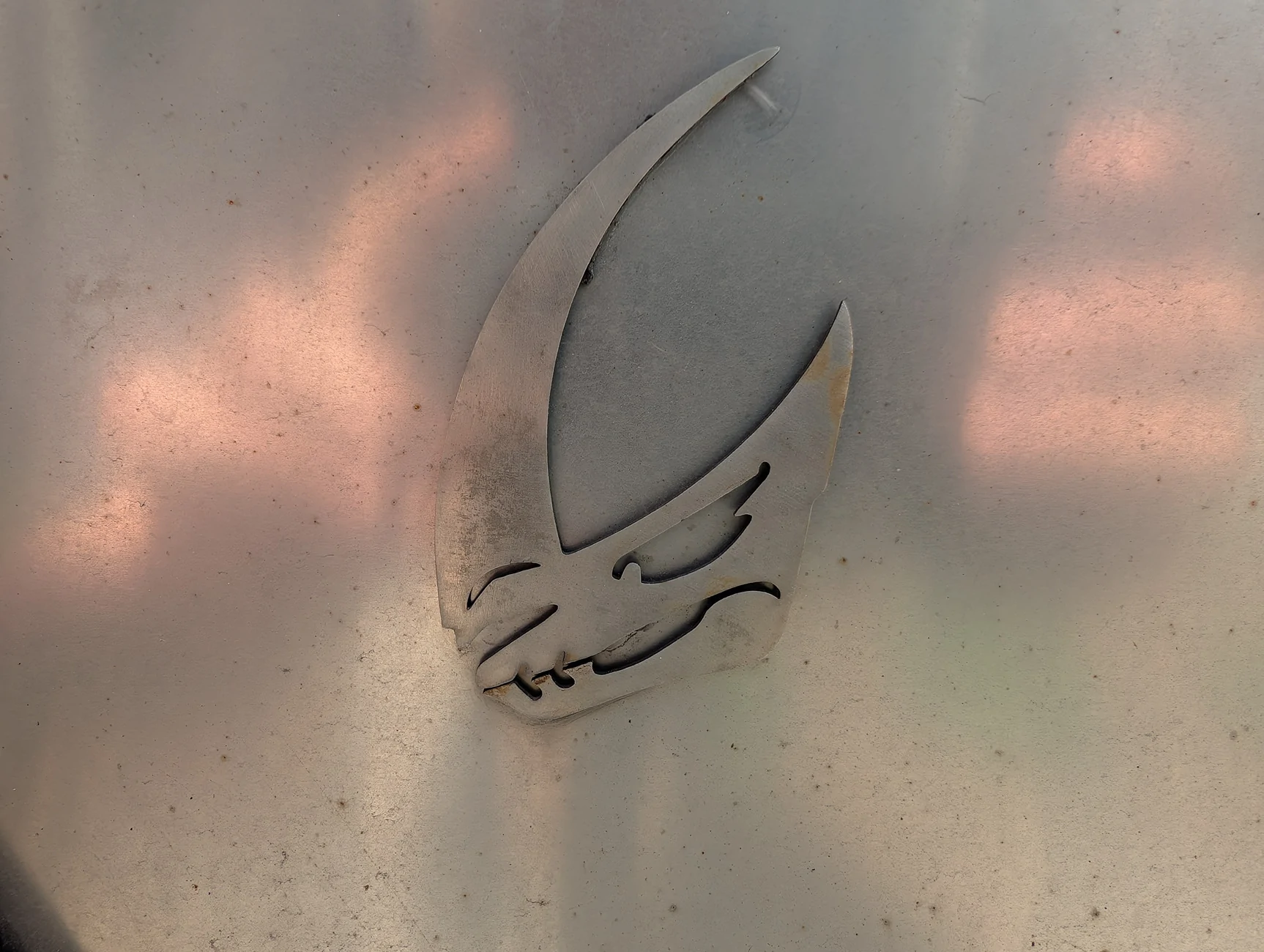

A stainless steel badge pre-hand wash. Some rusting on the badge itself, and notice the dark contamination on the truck steel.
Tesla Cybertruck CYBERBRITE--Cybertruck De-staining and Passivation Solution (REDUCED INTRODUCTION PRICE $23.95) PXL_20260430_174031261
Badge during application of Iron-X
Tesla Cybertruck CYBERBRITE--Cybertruck De-staining and Passivation Solution (REDUCED INTRODUCTION PRICE $23.95) PXL_20260430_184315948
Badge and truck after application of Cyberbrite. I didn't attempt to decontaminate with the Cyberbrite alone since I was looking at so much contamination. The Cyberbrite certainly brings back the silver color or the steel, removing the general brown discoloration.

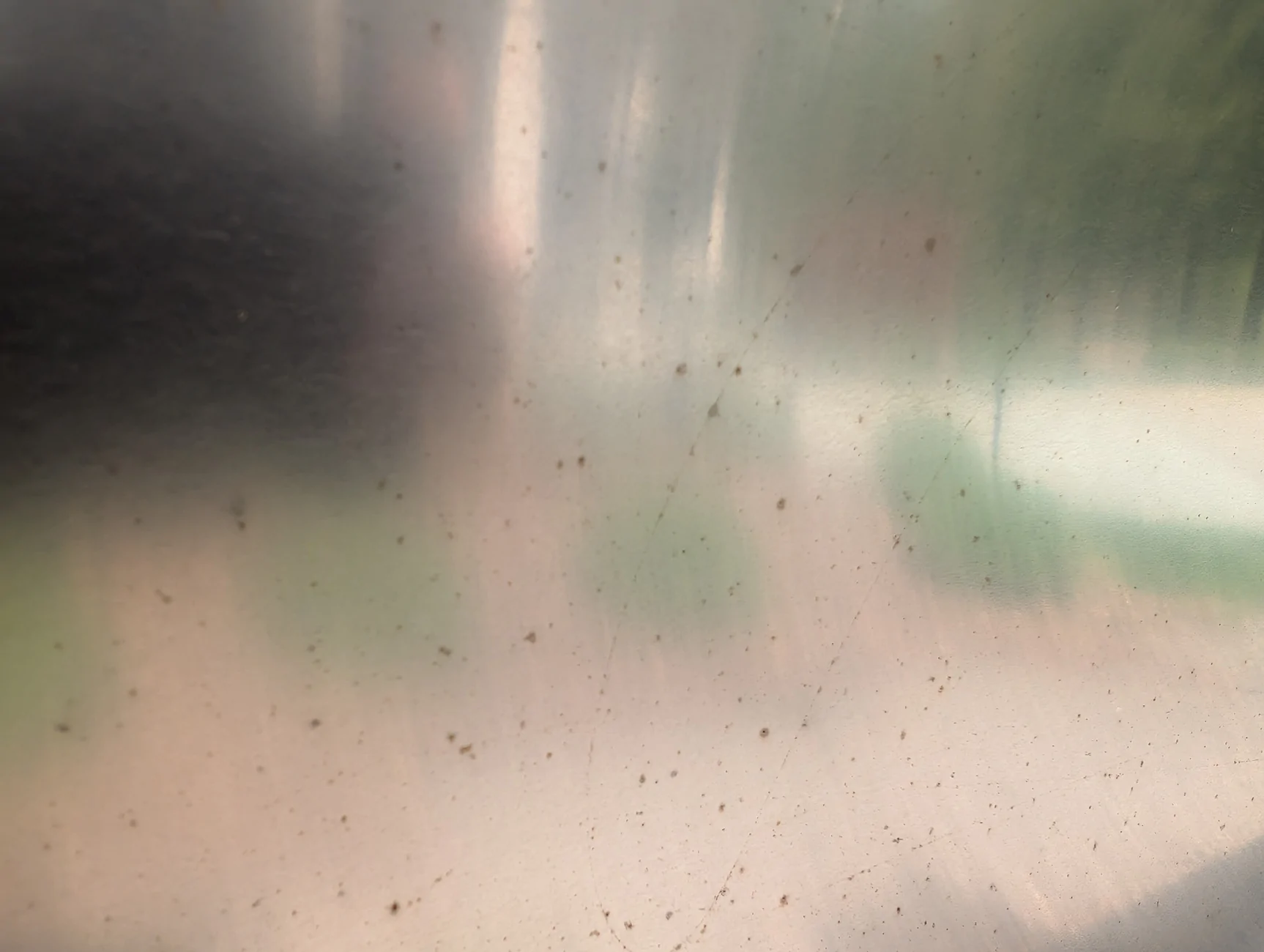

Passenger side door panel. A good look at the contamination I was dealing with.

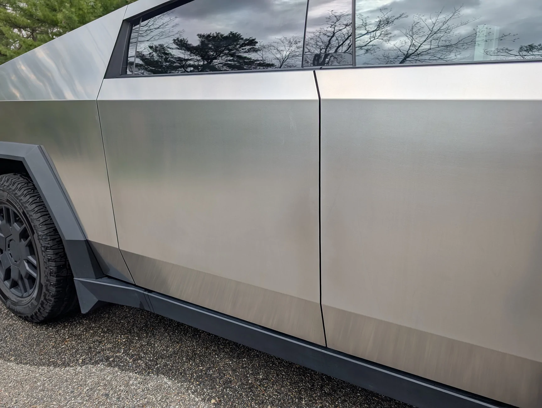

Tailgate post wash, pre Iron-X. The little spots of contamination were all over the vehicle. Spraying the Iron-X requires less labor than applying the Cyberbrite, so I think it's a good step.
Tesla Cybertruck CYBERBRITE--Cybertruck De-staining and Passivation Solution (REDUCED INTRODUCTION PRICE $23.95) PXL_20260430_184349818
Tailgate post Cyberbrite. You can see how much more silver the stainless steel becomes. Even after the Iron-X, some of the brown patina remains. The Cyberbrite appears to remove this discoloration.
