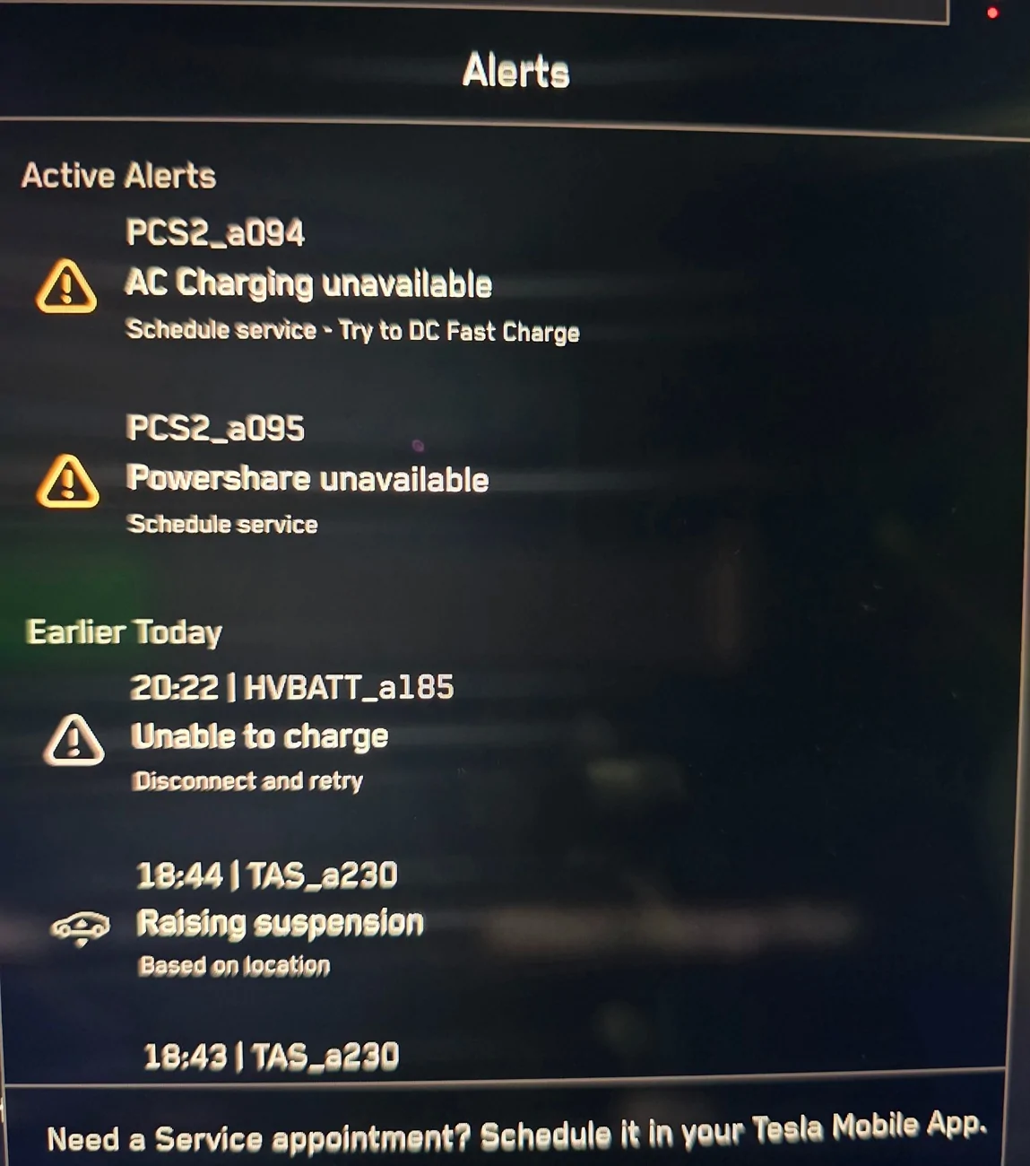

Open a service request and post this screenshot in the app. They do a remote diagnostic check and determine what's next.
I suspect the PCS2 will be a formal recall but right now it's more of a silent recall. And not even a public facing service bulletin yet either.
Thanks. Will do!

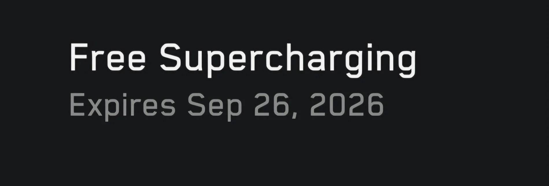

That hurts! However, you can still DC charge the vehicle. Supercharger. I read a post that said Tesla paid for or he received free supercharging until Tesla service could get him scheduled in for the repair.
