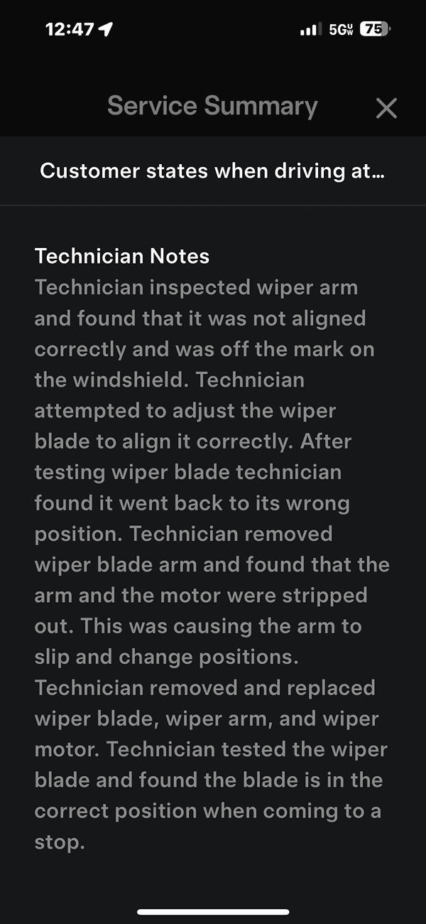

OK so my truck is fixed. Tesla covered the $2100 roof replacement. They fixed the wiper issue. For the one that was told there is no recall on the wiper motor, there absolutely is and you need to pull it up so you can get the repair.
I was told the wiper was more on the right side (from driver perspective) due to an alignment issue and a stripped motor part. They realigned it and replaced the motor again. I have not seen it yes but will get it sometime today and confirm.

See attached notes from my Wiper motor repair in order to fix alignment issue. At 65 mph the blade should move towards the left edge of the windshield (drivers perspective) where it’s barely visible from inside the vehicle. This changed after my wiper recall motor repair. This was their repair notes. See attachments.

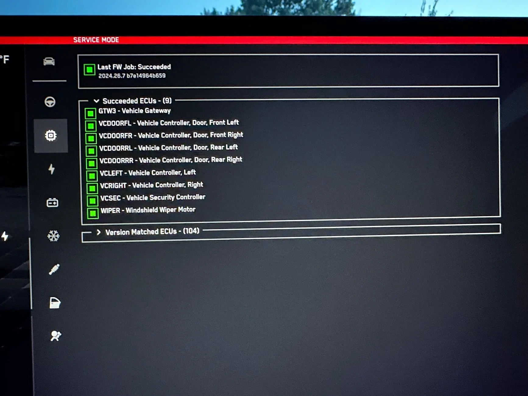

Tesla Cybertruck Post wiper motor recall -- wiper alignment : no longer moves to the far left side of the windshield location? IMG_0161
Notice latest update on the wiper motor today. Note the last item in the update.

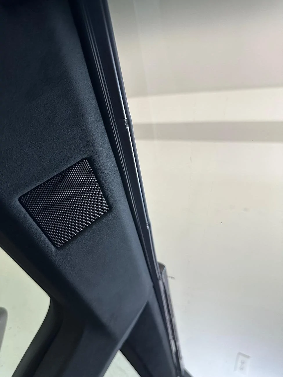

There is a near invisible arrow on the windshield where the tip of the wiper is supposed to sit at rest. The wiper assembly must be unbolted and aligned to that arrow.
