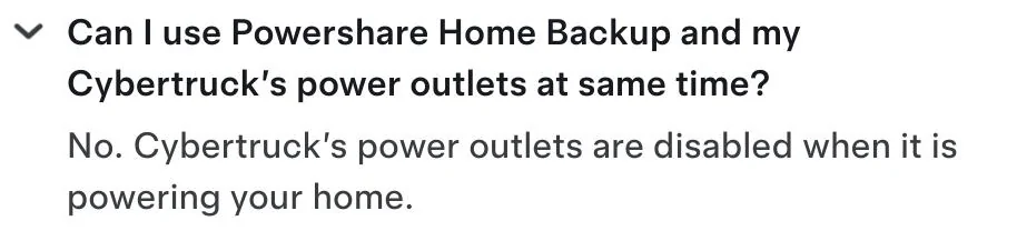

  • Can anyone with PowerShare installed confirm if you can use both PowerShare and the 240v bed outlet at the same time? e.g. if my power goes out, can I use PowerShare to power my home while also plugging an EV charger into the 240v outlet of the CT at the same time?

Ok wow I could’ve sworn I looked at that whole FAQ but must have somehow missed it. Funny story - calling Tesla support they told me the exact opposite.

Totally agree! Now if you could stack 9.6 outlet KW plus 11.5 PowerShare KW that would be a whole different ball game!
They are fed from the same power conversion system, so it can't happen...
