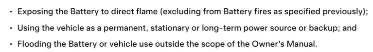

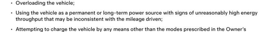

If by "flip on" you mean powering the house from the Cybertruck every night, you may be in for loss of warranty.
https://digitalassets.tesla.com/tes...rtruck-new-vehicle-limited-warranty-en-us.pdf
