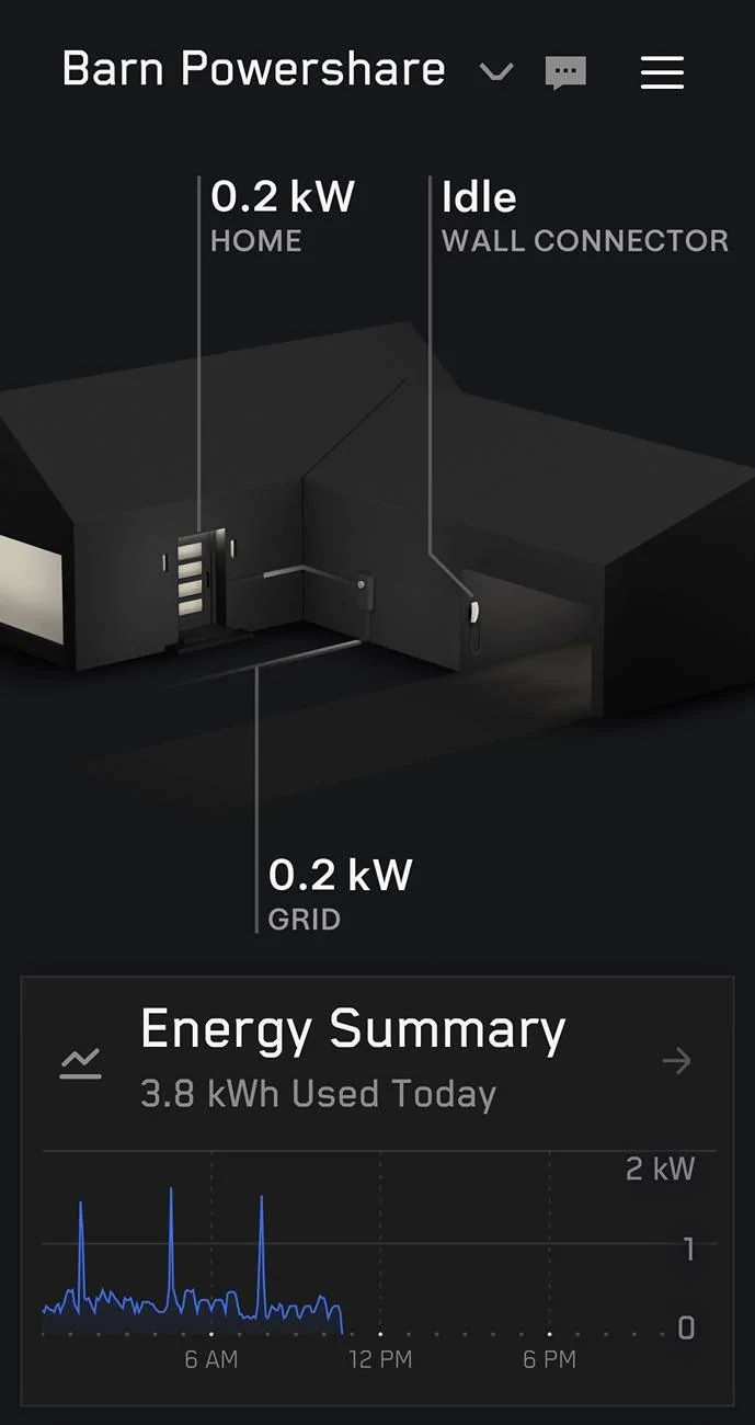

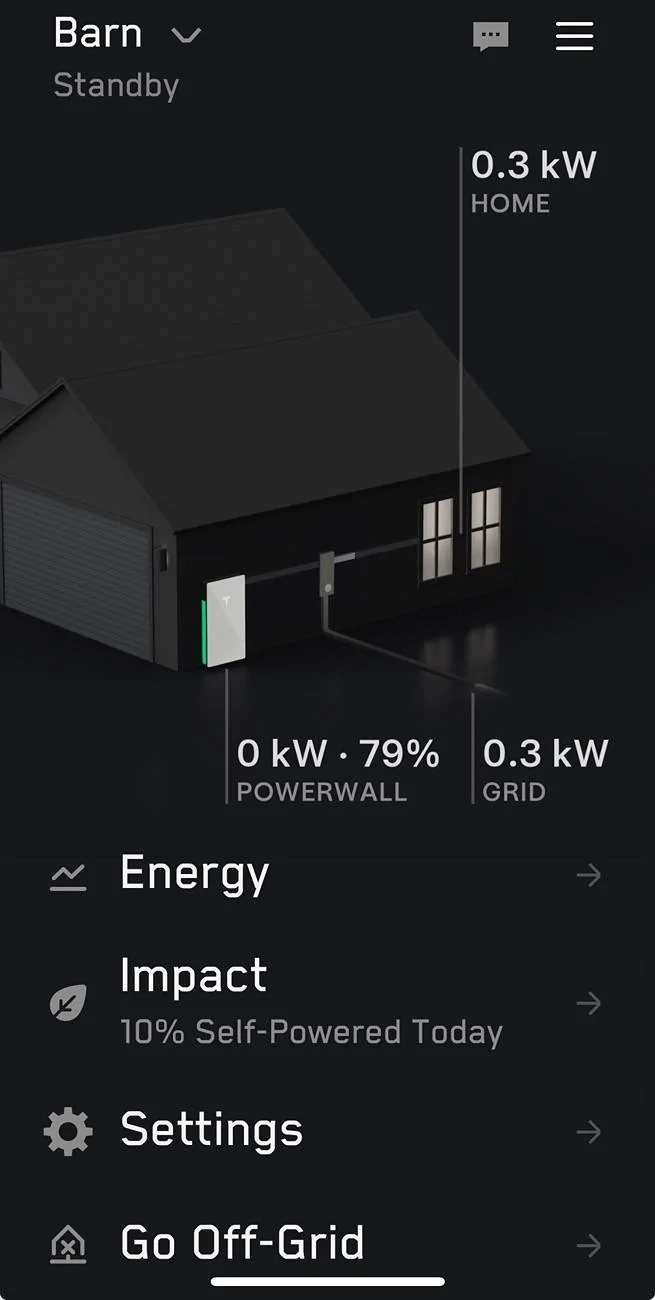

I had my universal wall connector, gateway 3 and Powerwall 3 installed last week. No solar yet.
the issue is you end up with 2 new “homes” in the app, one for PowerShare and one for Powerwall. Powerwall overrides PowerShare currently
That doesn't sound right. Is your wall connector not listed in the Powerwall "home"? You don't have two Gateways nor a Gateway and backup switch, right?

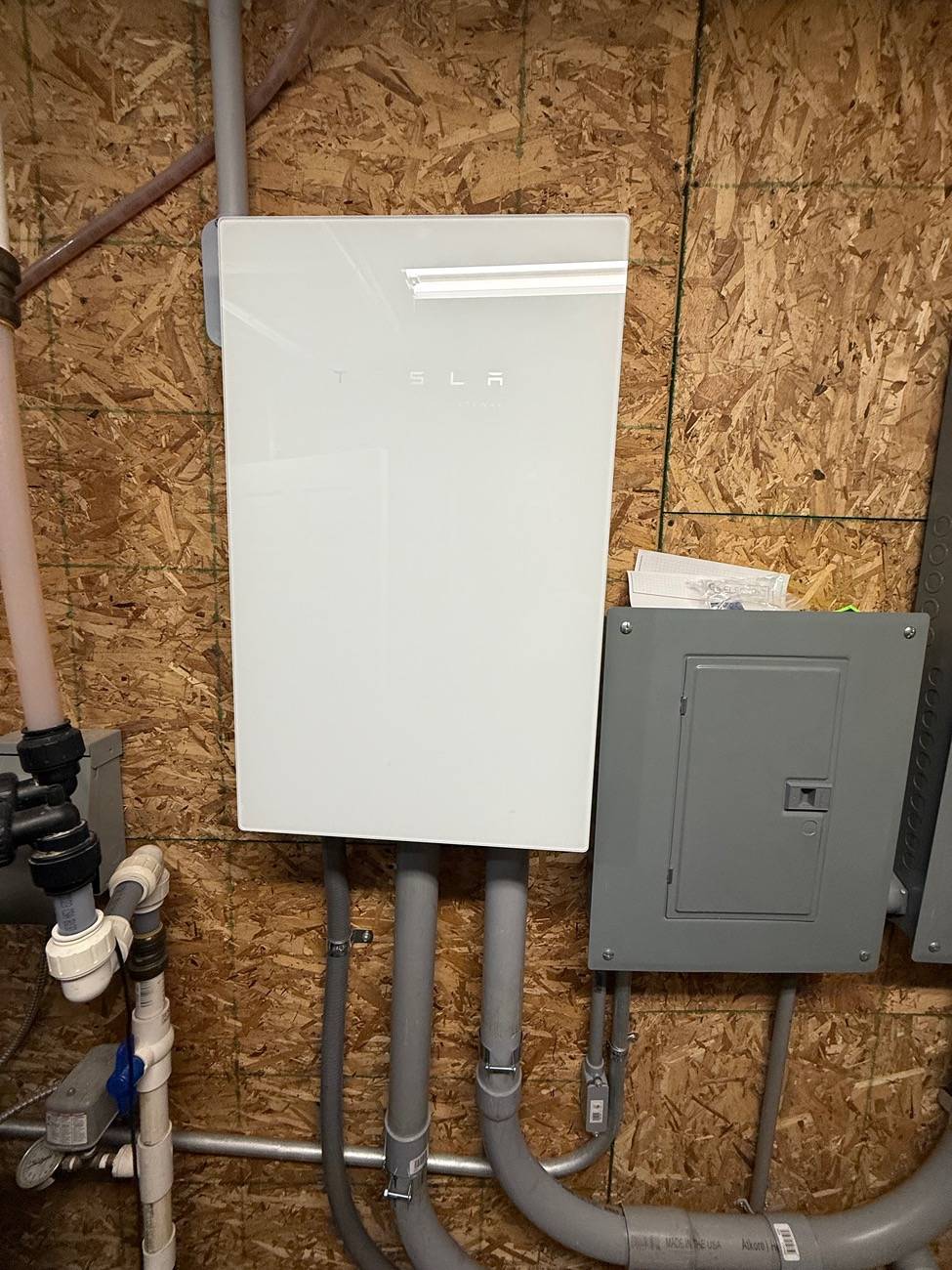

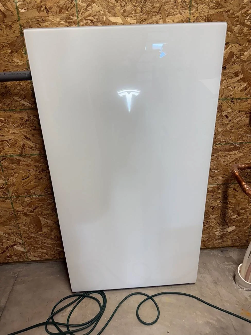

The power share has a wall connector and the power wall side does not
Are there two Gateways? Or a Gateway 3V and a backup switch?
I think the UWC should be part of the Powerwall house, not a separate location.

It’s one v3 gateway and one powerwall configured for whole house. I expect the firmware upgrade will unify them.

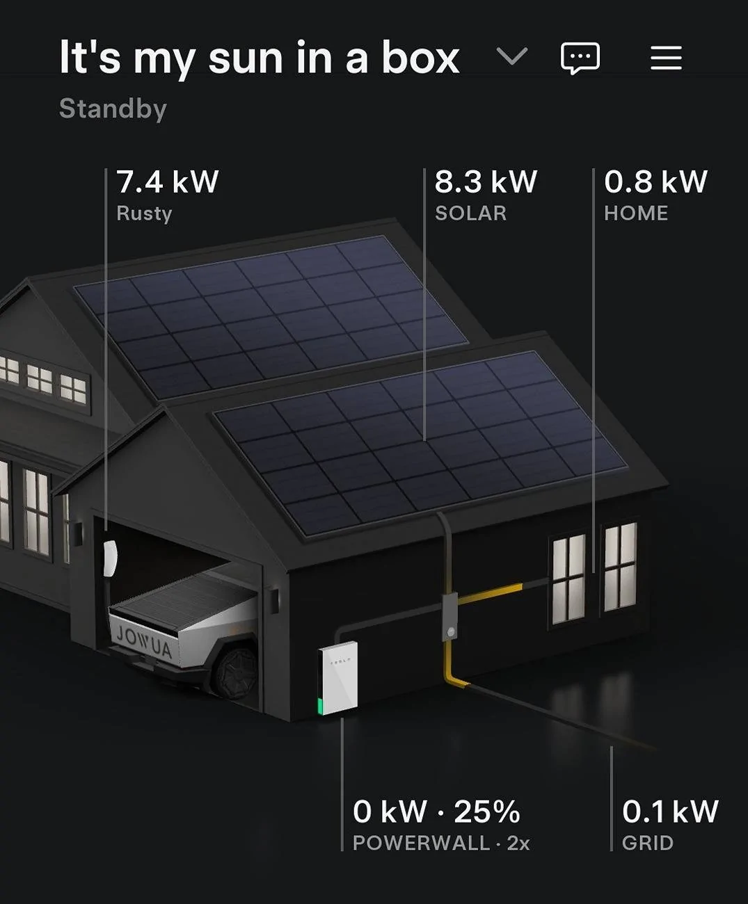

DirtyTesla's setup:
