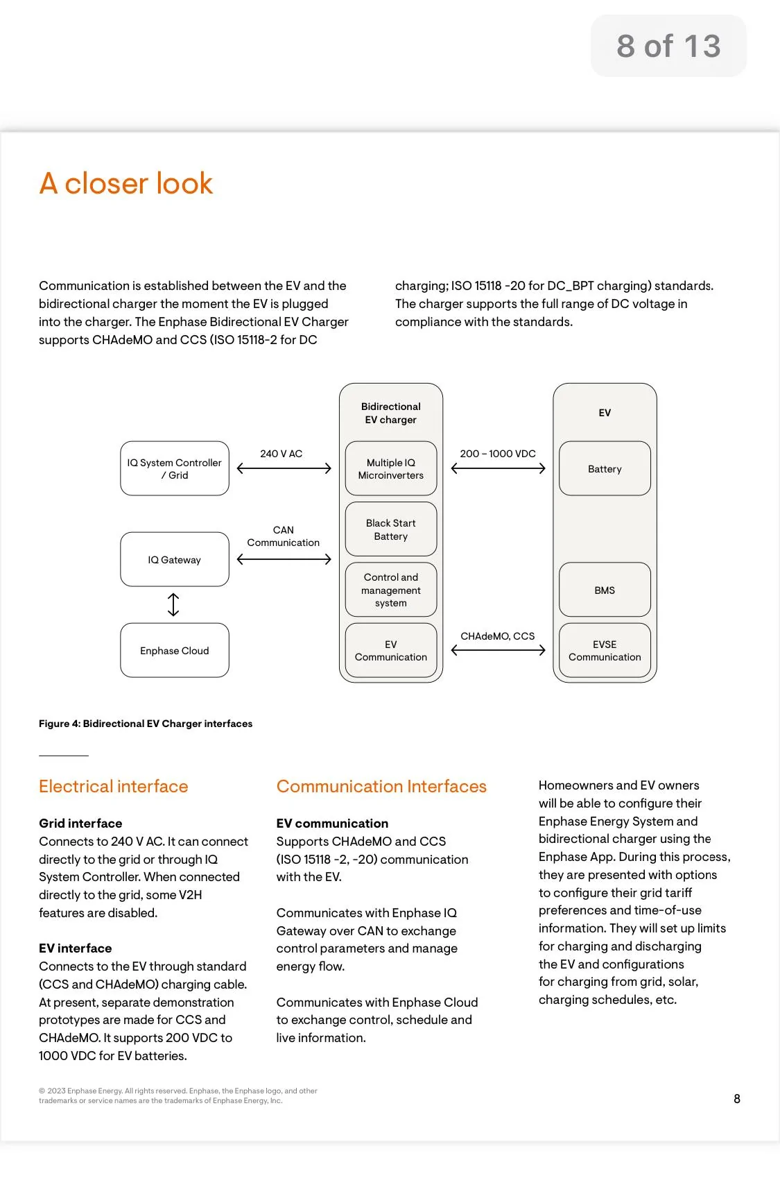

I have been looking at adding additional solar panels to my house with the PowerWall battery storage. The PowerWalls are not cheap. As I have a long range Model 3 and will buy the CT when my RN11274… comes up, I explored what electrical equipment is needed to automatically switch the Tesla for a V2H use. - Enphase is coming out with a devise for this purpose
Tesla Cybertruck Powershare V2V / V2H / V2L / V2X is a feature! IMG_3405
see link for entire brochure on Enphase bidirectional charging equip: https://enphase.com/ev-chargers/bidirectional
Ford also has their similar equipment for sale on their web page for the Lightning.
I don’t drive that much so using one of the Teslas as a battery to supply the house at night once the solar has charged the cars during the day for me is a great option. Just have to make sure the Enphase or Ford equipment is robust enough to handle daily use. Hopefully Tesla will come out with a similar equipment or may already have it. Just not yet detailed.

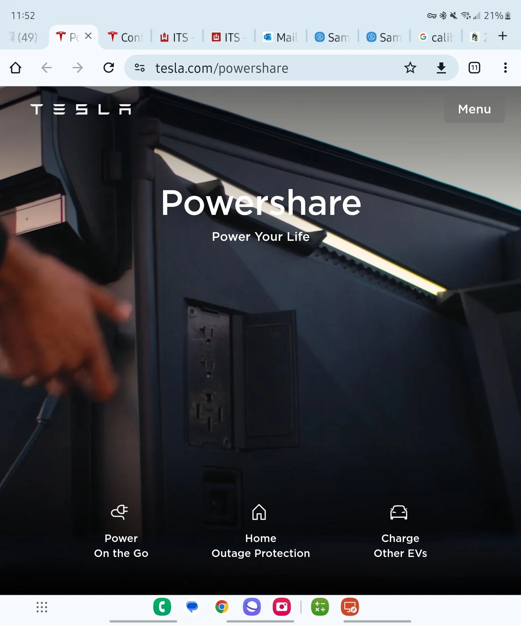

Gots screenshot of them ports's
Tesla Cybertruck Powershare V2V / V2H / V2L / V2X is a feature! Screenshot_20231130_235256_Chrom
