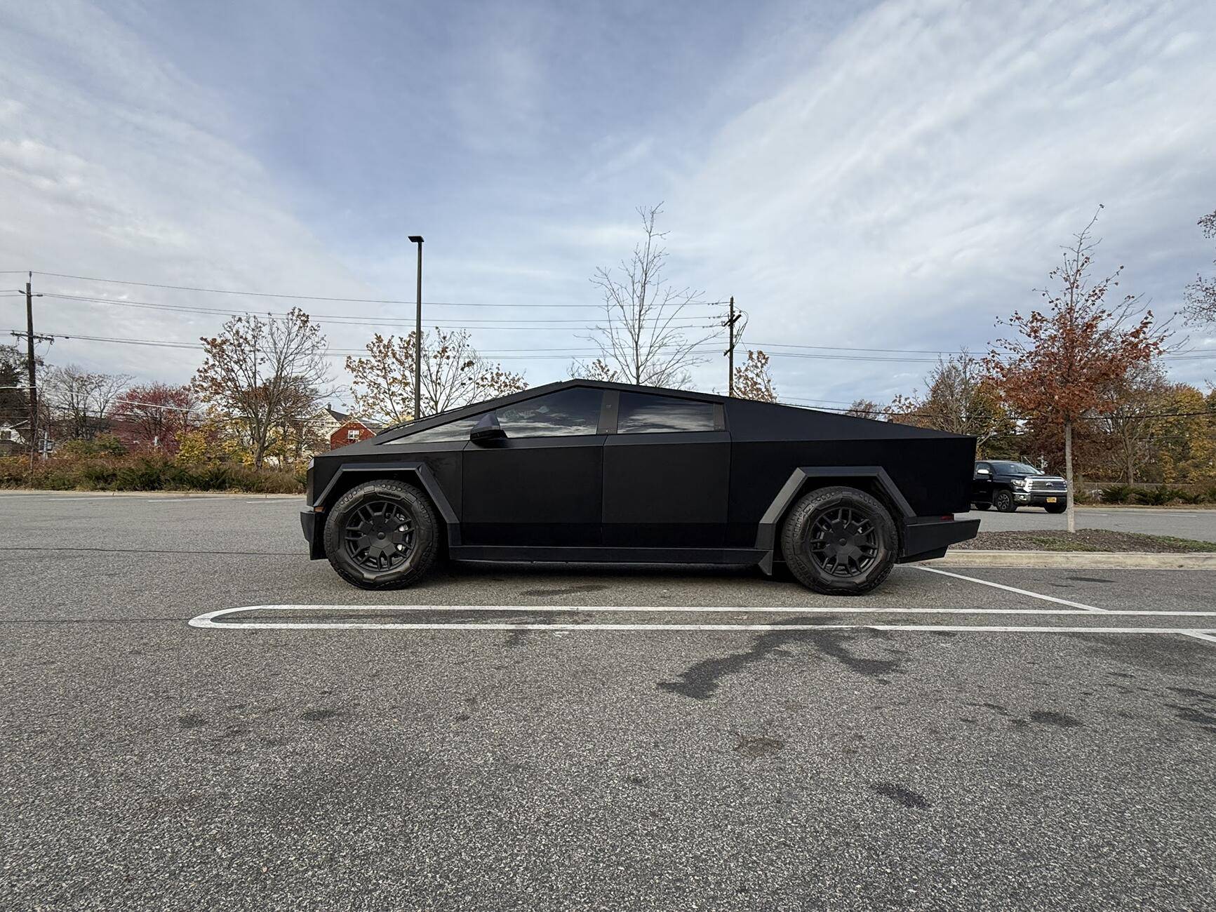

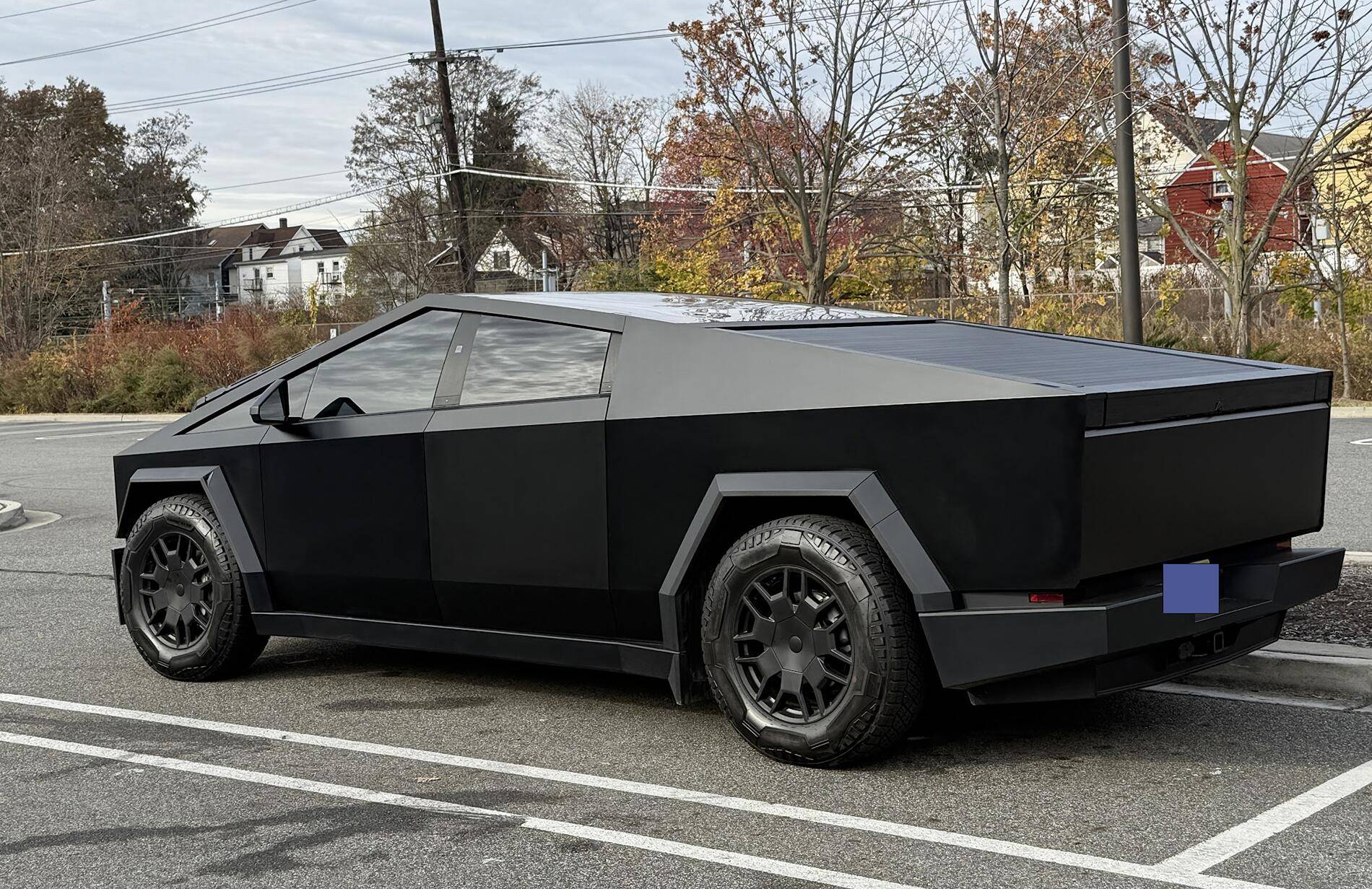

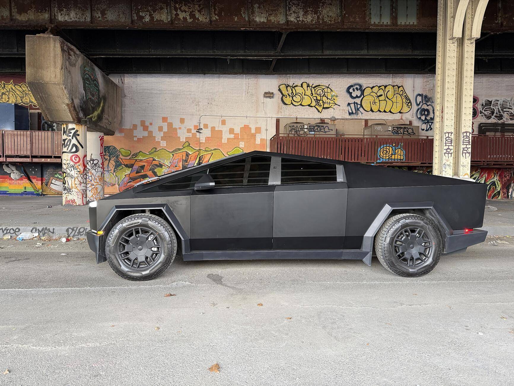

Just wondering if anyone has deep PPF experience (especially all the installers here). I had STEK Satin Black PPF installed. I took it back to the installer when I saw a bubble on the rear drive side door. He was totally good with redoing just that door. When he was done, I noticed the difference in color. I pointed it out and he said that once it cures, the color will be the same as rest of the car and that he used the same roll of PPF he used the first time. Just wanted to verify that's the case since it's been a couple of weeks. It's been cold out so I know PPF cures better in warm weather but will the color just blend back in the way it used to? Another note is that Gyeon ceramic coating was applied originally which he said he did again with the new PPF portion. Not sure if there would be any effect on the difference in color with that as well.
Lastly, I guess it depends on lighting and angle but I've seen both on my car and others that sometimes that different panels can appear as if the color is different with or without PPF applied so maybe that exacerbates the color appearance?
Before: PPF was redone:
Seemed pretty uniform in color.
After PPF was redone:
A slight difference in color. Hoping it just needs to cure.
Here, you can see the front panel also looks slightly different in color so maybe it just depends on lighting and angle?

Curing is false. There is no such a thing as colored ppf changing colors after a curing phase. Unfortunately that is an excuse.
The problem is he did not use the same STEK product to replace your door. Most likely because STEK has been out of stock on dynomatte black for over 3 months now. I recommend you contact stek directly & they would be happy to warranty the installers work if he's truly authorized by them. Or, contact the shop back and let them know it needs to be redone in the right product.
Yep this. Stek Dyno Matte black is backordered. Looks like a different brand.

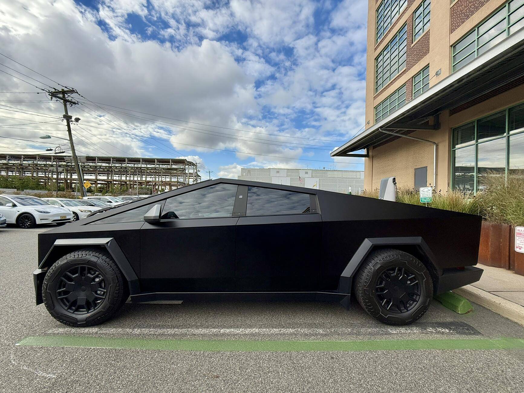

He wound up ordering from Stek and this time I saw the actual roll from Stek. He reinstalled the entire car PPF so he did right by me. He also mentioned that they mentioned that this run of this Dynomatte black film was ending but they can always make more if necessary. He seems to be reputable and want to fix things.
