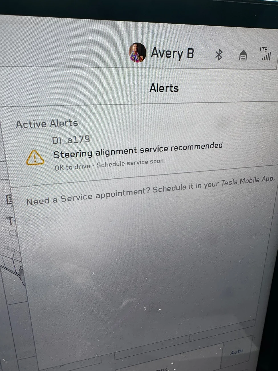

I had alignment warning pop up at 6,500 miles and it’s one of the few things Tesla has charged me for. Had an alignment done two weeks ago. I also have unusual tire wear. Truck was delivered 1 AUG 2024 and I have just under 7,000 miles.
