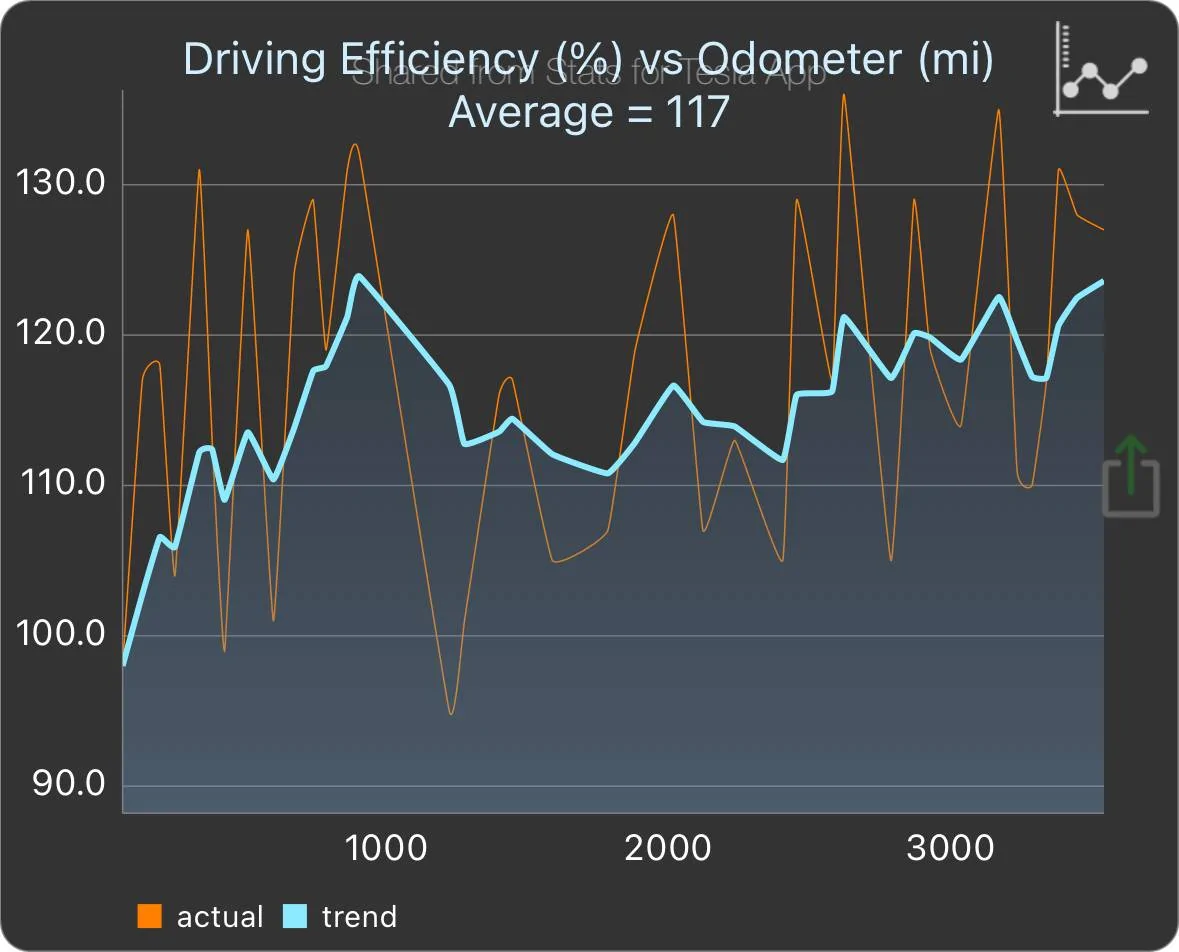

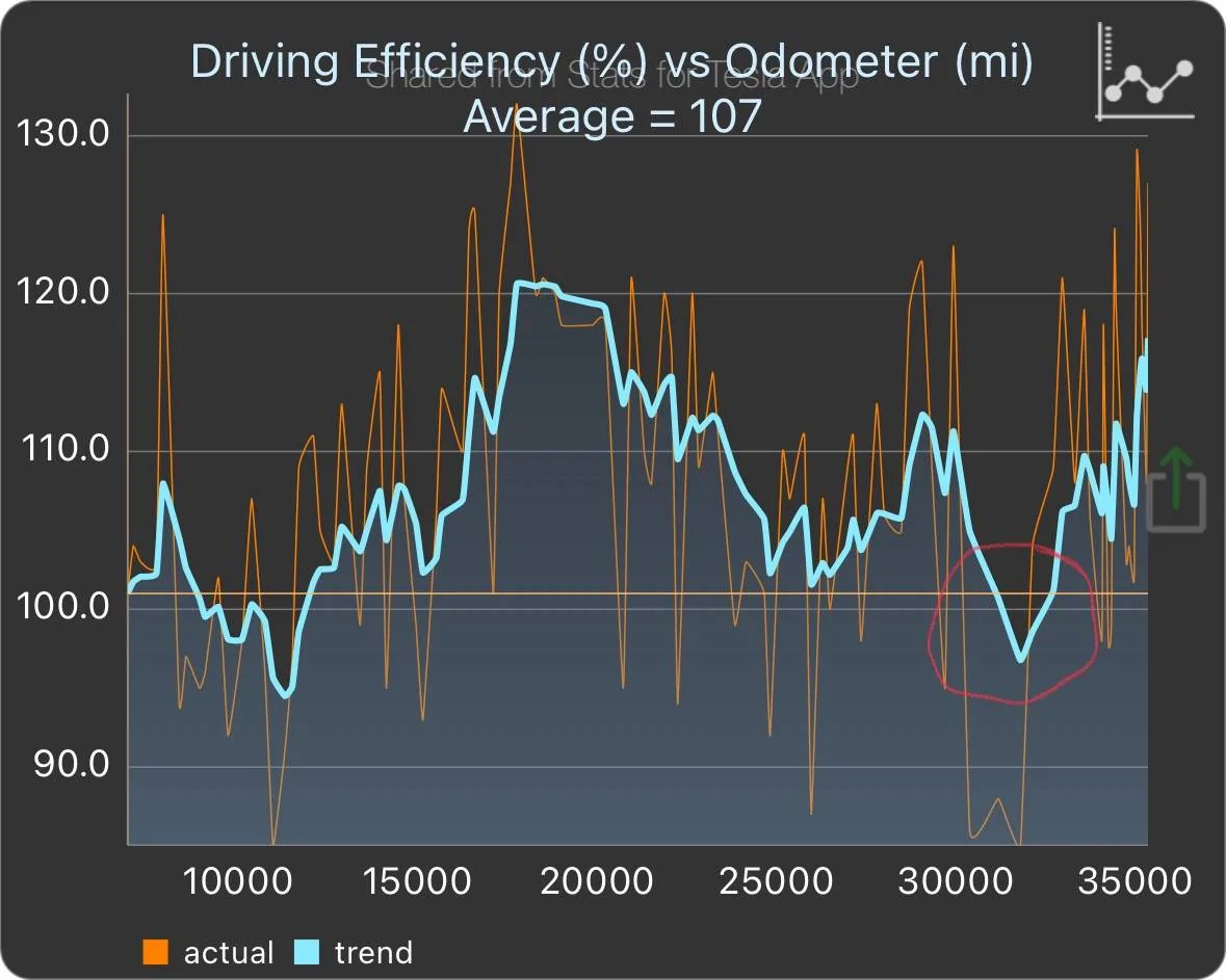

Data point one is a Long Range, AWD, Model 3. Two and a half years old. 35,000 miles.
Tesla Cybertruck Range, Efficiency, and the Joker in the Deck White_Lightning-IMG_3096_edit
Tesla Cybertruck Range, Efficiency, and the Joker in the Deck White_Lightning-IMG_64AFFEFF1084-1_edit
Here in the mid-Atlantic we’re shortly heading into cold weather. So that Efficiency graph will soon be trending back down. Somewhere close to, or maybe a little bit below, that EPA bogey.
The dip at ~12K miles was the first winter. The dip at ~25K was the second winter.
The dip at ~32K miles, circled in red, was a quick, high-speed road trip – 2,000 miles in three days – to southern Florida to attend the funeral of an old friend.
The conclusion is quick and obvious: he must drive like the proverbial grandma.
Maybe. I’ll leave it to others to judge how fast or slow, how well or poorly, that Model 3 got driven. But I knew as far ago as last winter, when the first production Cybertrucks were finally being delivered to normal people, and we started getting the first reports of mileage and range, how it would go.

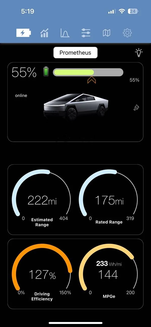

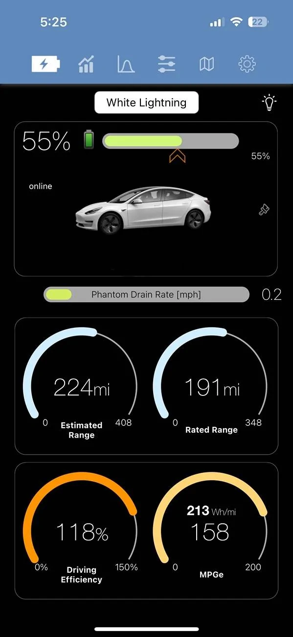

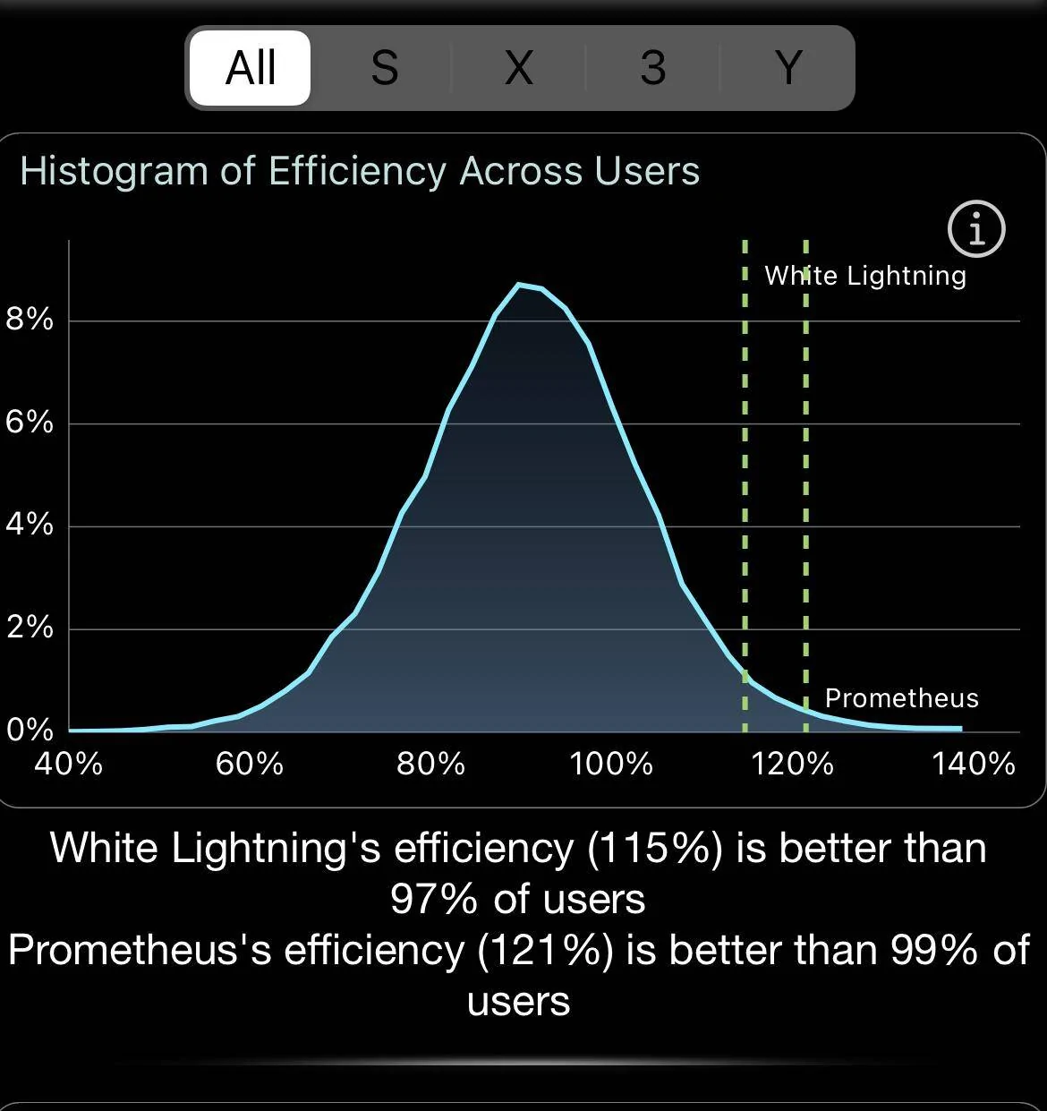

Tesla Cybertruck Range, Efficiency, and the Joker in the Deck IMG_3095_edit
Tesla Cybertruck Range, Efficiency, and the Joker in the Deck IMG_04FE5B1EFAA3-1
Tesla Cybertruck Range, Efficiency, and the Joker in the Deck IMG_3094_edit

Those who paid attention in Statistics class will instantly recognize the flaw. All of two – count ‘em, two - data points. Your professor would laugh at you.
But hold that thought. Because it’s plenty.
Spend enough time in the EV world and you quickly find that one thing keeps circling back, time and again, like a deranged boomerang. It’ll come from a bunch of different angles, but ultimately boils down to one thing: how far can I drive before the electrons exhaust themselves, leaving me on the side of the road?
There’s the EPA benchmark, of course, a suite of road tests intended to objectify the matter.
Alas, few drivers hit that bogey. Leading to a legion of complaints as to why not. Everything under the sun gets pointed at, starting with Elon lied to us, and heading south from there.
There was a post here a few weeks ago from a fellow who wondered about maximizing range. After that thread had mostly run its course, the fellow rejoined his own summary of it all… “we will try all season tires, chill, low, comfort, aero caps and see how it goes.”
He remained happily oblivious to the one thing that mattered more than all the rest.

The Trip Card is very handy. I set mine to display Current Drive, Since Last Charge, and Lifetime watt-hour/mile consumption. A quick glance at Current Drive will let you know what kind of efficiency and range you are currently laying on the road.
But by far the most powerful tool that Tesla gives us for monitoring energy consumption is the aptly named Energy app. I’d recommend that anyone interested in efficiency and range permanently tag that app to the dock on their display, and become intimately familiar with it. You want to be seeing lots of green.
The downside with both those apps is that they are past tense. They give very accurate insight into energy consumption. But they are both looking in the rear-view mirror. Neither tells us what our consumption is right this moment. Until Tesla decides to gives us that data – it’s already collected by the vehicle, it simply isn’t displayed - or until Scan My Tesla or a similar tool shows up, these two apps are the best we’ve got.

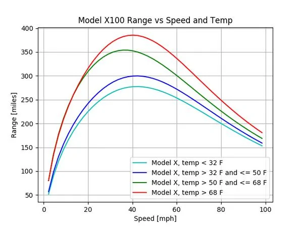

Lol just drive 40 instead of 80 and you will double your range.
