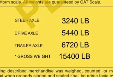

Ah, full tanks, I also forgot to account for the increased trailer weight due to the WD hitch being loaded. We're running a Continuum hitch to make charging stops disconnects easier. Agree that the WD counteract the torque that limits pin to ball weight.
Truck
Tesla Cybertruck Range Extender Class Action Claim AISelect_20251226_120718_Adobe Acrobat
Trailer with WD unloaded
Tesla Cybertruck Range Extender Class Action Claim AISelect_20251226_120550_Gallery
Trailer with WD
Tesla Cybertruck Range Extender Class Action Claim AISelect_20251217_130759_Gallery
I'm looking into an roof rack/ aero fairing to try to reduce the range hit with our travel trailer. Also considering questionable techniques like dropping the trailer halfway to go get a fresh charge...
