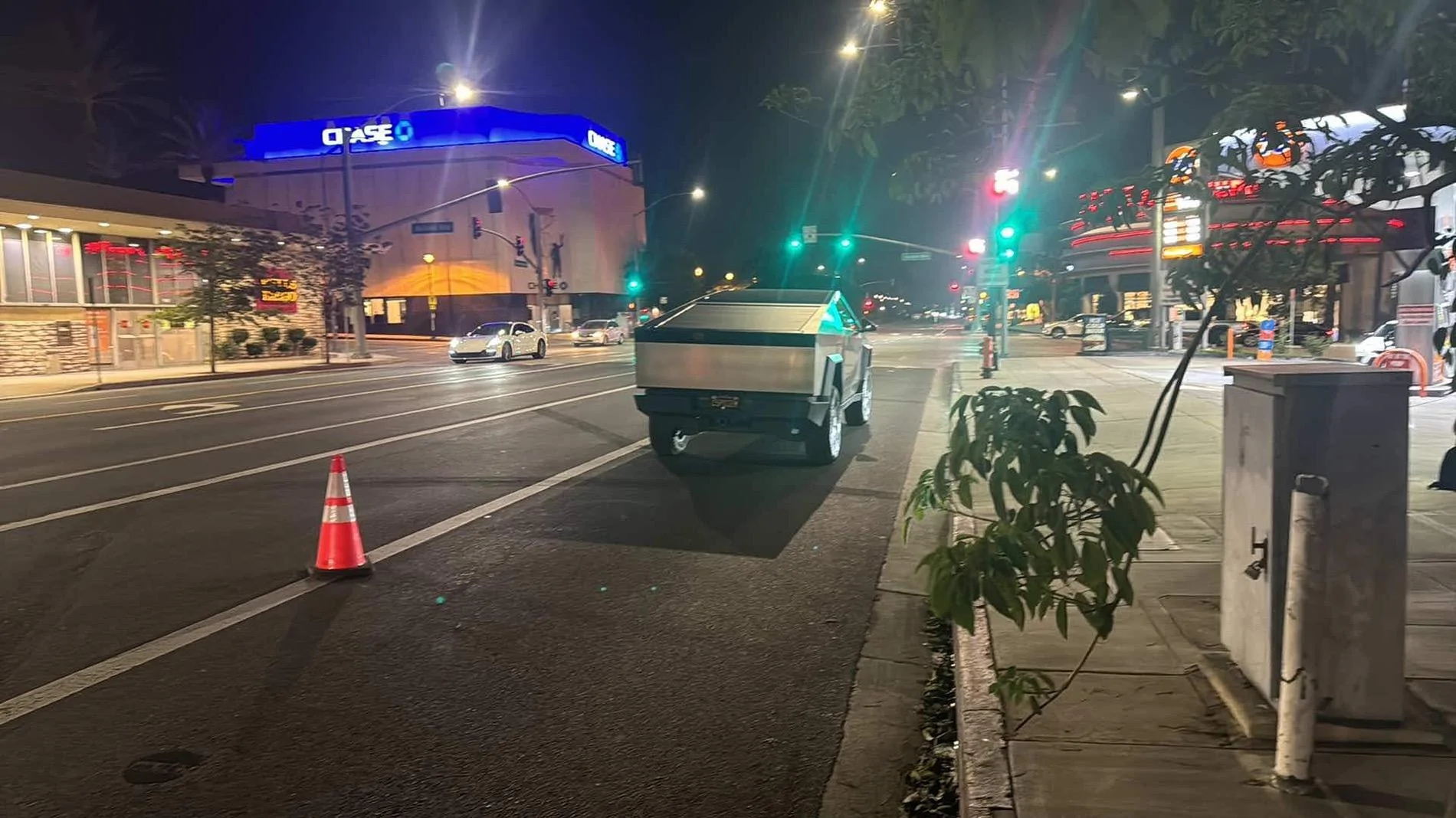

Happen to me last night in LA (I live in NorCal.) Nightmare situation. Tow truck dropped it off at Burbank and crickets from Tesla so far. Supposed to be camping this week in Mojave using the Cybertent. Slept in the rental car last night. Picked up 1 Feb, VIN 648

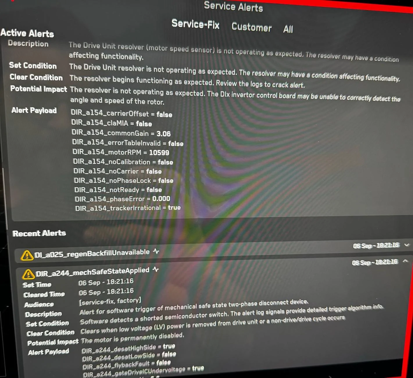

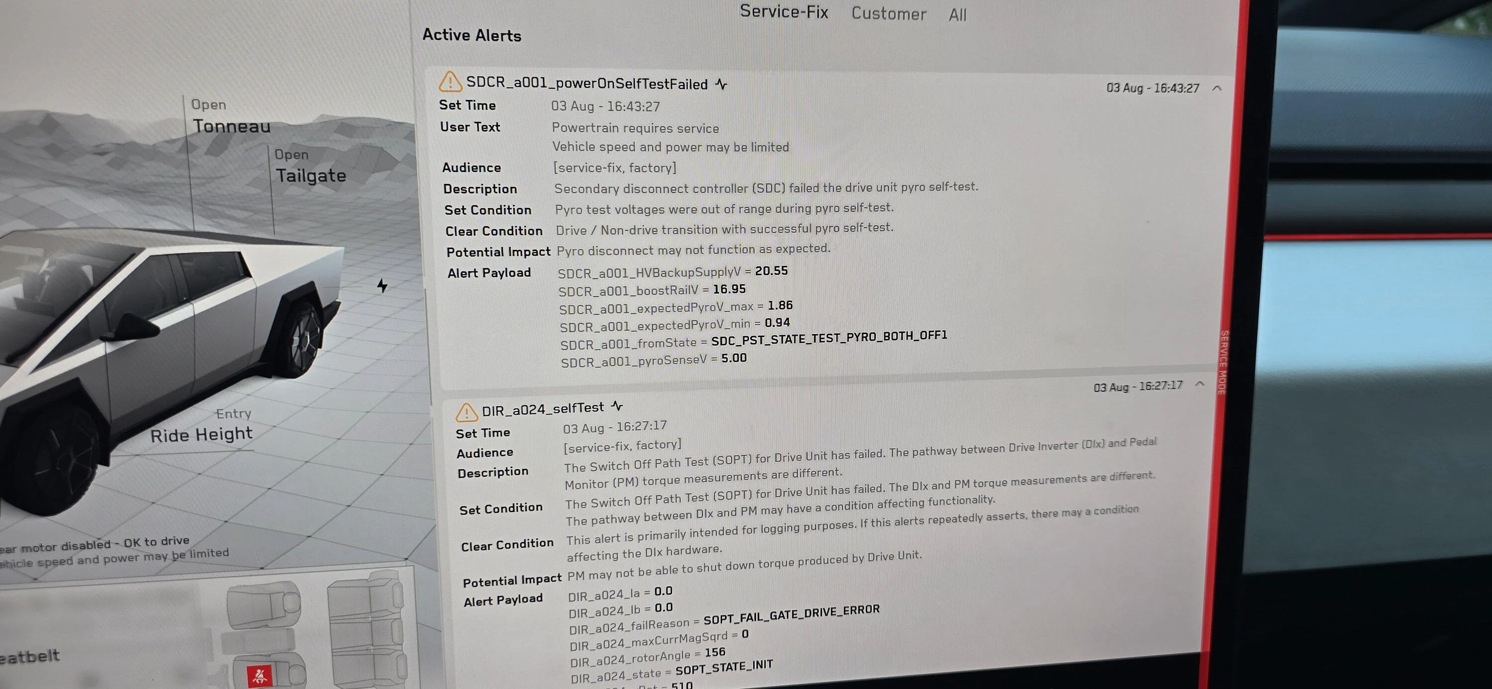

Just want to add to the list. Dual Motor 28xx picked up mid march. Was driving it about 20 minutes ago, I heard a pop from the rear of the truck then it jerked forward a bit then entered limp mode. Truck states rear motor disabled. On 26.11. Also my cellular took a dump with all this. Have attached service alerts
Tesla Cybertruck Rear motor disabled - AWD IMG_3982

Rear but it wouldn’t move. It said it might reset if I exit the vehicle, so I did. Then it shut down and locked me out. I sat on the curb for 4 hours waiting for the tow truck while pissing off the entire city of Burbank in rush hour. I tried resetting it a few times and putting it in off-road mode to try to get it out of the street. Didn’t help.

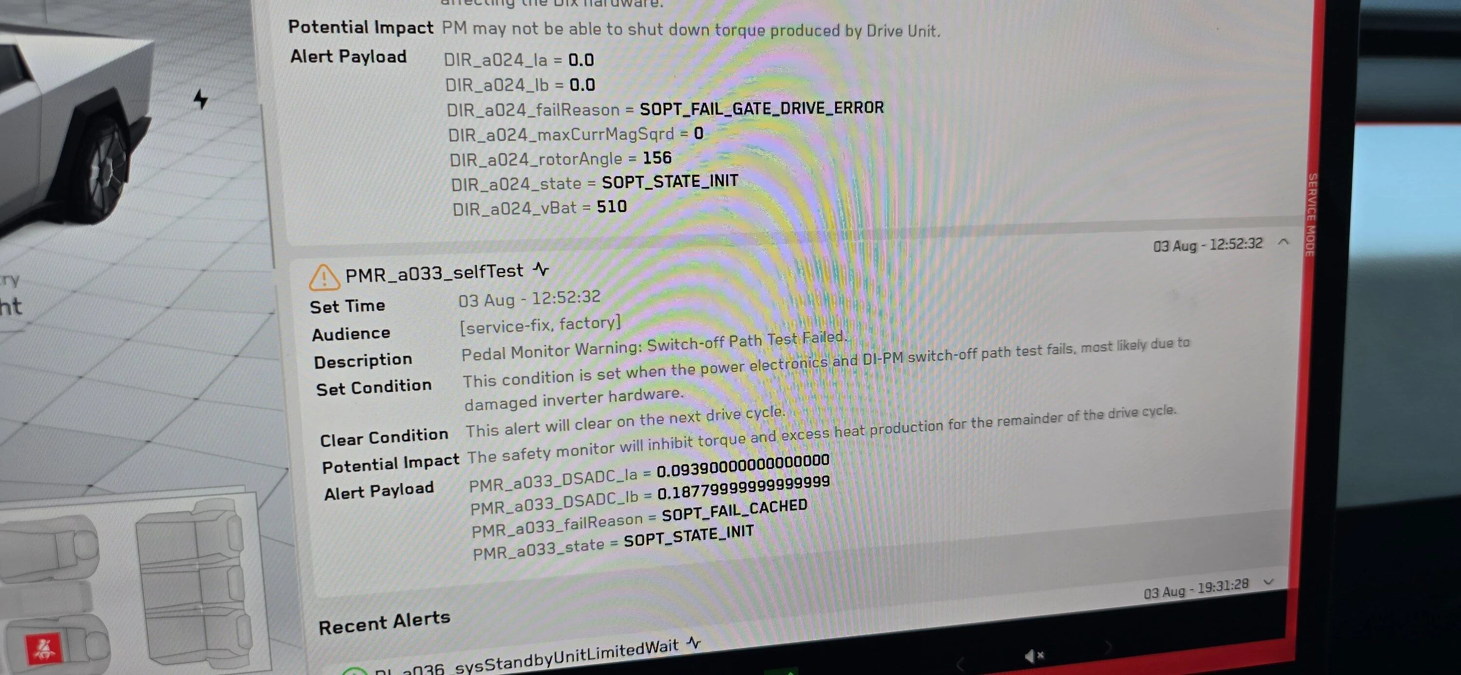

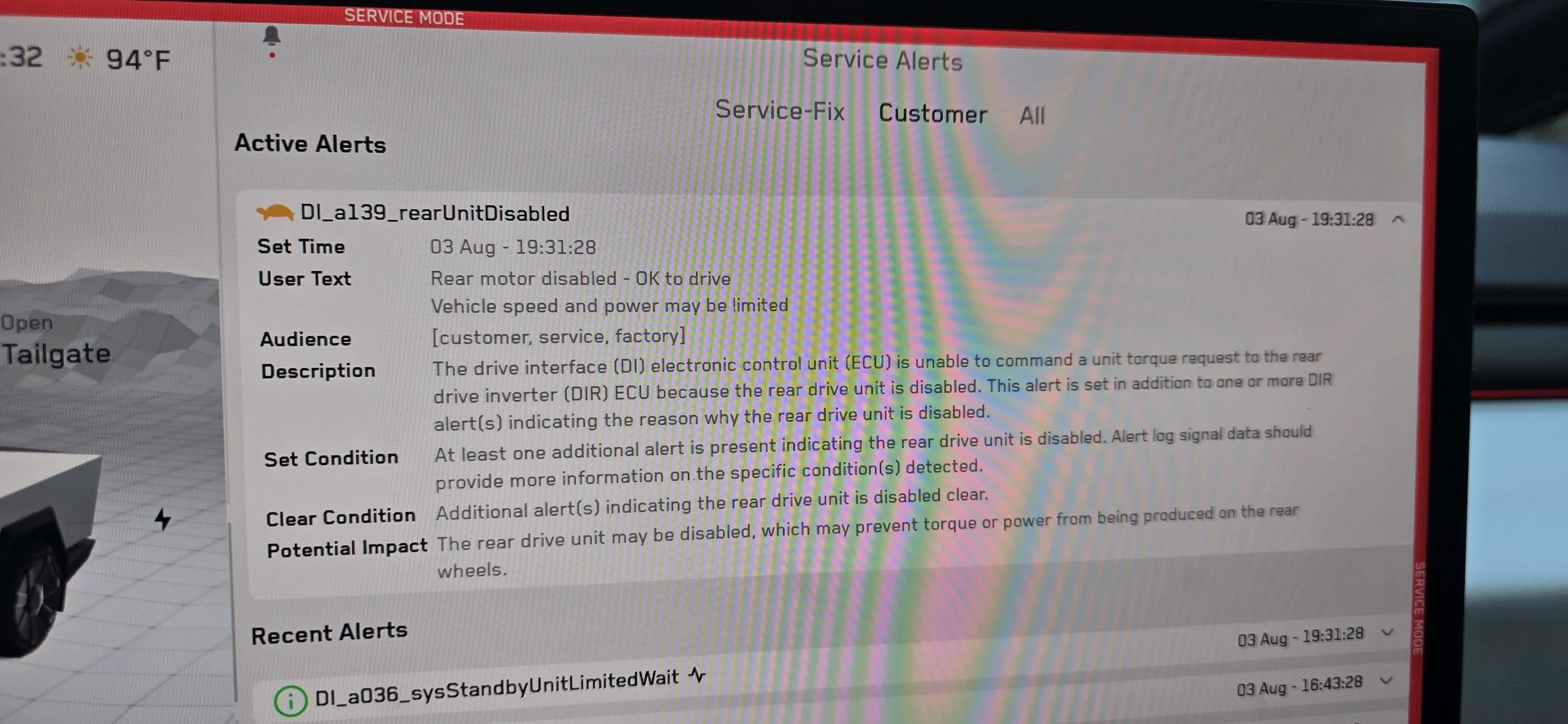

Got my truck back from service. Did a walk-in. Customer service representative handled it the best way she could. Tough job. Took care of the major fault immediately and handle the rest of the issues/recalls at the scheduled service appointment two weeks out. Technician pulled the logs and found that a desaturation occurred at the rear drive inverter. Replaced and tested component. Quick turn around. About 1 business day and resolved at eleven o’clock at night. Thanks team.
