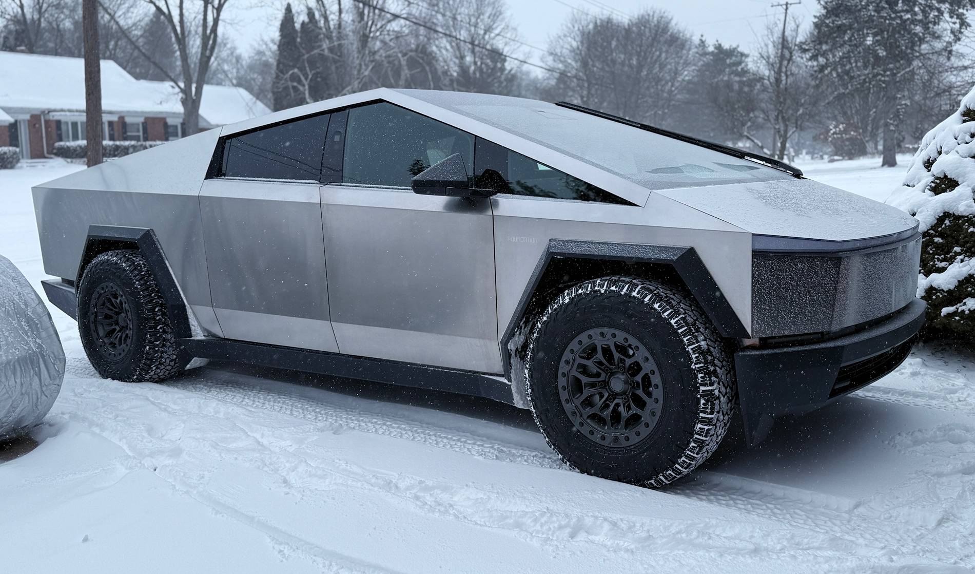

I’d caution you on running those wheel covers with aftermarket tires. Even if, at rest, the covers aren’t contacting the sidewall, they’ll definitely dig into them when cornering.
You should probably just get center caps if you aren’t buying the special-sauce Tesla/Goodyear tires.
