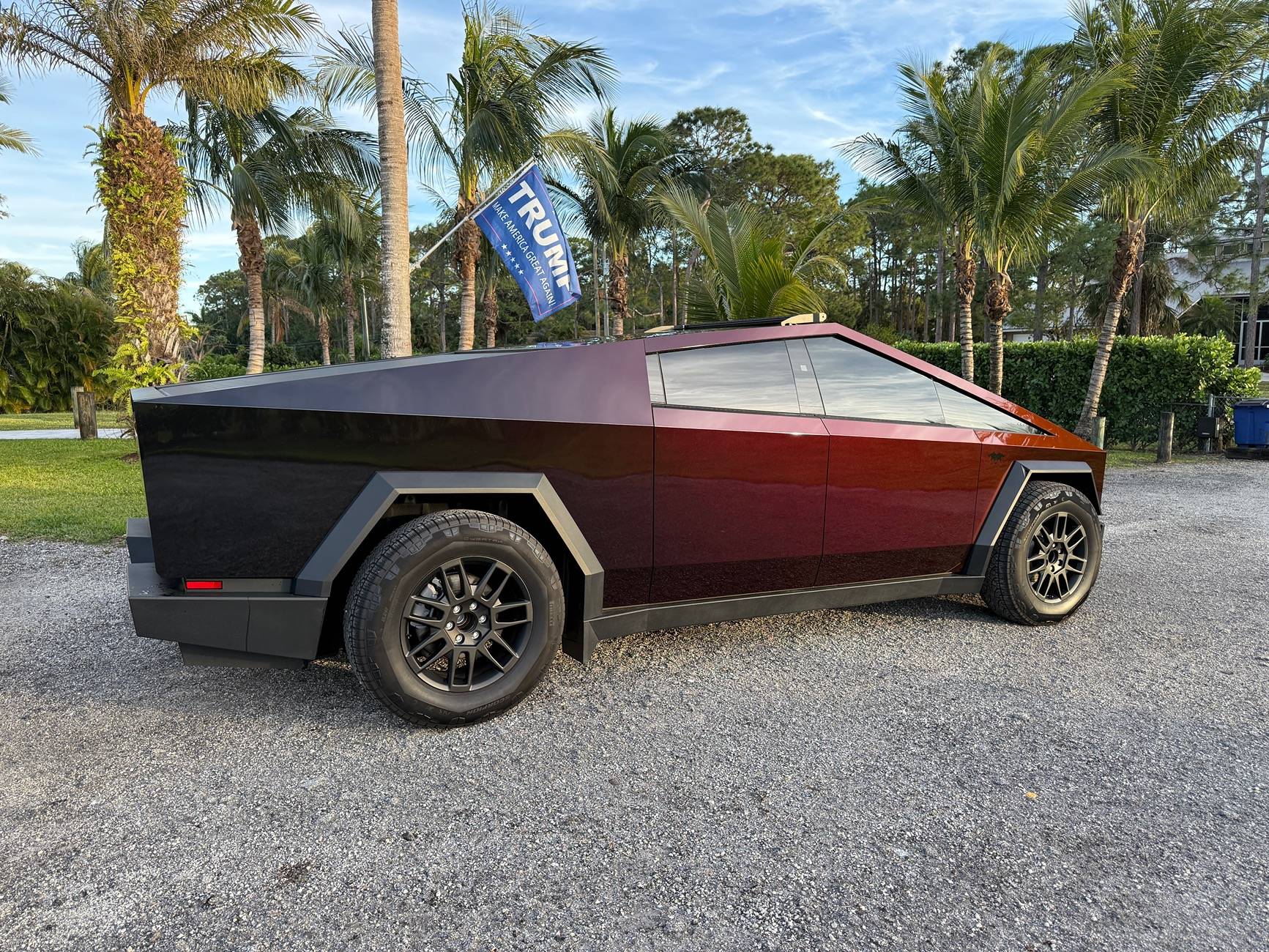

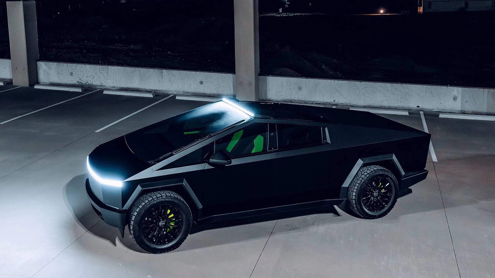

That's still painful. I just spent that on a wrap and now looking at the rims and i'm like, yep, they're good enough. LOL

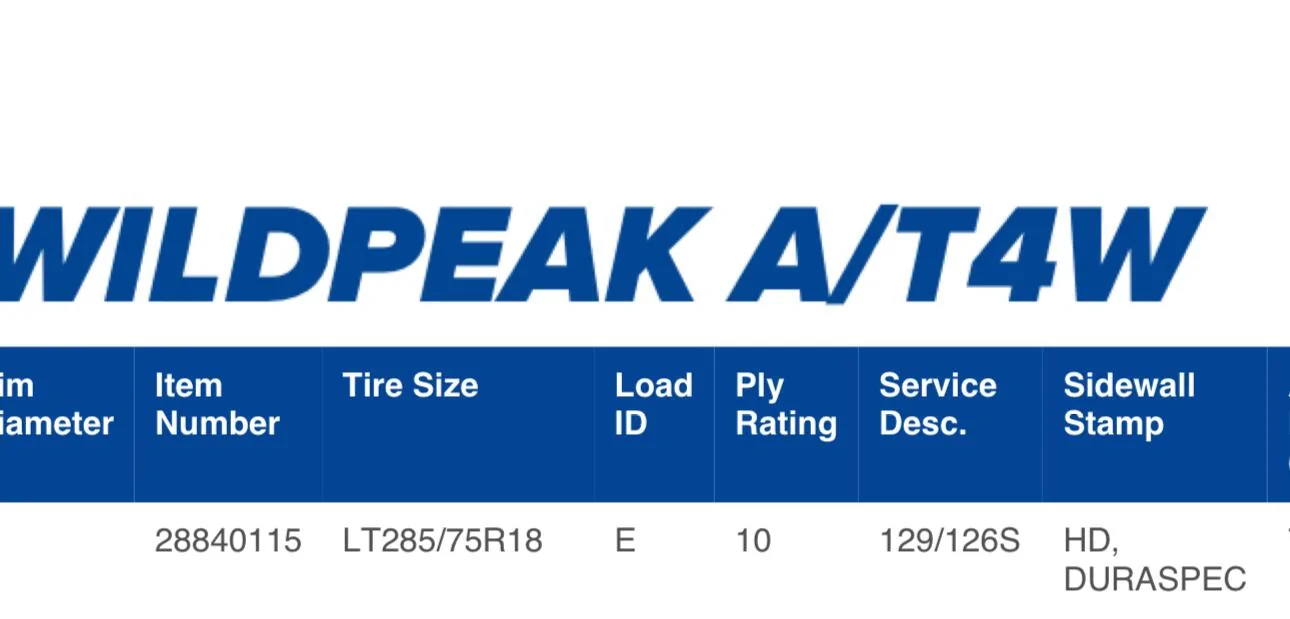

So the rubbing isn’t bad enough to need to change anything? Are your tires 12.5” wide? With 0 offset, how many inches does your tire poke extend past your fender?
Doesn’t rub at all in low or mid height which are really the only heights you can drive it in on the roads. And in high it only rubs fully turned in reverse.
I’ll get the exact tire size. But yeah it’s like 12.5 ish
285/75r18
35” x 11.6” basically.

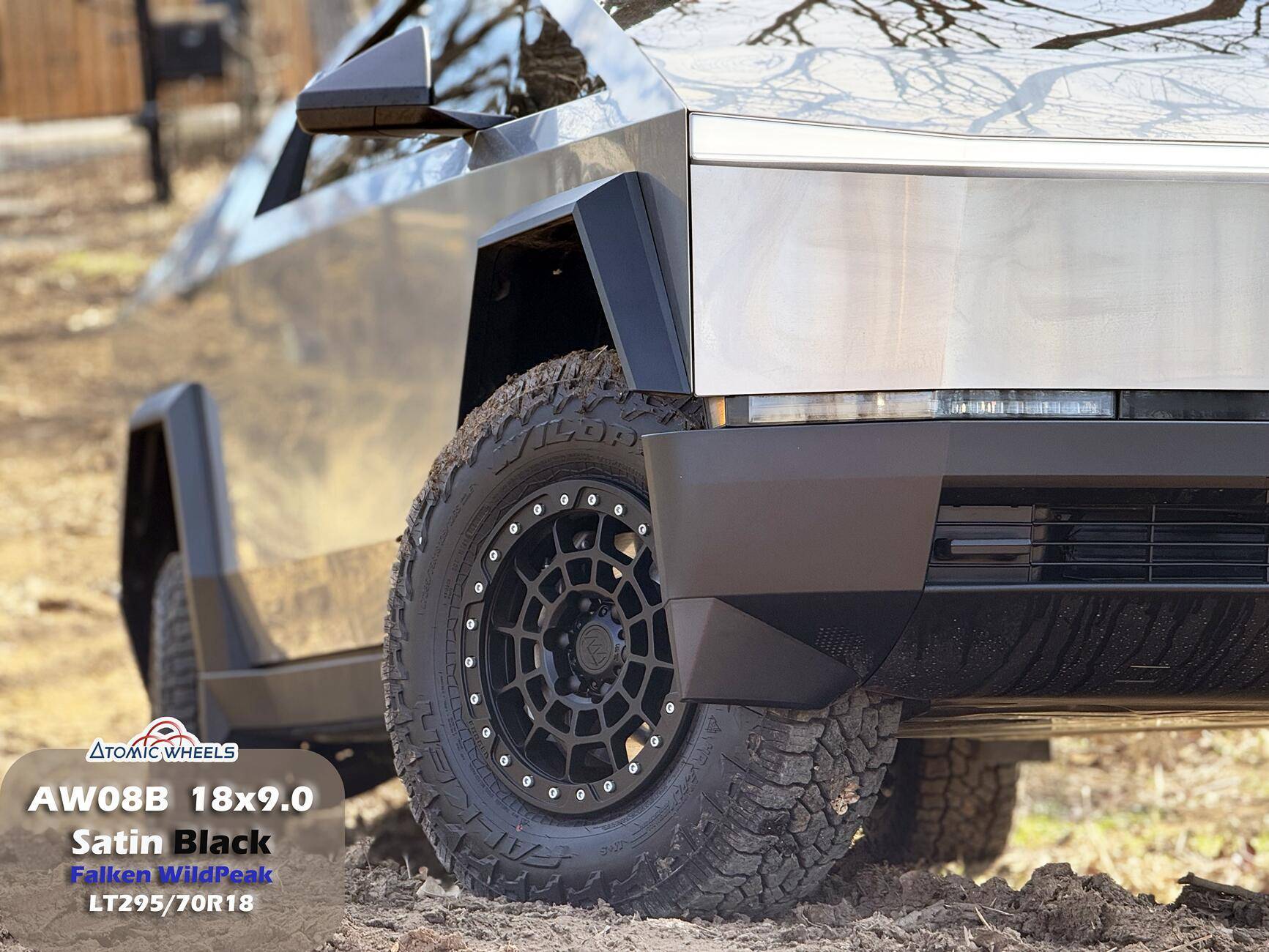

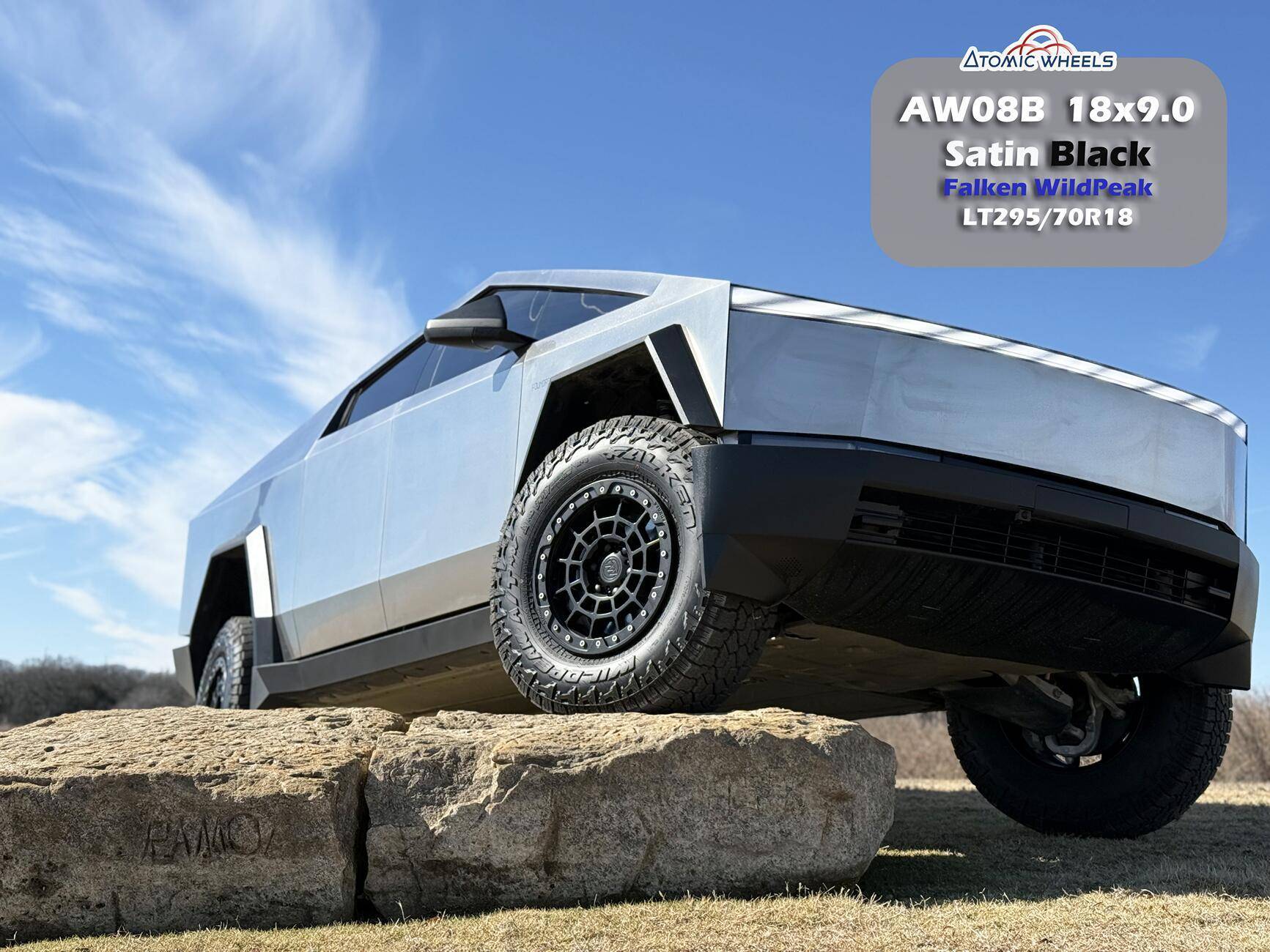

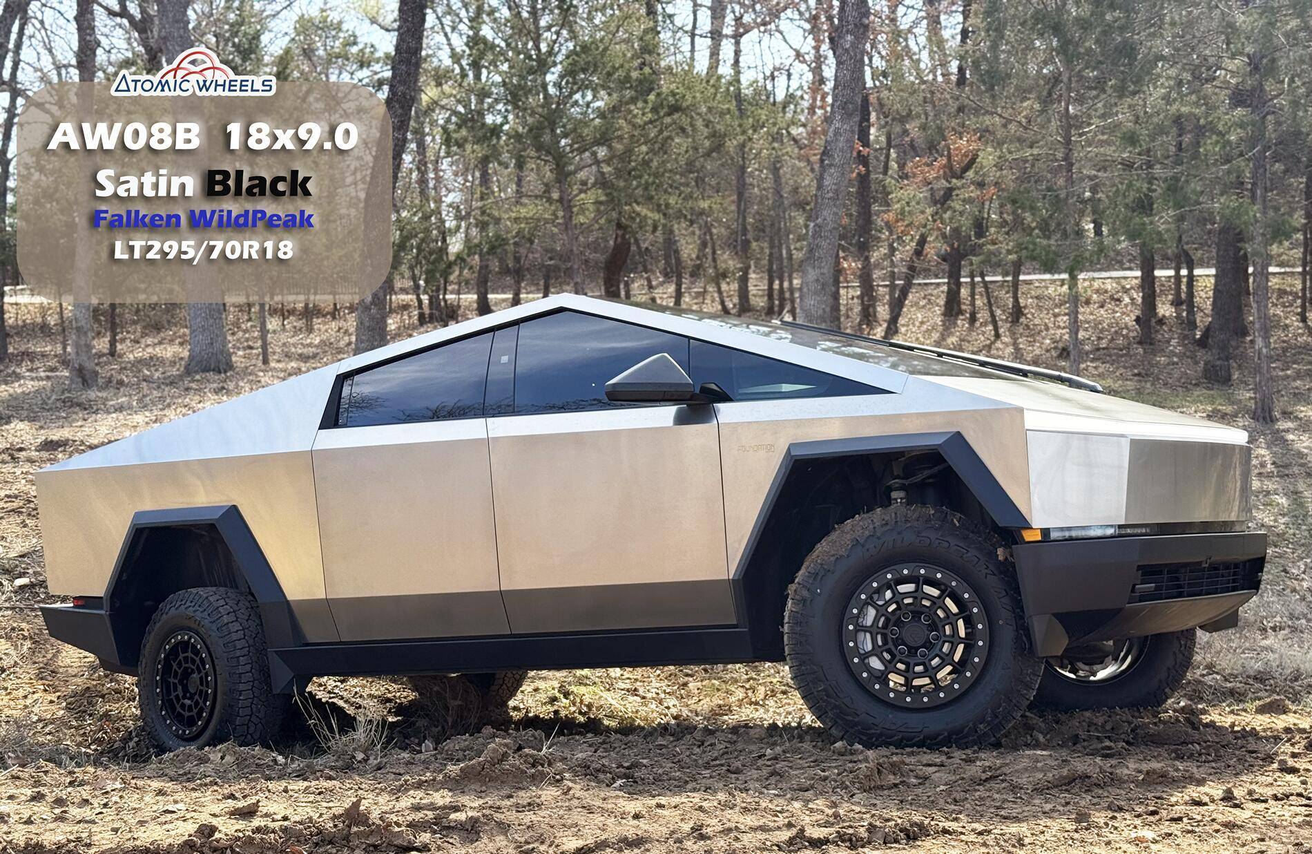

When we launched our designs for the Cybertruck, some asked if we would release a model in 18". Well, the day has arrived: today, we introduce the AW08B in action—a unique design featuring its beadlock system!
Tesla Cybertruck Cybertruck Aftermarket Wheels & Tires Photos + Info Compilation aw08b18_cybertruck_satinblack_stamp-
Tesla Cybertruck Cybertruck Aftermarket Wheels & Tires Photos + Info Compilation aw08b18_cybertruck_satinblack_stamp1-
Tesla Cybertruck Cybertruck Aftermarket Wheels & Tires Photos + Info Compilation aw08b18_cybertruck_satinblack_stamp2-
For those who seek another design, color, or specifications, we offer the option to place a custom order.
Discover our custom-made Fully Forged Wheels, a world-class product that offers exceptional quality without breaking the bank.
