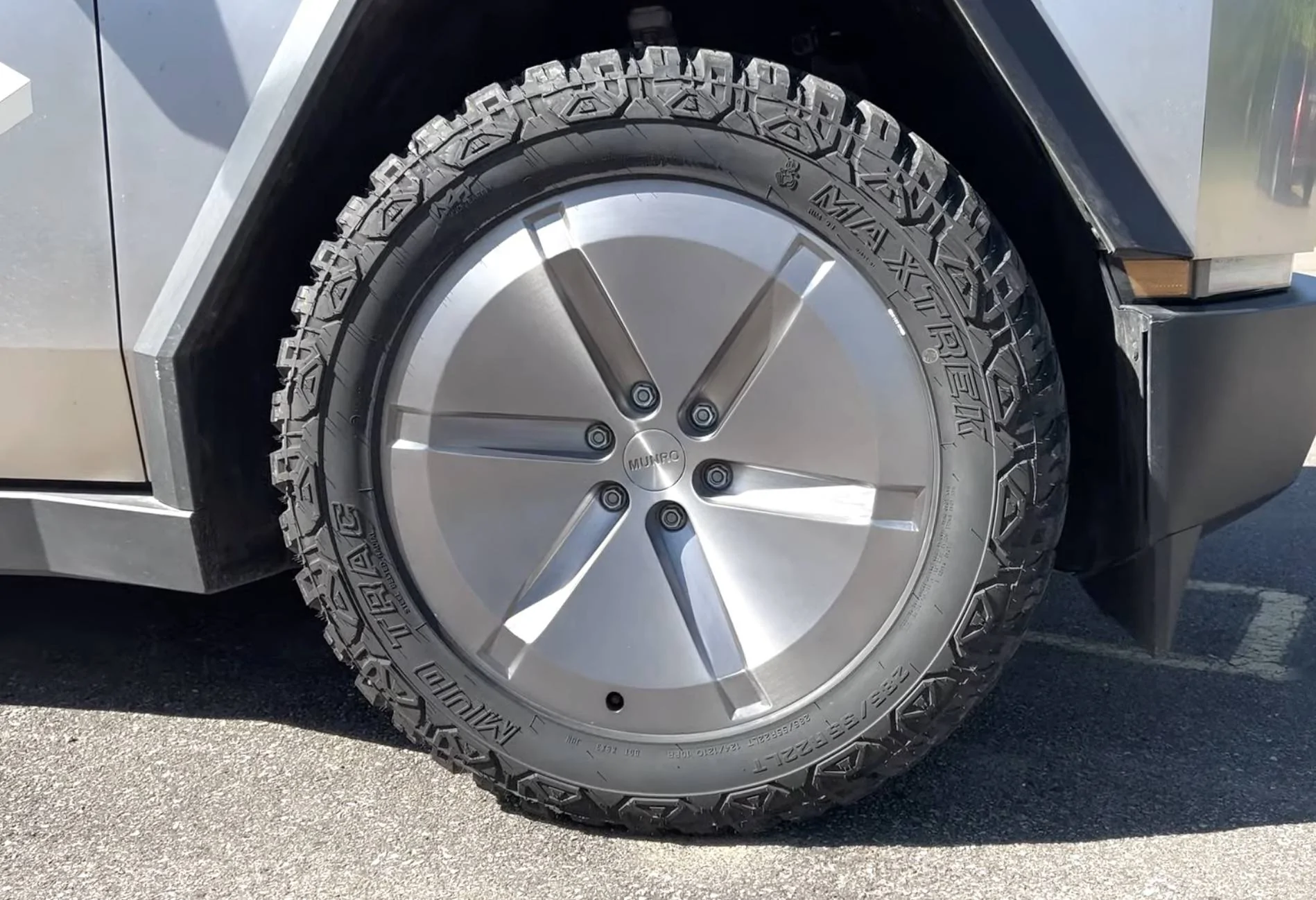

So to clarify, my question about people’s thoughts was not really an invitation to challenge why i would care about brakes and i’m not here to bash the CT… far from it.
My question is about brake venting with wheels like this. Let’s say its the middle of summer and you are hauling a trailer down the mountains from tahoe in heavy traffic and have to use the brakes over and over in summer heat as a result. Would wheels like this worry you?
That’s a more specififc way to ask my question. I really don’t need a lesson on Tesla one pedal driving. I’d be willing to bet I’ve been doing it since before most people on this forum had ever even heard of Tesla. So if we could stick to the point I would prefer that rather than questioning the validity of my question, and my question is about this wheel design relative to venting brakes.
I don’t really see a need to get huffy about it. Some people haul weight downhill. Some people drive faster than others, and not on straight flat roads. Some people drive where their fellow drivers aren’t so aware of the traffic around them. Brakes matter. These wheels seem like they could cause an issue with brakes to me but otherwise I quite like them. If people with some automotive design knowhow or greater knowledge of materials physics than I have actually have strong opions about this, I would like to hear them.
Thanks in advance.
Cheers
The non-vented wheels probably can't help but reduce the thermal capacity of the brakes. Wheels are a significant exit path for brake heat, but I assume the solid disc wheels probably don't radiate more than a vented wheel. The question is, how extreme the brake usage would need to be to overcome the brakes thermal capacity.
A heavy trailer shouldn't tax the brakes of the tow vehicle because heavy trailers need their own brakes and shouldn't be increasing the braking required by the tow vehicle at all. The only exception to this rule would be if you tuned (backed off) the brake controller to create more regen opportunity for the tow vehicle. And that's for experts only because it could end badly if you don't know what you're doing. The "proper" way to tune the brake controller is for the trailer to add no significant pushing force to the tow vehicle. Thus there should be no significant additional brake heat generated due to the trailer.
Personally, I would worry more about the brakes on your typical trailer than the ones on the Cybertruck (because they don't have regen helping them out).
