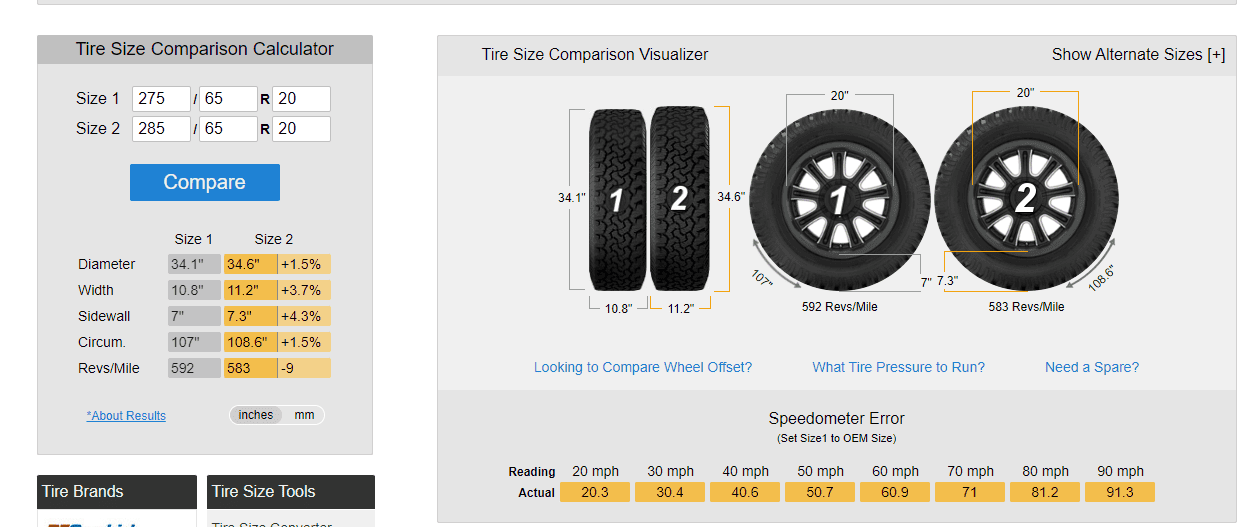

Would it be OK to run 275-65-R20 snow tires instead of the OEM size 285-65-R20?
https://www.nokiantires.com/tires/by-tire-size/snow-winter-tires/275-65-20/
