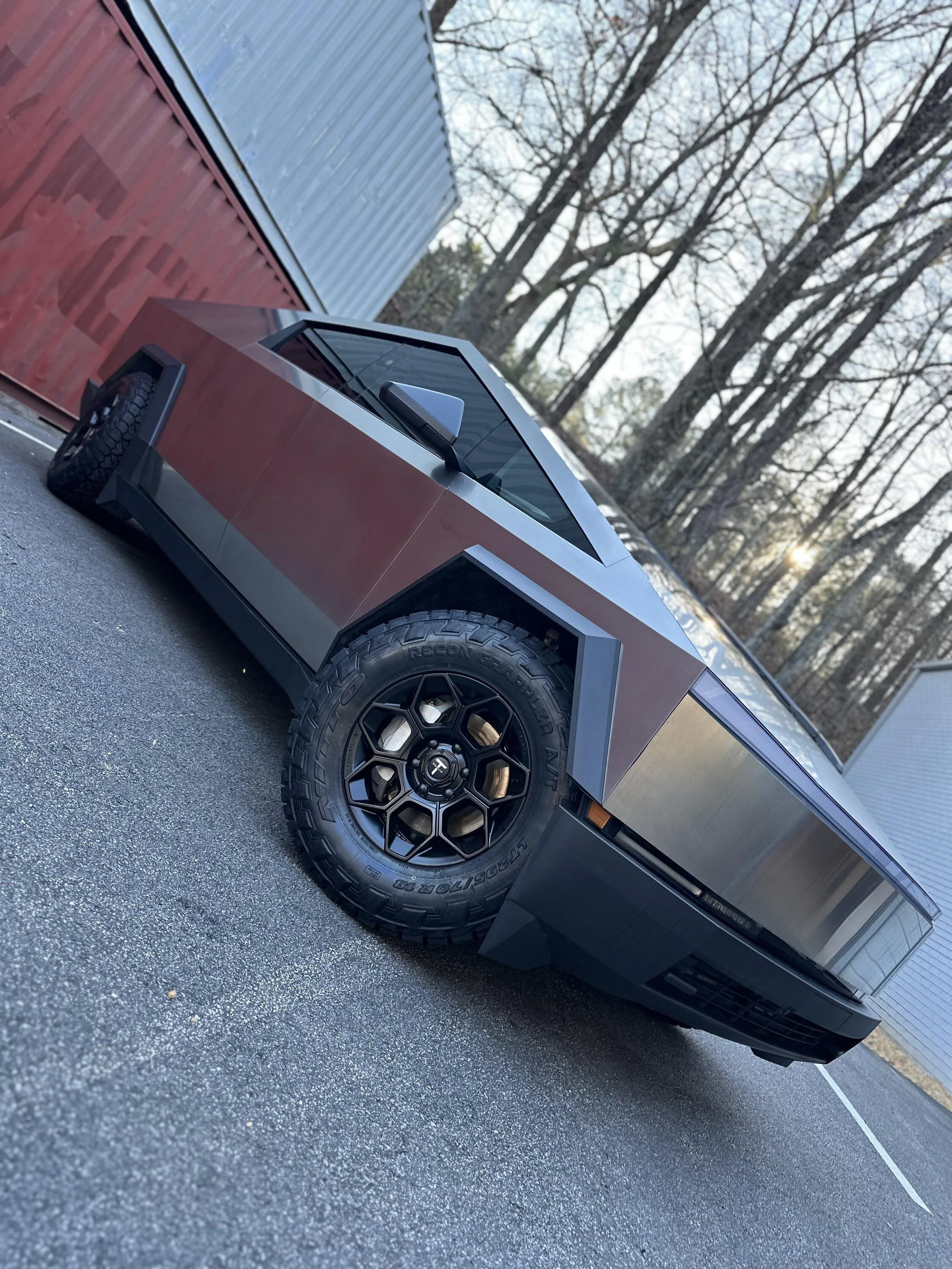

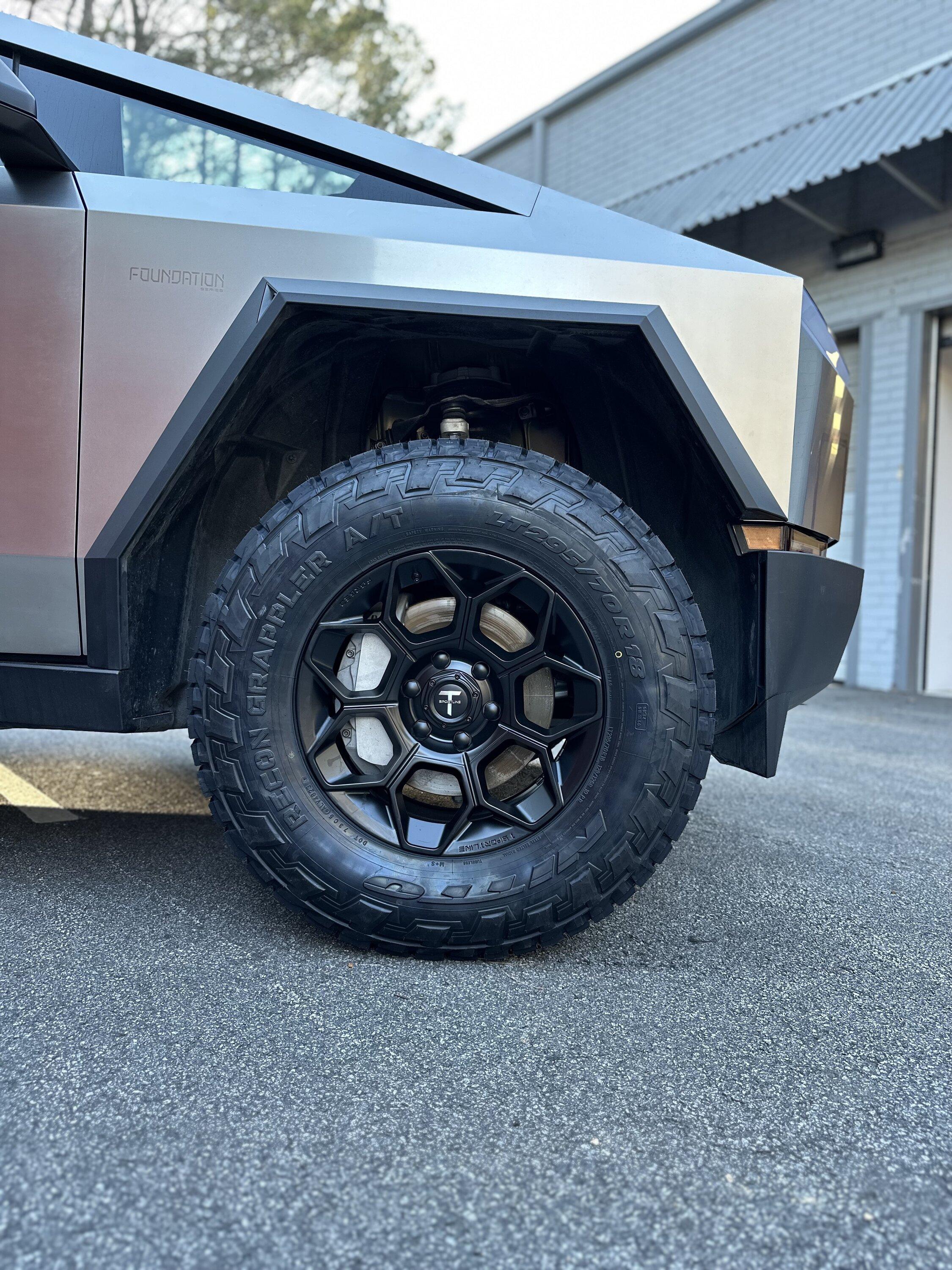

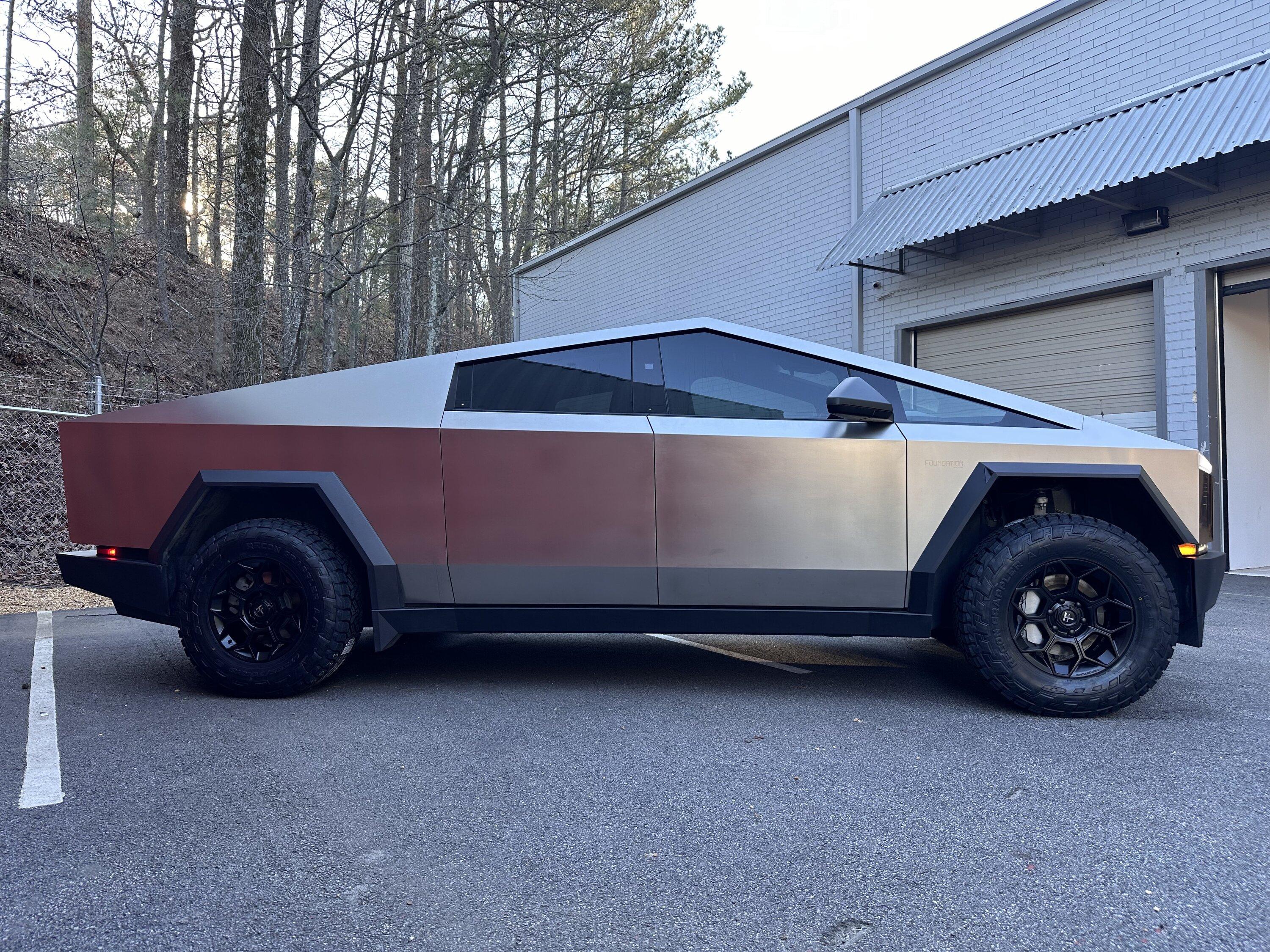

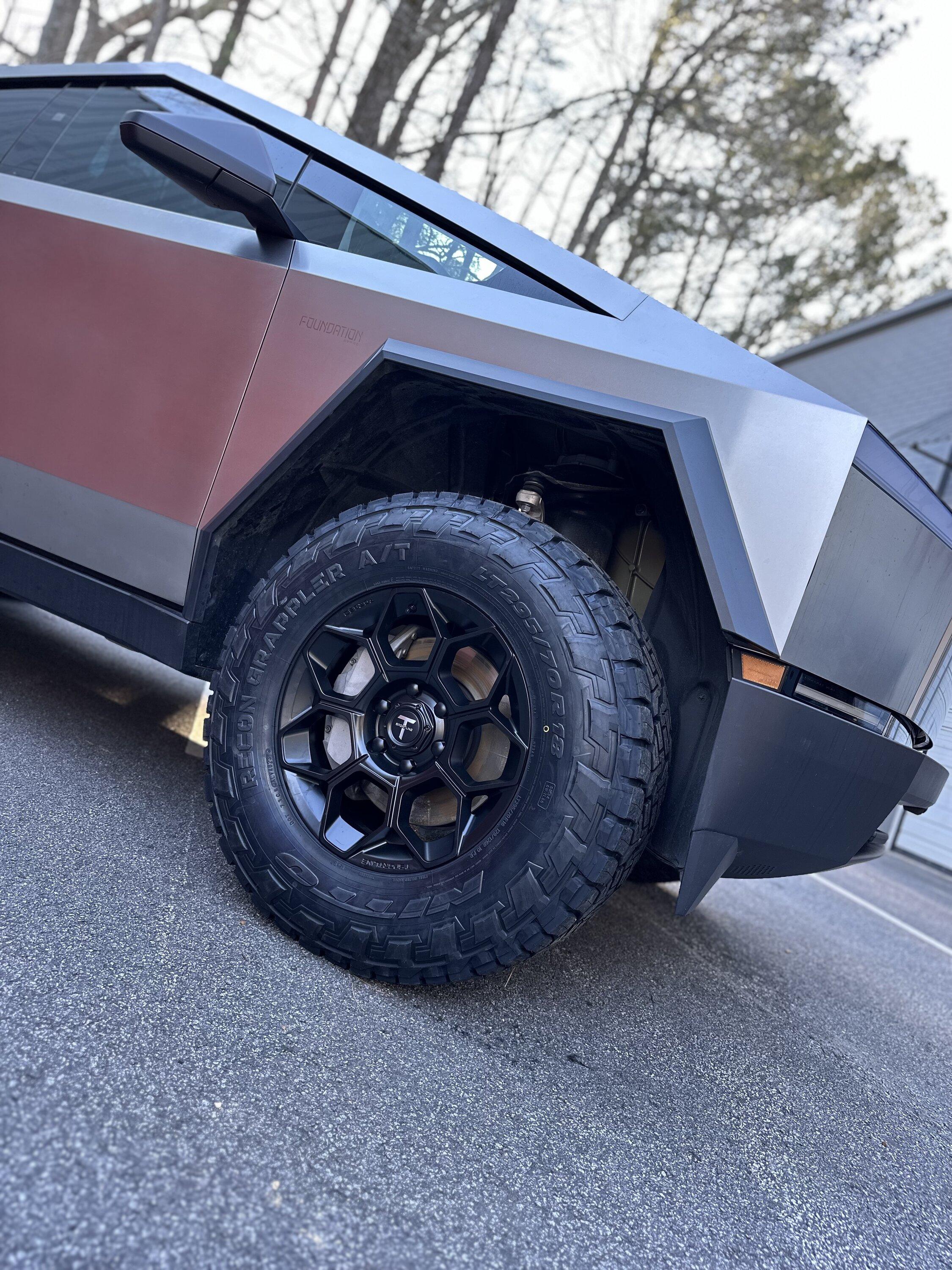

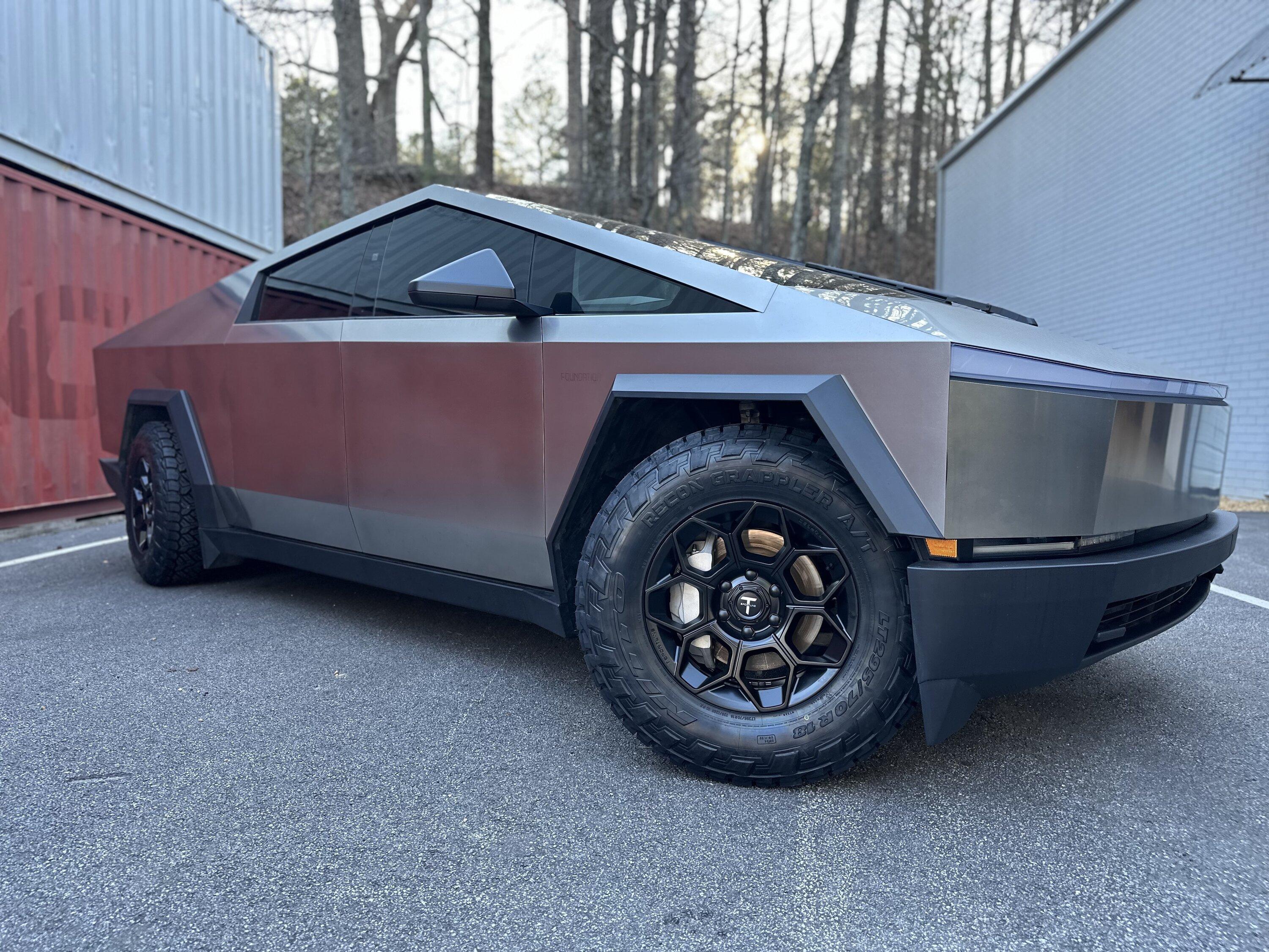

Ugh you did it again. Put the T-Sportline on the face of the wheel. I thought that wasn't going to happen any longer.
It is only on the fully forged wheels, so that is 100% optional (since we CNC cut them 1 at a time). The flow wheels have no logos and no option for logo. Prefer no logo = no problem!
