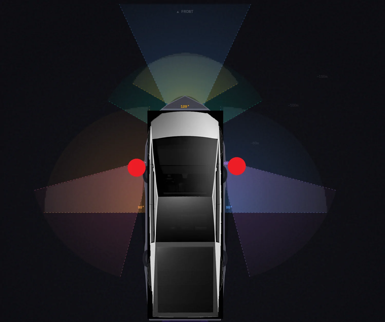

The top of the glass on the driver and passenger door is only hidden behind a weatherstrip. It is not behind metal or in the door frame. Breaking it is as easy as wedging in a metal object and prying back away from the truck. Tempered glass is weakest at the edges. They gave it the strongest glass in a production vehicle, then exposed it's Achilles tendon to thieves.
There is a blind spot for sentry. If someone comes up to the side around the A pillar, it will not activate sentry recording.

Where exactly are you referencing? is it those red "dots" in your attachment there?
this cat came right up to the side betwixt the camera and A pillar - in a direct path, which im ASSuming you are suggesting would be the bind spot area...
Both @Oscar and I have had our windshield wipers ripped off without Sentry capturing the event. The person(s) had to be standing next to the A pillar do it. It would imply there is a blind spot for triggering sentry, or perhaps there is a "heart beat" were sentry checks for motion. If someone approaches between a heartbeat maybe they do not trigger recording.
Admittedly I am not 100% sure what the issue is, but I am sure there are gaps in sentry monitoring/recording. I refer to them as blind spots.
Also in that picture you have the kid is not at the A pillar, they are at the door.
10,364
34,400
There is definitely a blind spot.
Have someone stand at a front wheel, just forward of the fender cam. They will not be visible from the fender cam, nor the B-pillar cam, nor the forward cam. And that is exactly where one would stand to grab the wiper.
Sentry isn't supposed to trigger on motion unless it is nearby, so I assume that someone could unwittingly enter the blind spot prior to triggering an event. They were probably visible upon approach and departure, but not yet close enough for Sentry to activate.

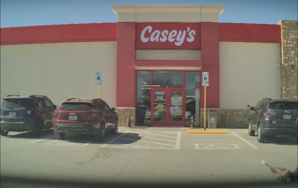

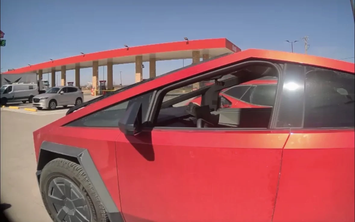

Here's two snapshots from a recent SuperCharger visit, showing the forward cam and the RH B-pillar cam:
Tesla Cybertruck Sentry mode failed me - how? Window smashed with no recordings IMG_1974
Tesla Cybertruck Sentry mode failed me - how? Window smashed with no recordings IMG_1975
Note that the images do not overlap, and neither one captured the corner of the building. The fender cam faces rearward, so the building is not visible at all.
