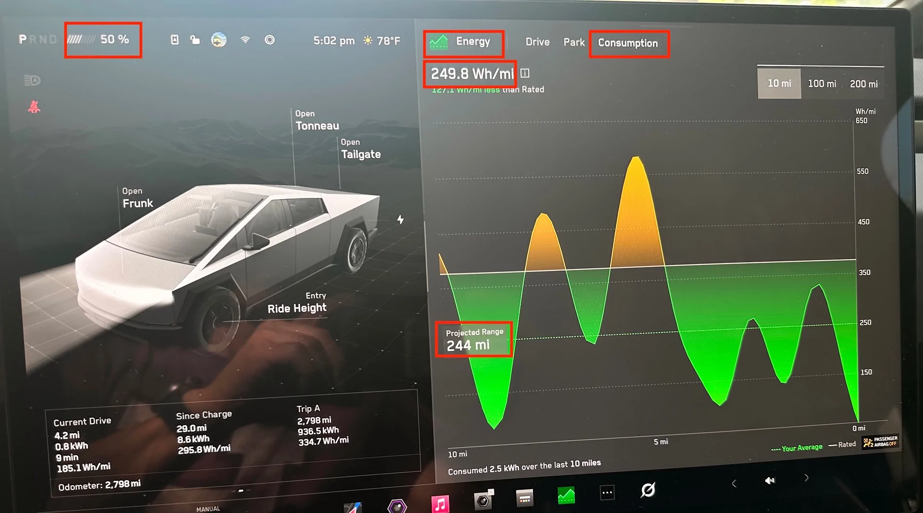

I think we're talking past in other in violent agreement.
Of course the calculation includes consumption based on driving style... but only for the current trip. Nothing you did yesterday should affect the drive you take today. This is where we seem to differ.
In your theory, if I tow for a week getting 150mi of range, and then head out on Monday without a trailer, the range estimate will still be based on last week's 1000Wh/mi?
It doesn't need to know how you drove last week, it is not relevant to today.
I guess an easy way to test this is to switch driver profiles sitting in the driveway, and see if that affects the range estimate. Any saved "driving style" statistics would need to be segregated by user, right?
I was thinking the same thing, about switching profiles to see, but if it goes by vehicle and not profile wouldn’t work. But your wh/ml isn’t the same as “acceleration habits”. Don’t would know if your towing a trailer or not and adjust. But I don’t think the range estimate resets everyday or every drive. Otherwise you’d take off and have a widely different estimated range and would start calculating and changing like crazy.
