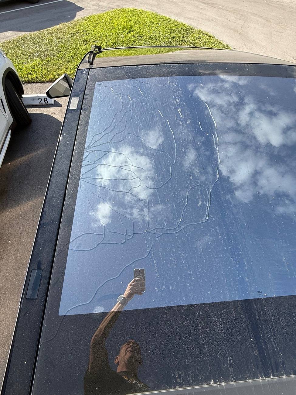

Anyone have their roof just break for no reason. ?? Got in car and heard the crack and it spiderwebbed. Warranty or no. ?

The fracture pattern is clearly a stress crack migration originating from the edge. This is clearly NOT an impact / point contact fracture. Here is synopsis from a Glass consulting firm.
BTY: Cybertruck windshield glass is more like High-rise laminated glass and not typical automotive windshield glass.

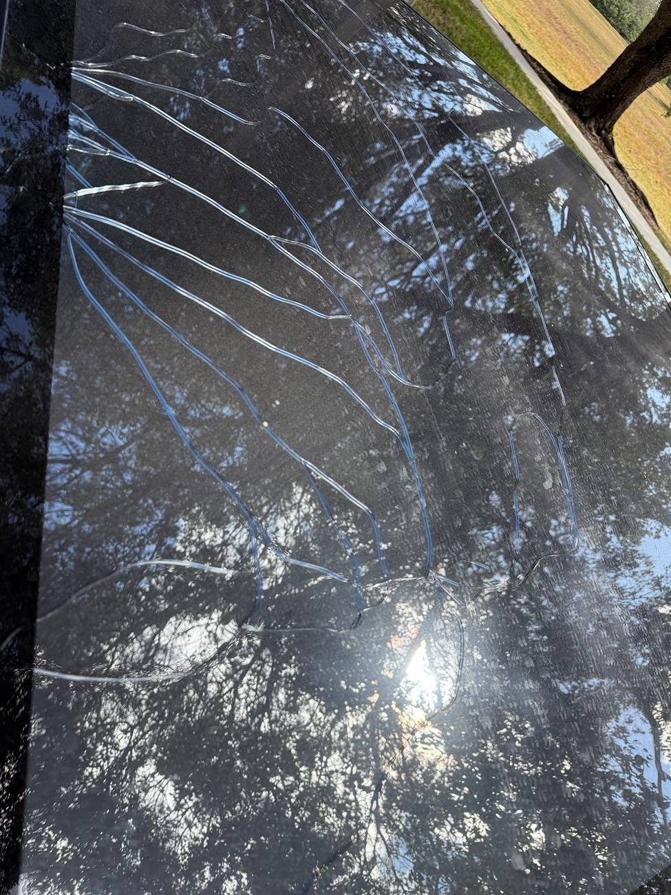

Systems Engineer
This happened on my CT a few months ago. I posted a thread about it on this forum. You could see the crack grow over a period of about 6 hours on my home camera. Tesla did a thorough inspection looking for an impact point but couldn't find one. They replaced it but it did take them over a month to get the glass in stock.
