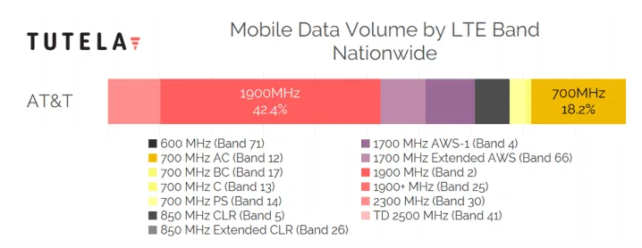

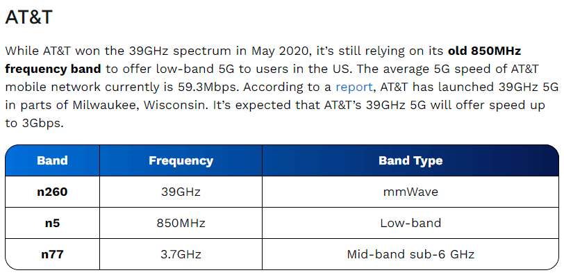

You are correct that the generalized stated does not cover everything - but it was a generalization.
The old Sprint frequencies now owned by T-Mobile are a great example and why their coverage is better than many others when combined with the original T-Mobile spectrum.
Of course, it appears Tesla is using the AT&T network who is using three bands right now, mainly the older 850 MHz (low band) which does have longer wavelengths, travels farther, but results in lower speeds. They do also have a mid-band at 3.7 GHz and purchased some high band spectrum around Ghz (the mm-wave) which will both provide better speeds, but the 3.7 GHz would have the shortest range (unobstructed).
And you are spot-on that the stainless of the CT will not be great for signal coverage - no matter the band.
AT&T on 3 bands is a slight misnomer.
Tesla Cybertruck Shouldn’t Cybertruck have 5G? 1711560295644-po
Tesla Cybertruck Shouldn’t Cybertruck have 5G? 1711560315556-1r
