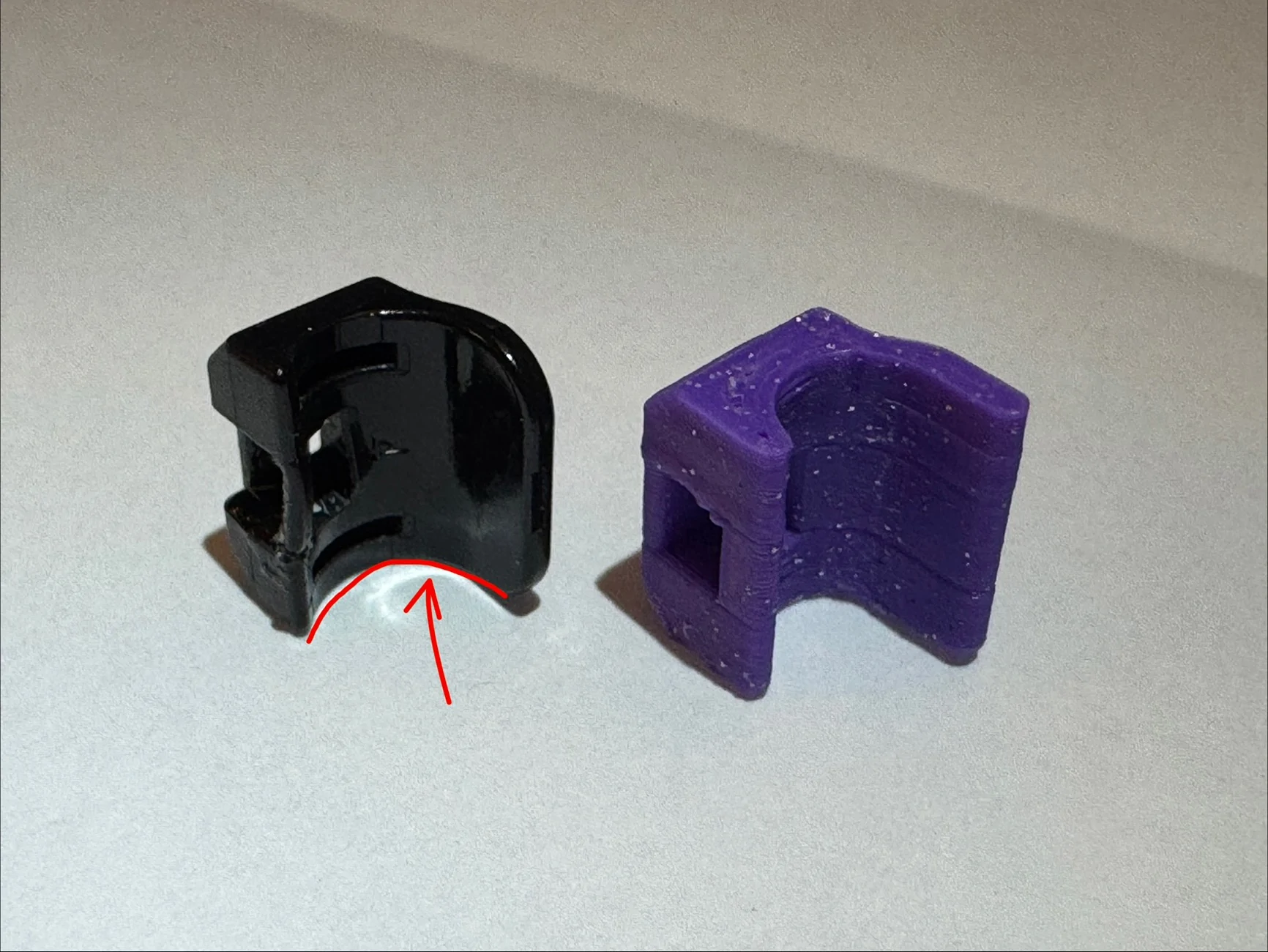

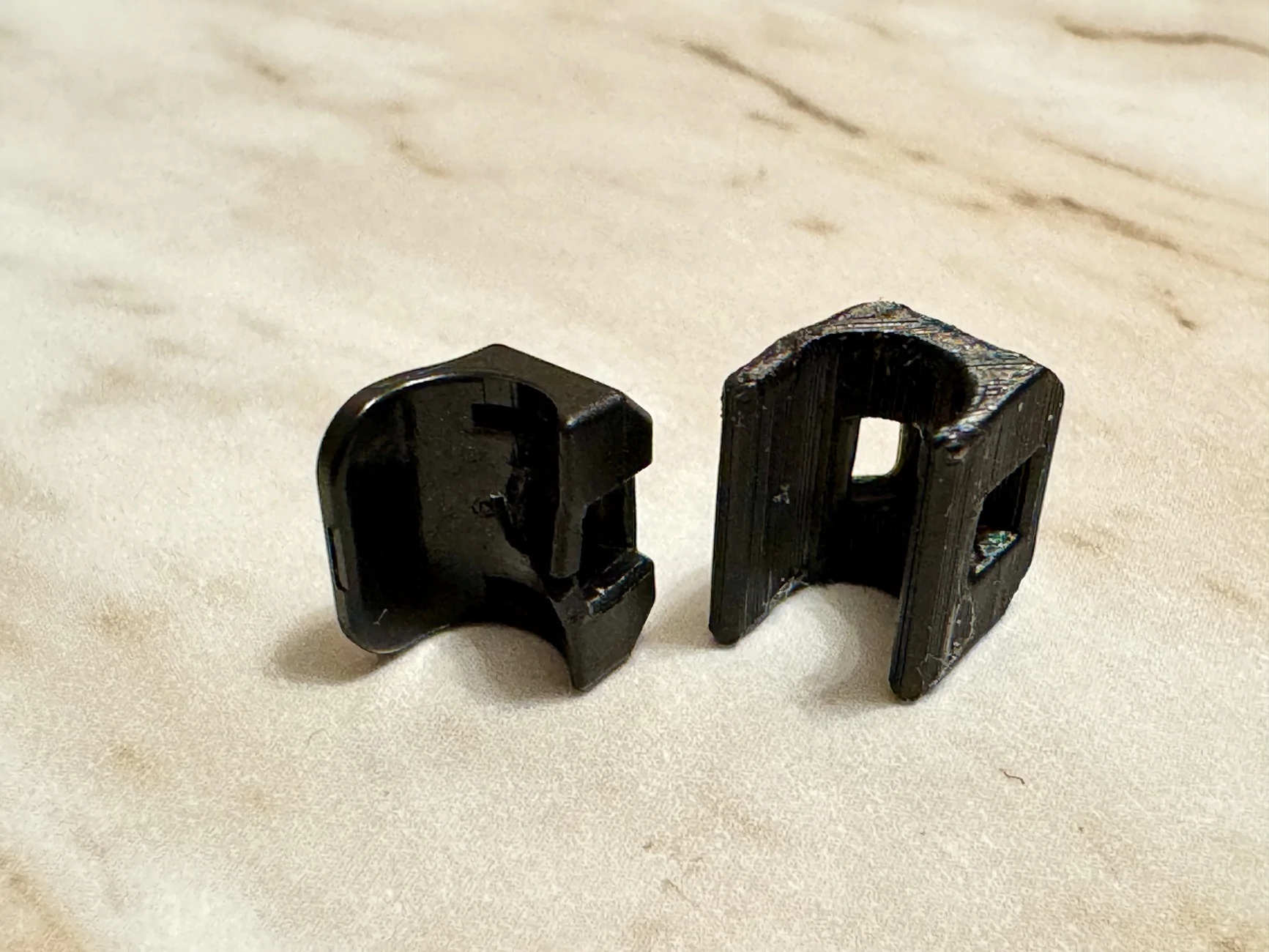

Still working on it......replacement washer fluid hose retaining clips for the wiper arm. Tesla, for whatever reason, doesn't have them listed in their EPC.

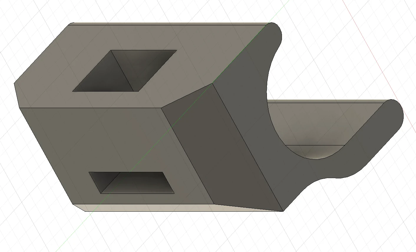

I’m intrigued by your process. If it’s not too inconvenient could you please describe or show how you reverse engineer a part into a 3d print?

I don’t consider myself an artist, but I’d imagine it’s similar to an artist looking at a piece of material (ie stone, wood, etc) and carving away the material until they get the overall shape they want. Similarly, I see a rectangular shape, in this case, and just remove or add shapes until I get the overall shape I’m looking for.
Didn’t copy it 100% cause I was thinking about how it’ll print. Like this rounded edge; wanted more surface area on the print bed.
Tesla Cybertruck Show us an accessory we’ve never seen before! MFZ Challenge thread. IMG_0259
After playing around with a base design, I may teak it a bit more. In this case, I’ve already redesigned with more wrap around the hose so it’ll actually clip onto the hose rather than be a ‘shelf.’ (not pictured) This area doesn’t actually hold the hose….
Current revision goes about 210 degrees around the hose; should be enough to grab the hose. If not, I’ll adjust it again. 😁

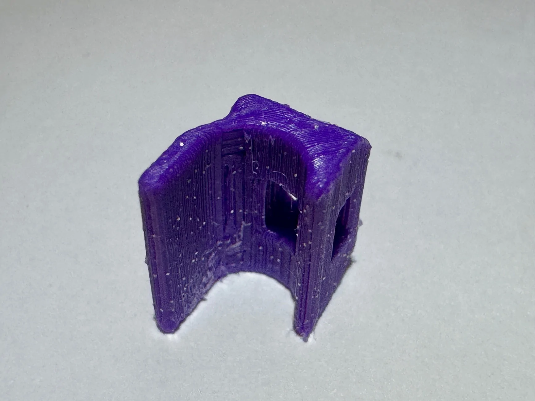

Changing out the wiper and one broke off. Noticed the other 3 were cracked. I think the tolerance on the factory part is too tight and they break right away once installed. Also remembered someone else was looking for them and Tesla doesn’t offer them. So, I thought I’d make ‘em.
Depending on printers and material used, this might be tight too. So I’d recommend scaling the print up to loosen the tolerance. With ABS I find 100% works. With PETG (roll I have is old so it’s probably not good), I scaled it up to 110%.
