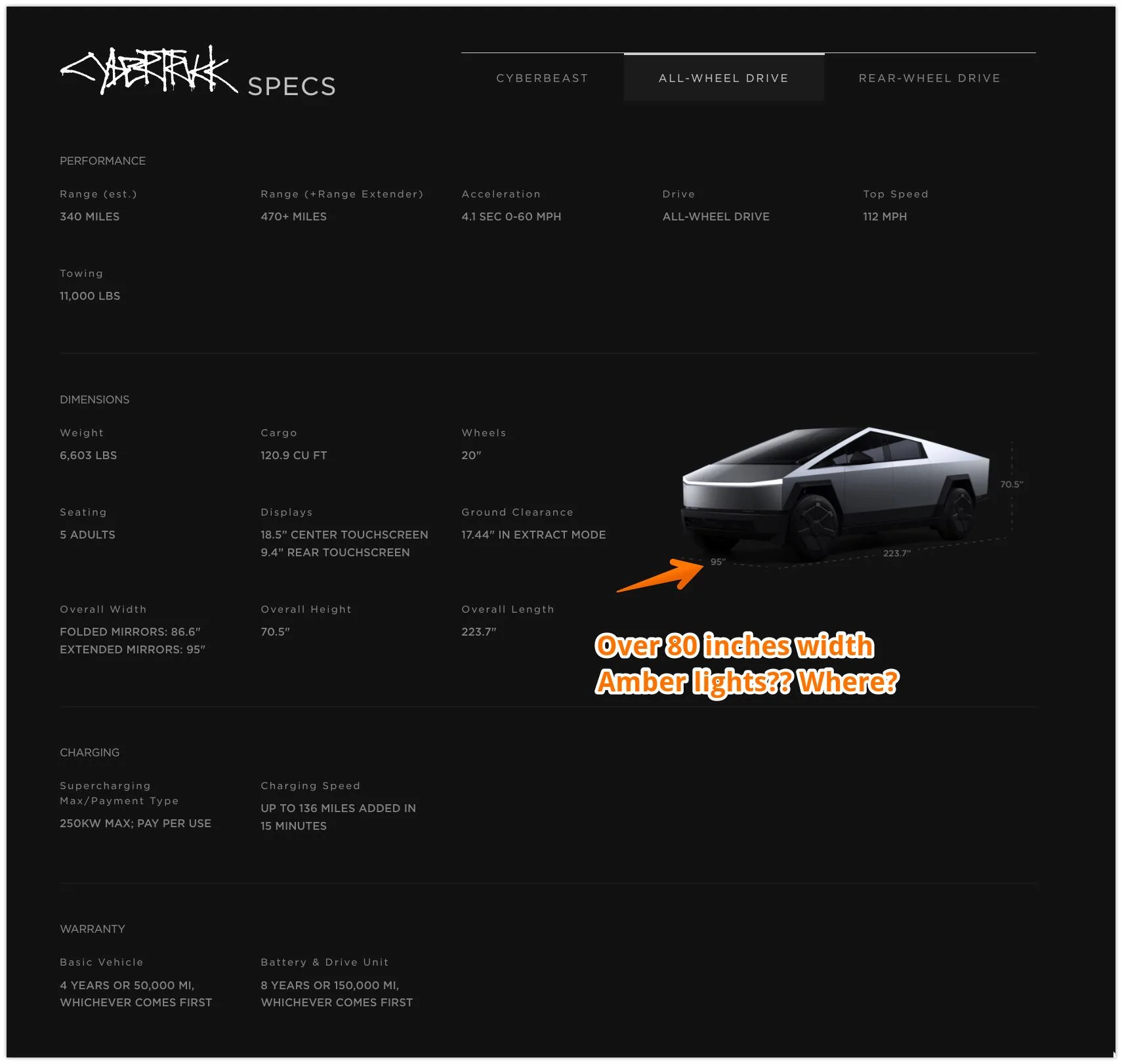

Specs out now, width 95 inches. Where are the amber lights?
lowtek
Oct 18, 2023
262
556
Alabama
Plaid
I do things.
It's under 80 inches the way they are required measure it for that regulation. Not sure why that says 95, probably includes mirrors.
7,146
13,756
no amber lights needed
NHSTA measures by no-mirror width
CT no-mirror width is 79.9"
more detail:
CT is listed at 79.99 absent mirrors (not folded) - this is NHSTA measurement of relevance, no marker lights required (80" pretty standard for any 1/2 ton truck that isn't eg Raptor/TRX)
But that 79.99 includes ~4” of fender flare
It’s 86.6” wide with the mirrors folded, or a 95” mirrors out
For comparison, Lightning is 79.9” absent mirrors (and doesn’t have fender flares), 83.6 folded, 96” extended
Your Range Rover presumably 73.6” (no mirrors), 80.6” (Mirrors In) / 87.0” (Mirrors Out)
So, accounting for the CT’s fender flares (and it’s ‘hidden’ buldge at the middle section), metal to metal the CT is ~2.5” wider than the Range Rover
Explains in part how their interior dimensions (assuming RR standard wheelbase) are similar, with CT having a touch more shoulder room (not accounting for real-world packaging/ergo)
