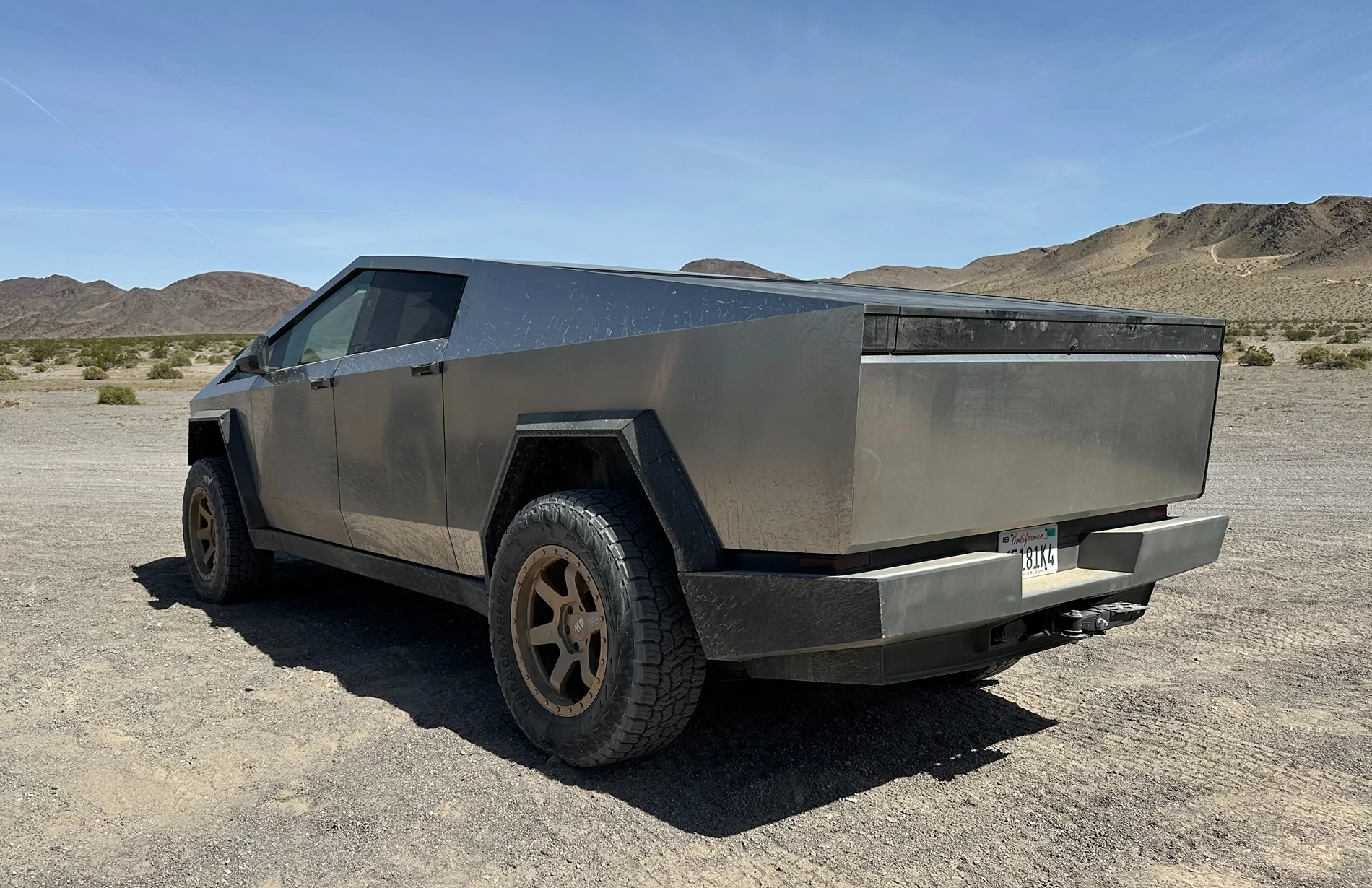

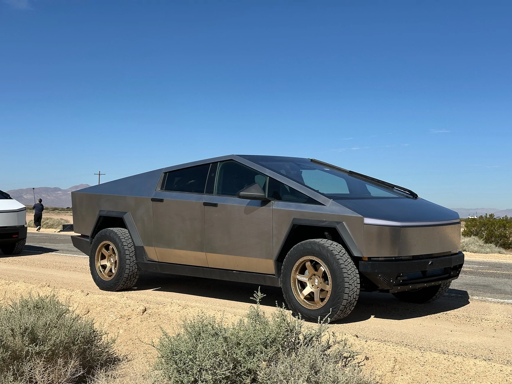

Well I'm stubborn, and against all good advice here, I went and tried different size wheels, 285/65/r20 in the front, 295/65r20 in the back.
I was afraid that I might get some kind of error code because the front wheels would be spinning faster than the back wheels, but after about a 1000 miles on and off road, I have not got any issues.
The way I saw it is that the difference in diameter is only about 2% so I hoped that it would be within the range the software has to consider tires wearing differently. Also, I have a model X which come with staggered wheels but Tesla used to sell a square set of wheels for them. So kind of the opposite of what I wanted to try with the Cybertruck.
The difference is very subtle but I really like it. I always felt that the rear wheels look too small in the Cybertruck.
