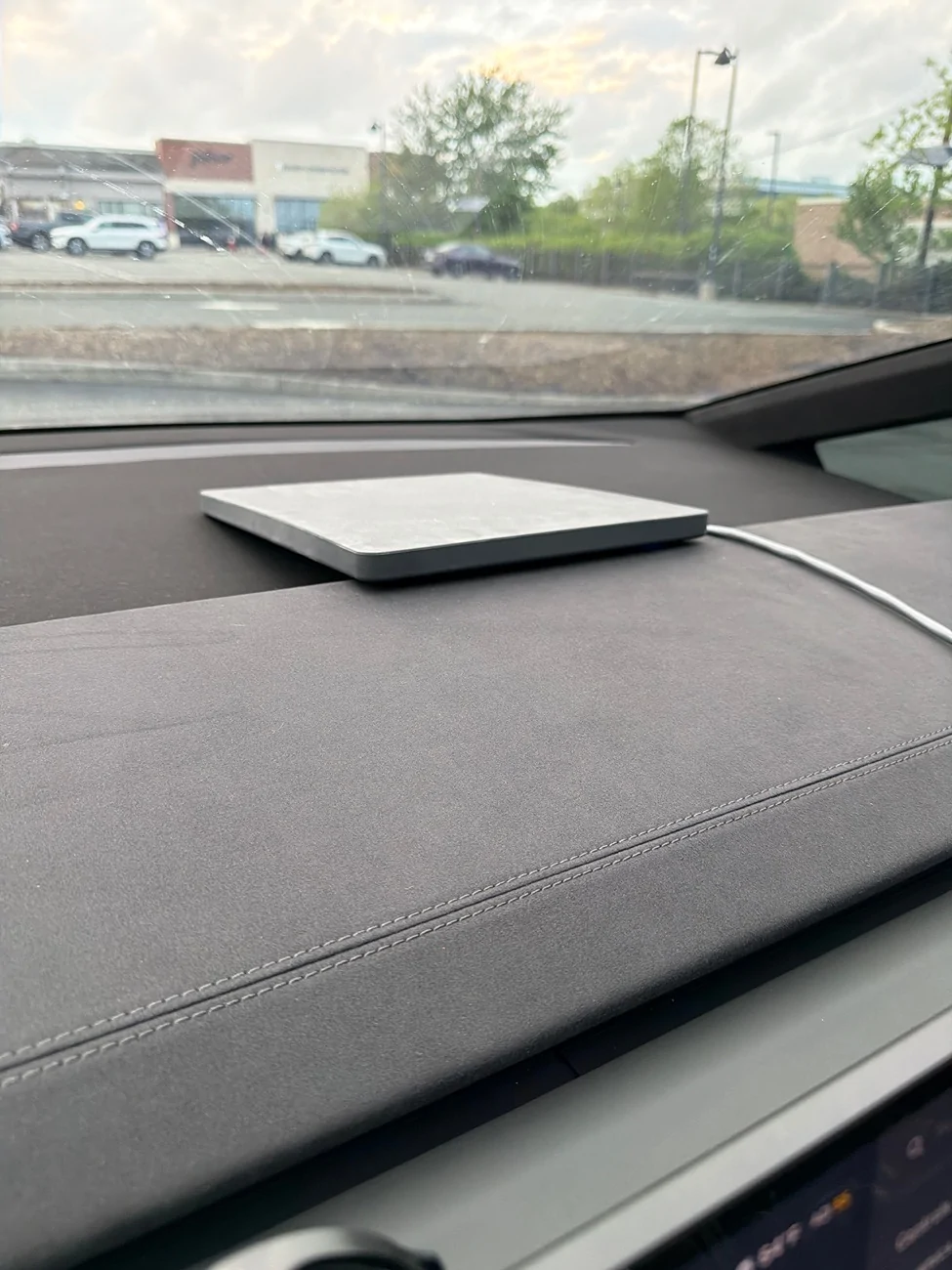

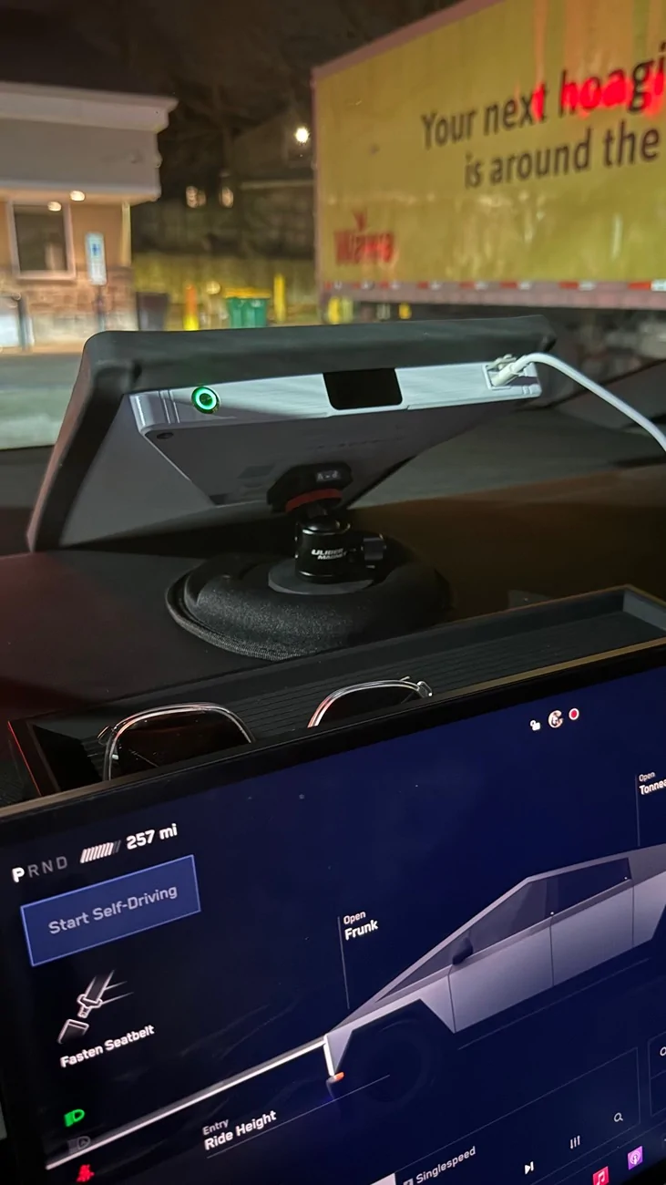

got it!
CT mode:
Tesla Cybertruck Convenient Starlink Mini dashboard mount + Video IMG_1243
Tesla Cybertruck Convenient Starlink Mini dashboard mount + Video IMG_1246
the dark cover is definitely worth it for the car. no glare, makes it hard to see the dish itself from the outside too.

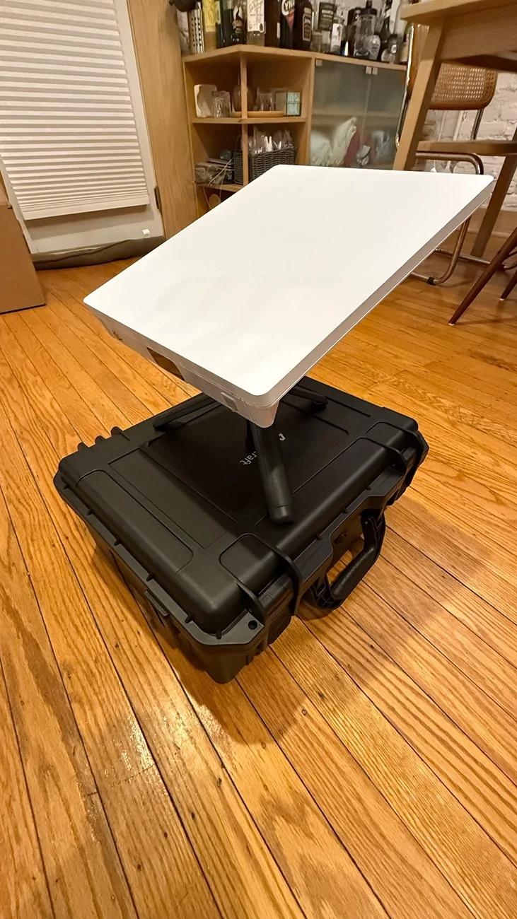

camp/beach mode:
Tesla Cybertruck Convenient Starlink Mini dashboard mount + Video IMG_1237
and they just increased the Roam plan cap to 100gb!

Love it! Looks great! Hope the weighted mount works for you as it’s been great for me so far.
What swivel mount did you go with for the attachment? Looks nice!

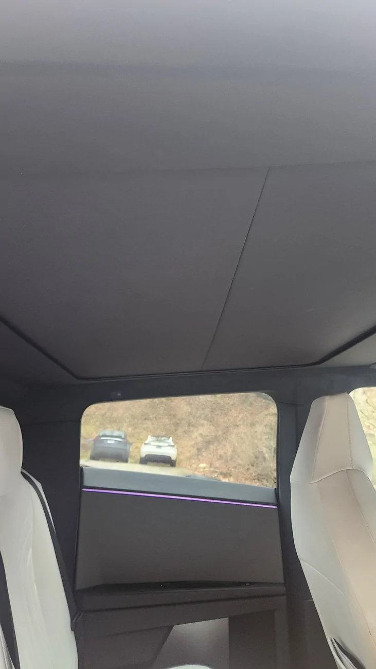

I just suction cupped it to the rear roof glass right behind the driver's head. Works great.

There are my kids behind my seat 🤣 and I personally don't like much any visible cables, just my thing, I like to either hide all signs of them or modify it, so it looks as aesthetic as possible 🤷‍♂️

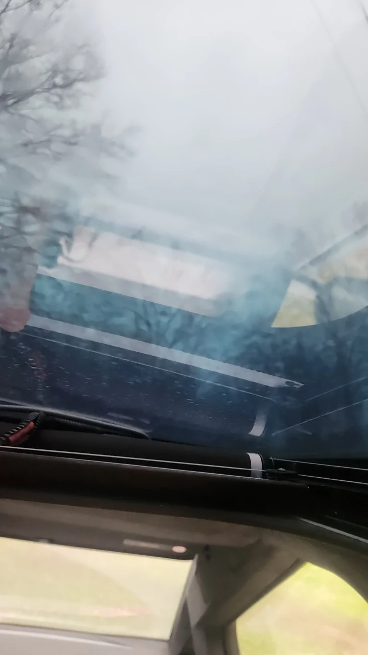

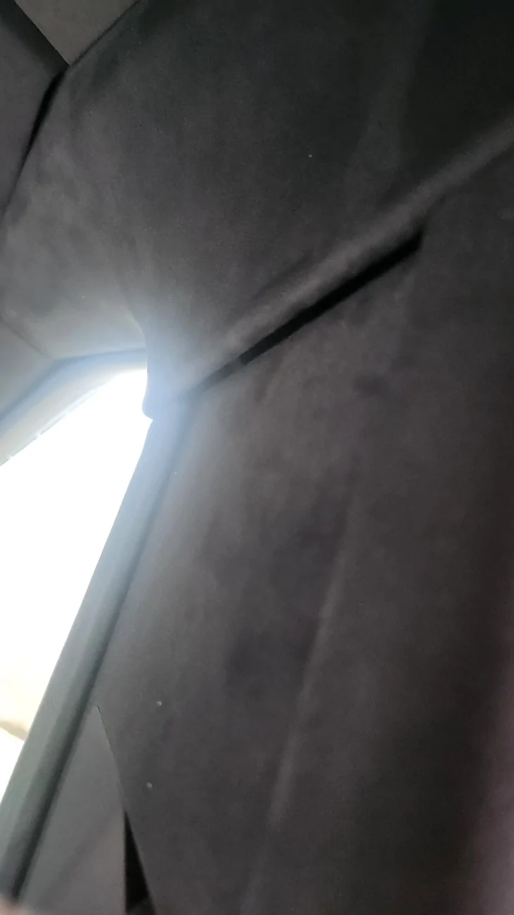

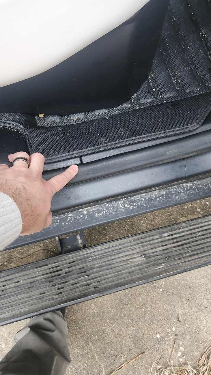

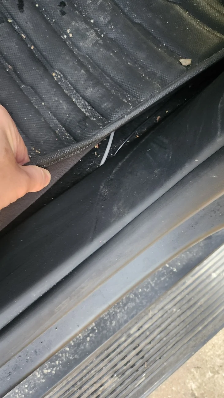

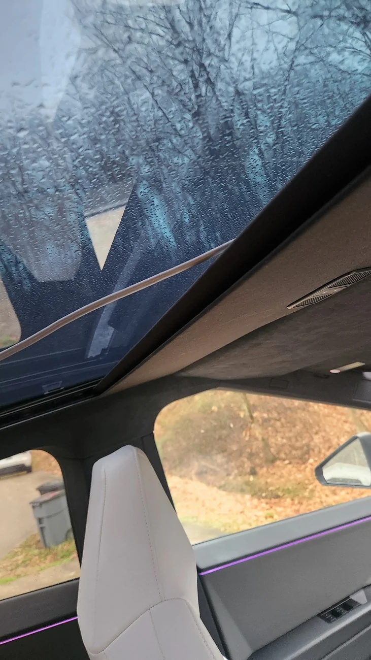

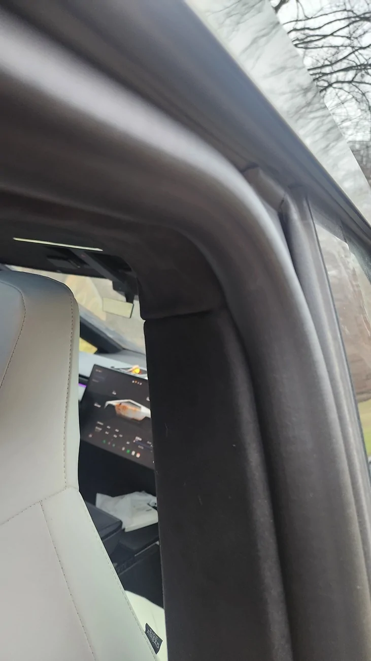

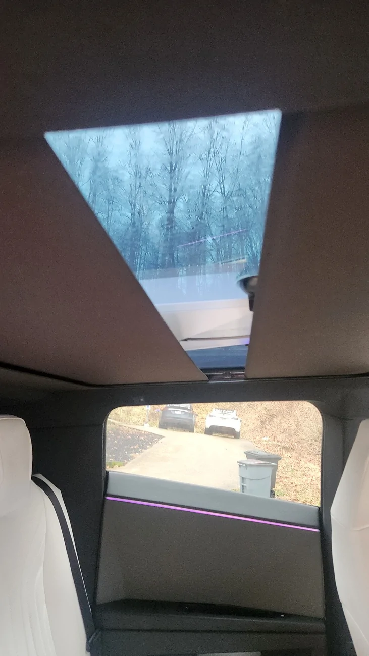

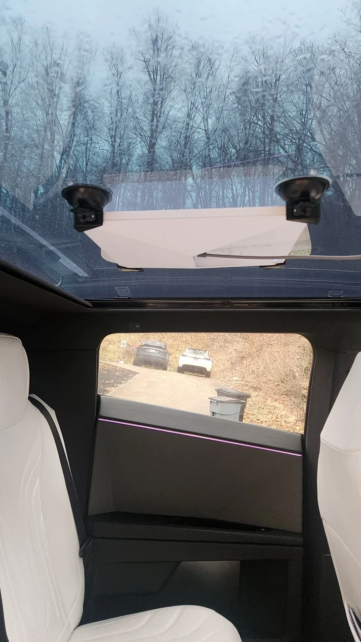

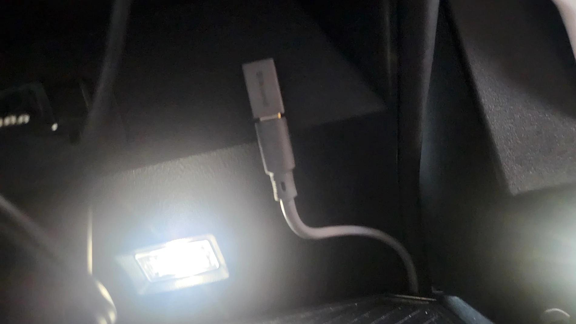

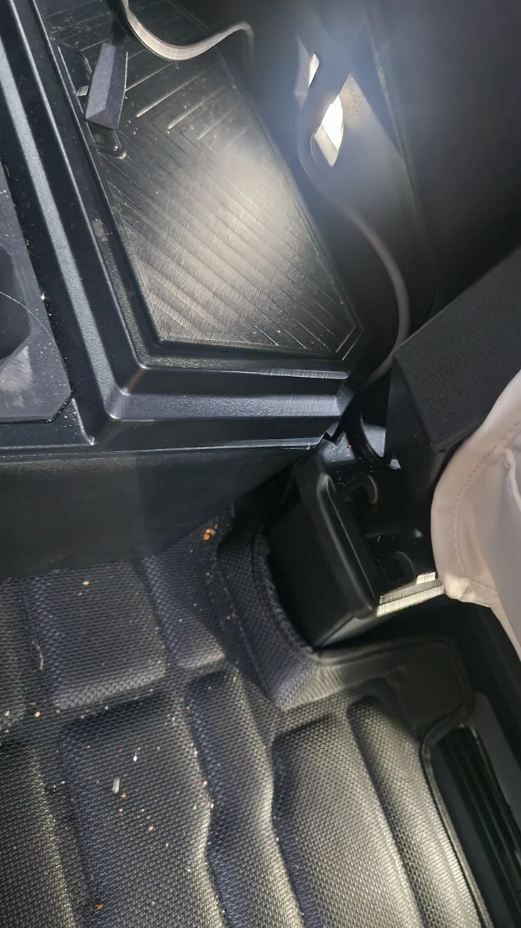

Suction cupped midline
90° usb-c adapter
Tesla Cybertruck Convenient Starlink Mini dashboard mount + Video 20260106_115340
Ran behind cup holders and under floor mat
Tesla Cybertruck Convenient Starlink Mini dashboard mount + Video 20260106_115358
Grey starlink wire ran over sunshade towards passenger front

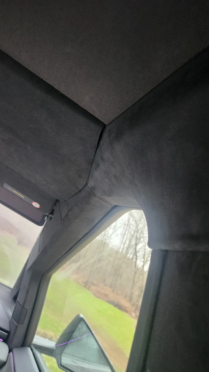

Tesla Cybertruck Convenient Starlink Mini dashboard mount + Video 20260106_115258
routed toward passenger rear using trim tool along top of seat belt adjust area
Tesla Cybertruck Convenient Starlink Mini dashboard mount + Video 20260106_115236
Pull rear door weather strip and route down rear door
Tesla Cybertruck Convenient Starlink Mini dashboard mount + Video 20260106_115229
Tesla Cybertruck Convenient Starlink Mini dashboard mount + Video 20260106_115331
Tesla Cybertruck Convenient Starlink Mini dashboard mount + Video 20260106_115309
Tesla Cybertruck Convenient Starlink Mini dashboard mount + Video 20260106_115327
Tesla Cybertruck Convenient Starlink Mini dashboard mount + Video 20260106_115305
Tesla Cybertruck Convenient Starlink Mini dashboard mount + Video 20260106_115238
Tesla Cybertruck Convenient Starlink Mini dashboard mount + Video 20260106_115224
Tesla Cybertruck Convenient Starlink Mini dashboard mount + Video 20260106_115219

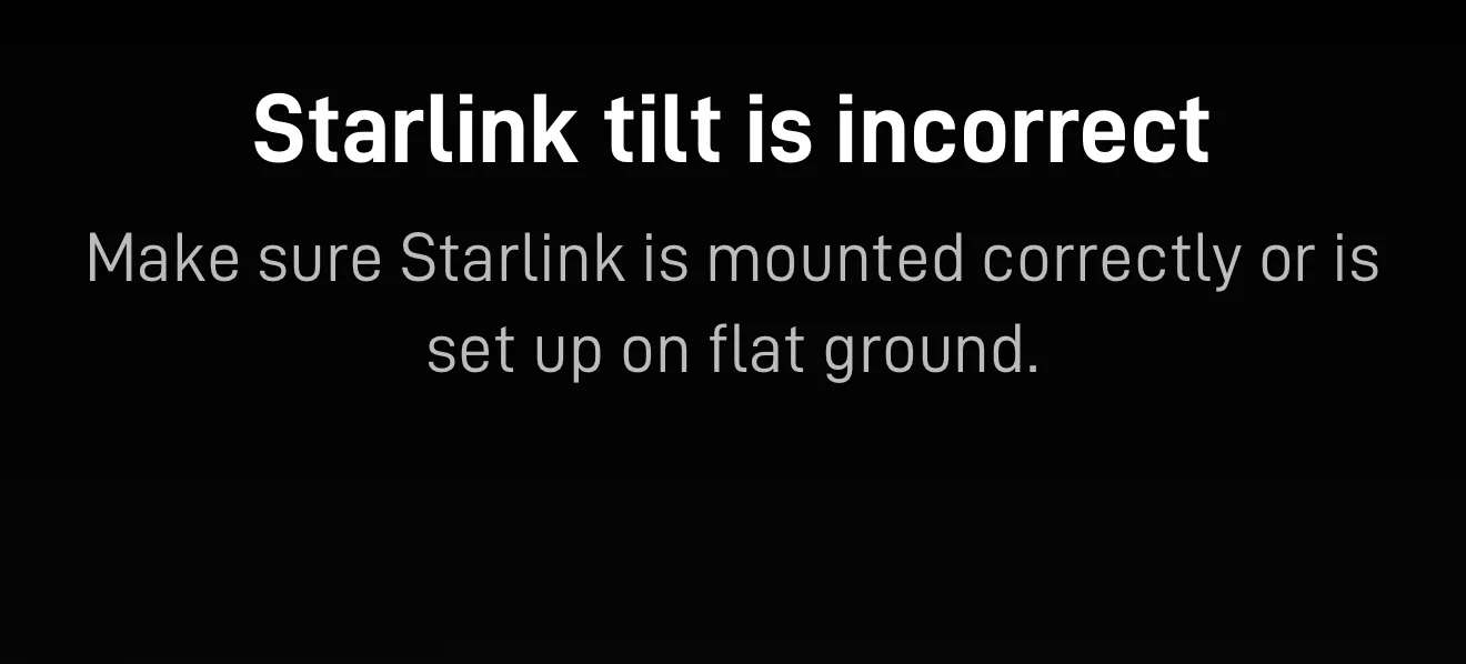

what does your alignment say?
Tesla Cybertruck Convenient Starlink Mini dashboard mount + Video 1769284184670-mv
mine is facing forward tilted
Think due to the angled glass
I have to face it backwards and do the tilt
Then I’ll be in alignment

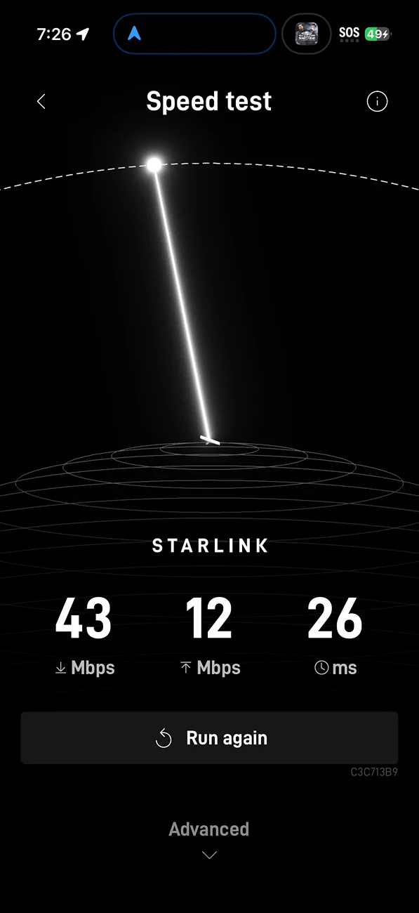

The only problems I have had is brief disruptions due to overpasses

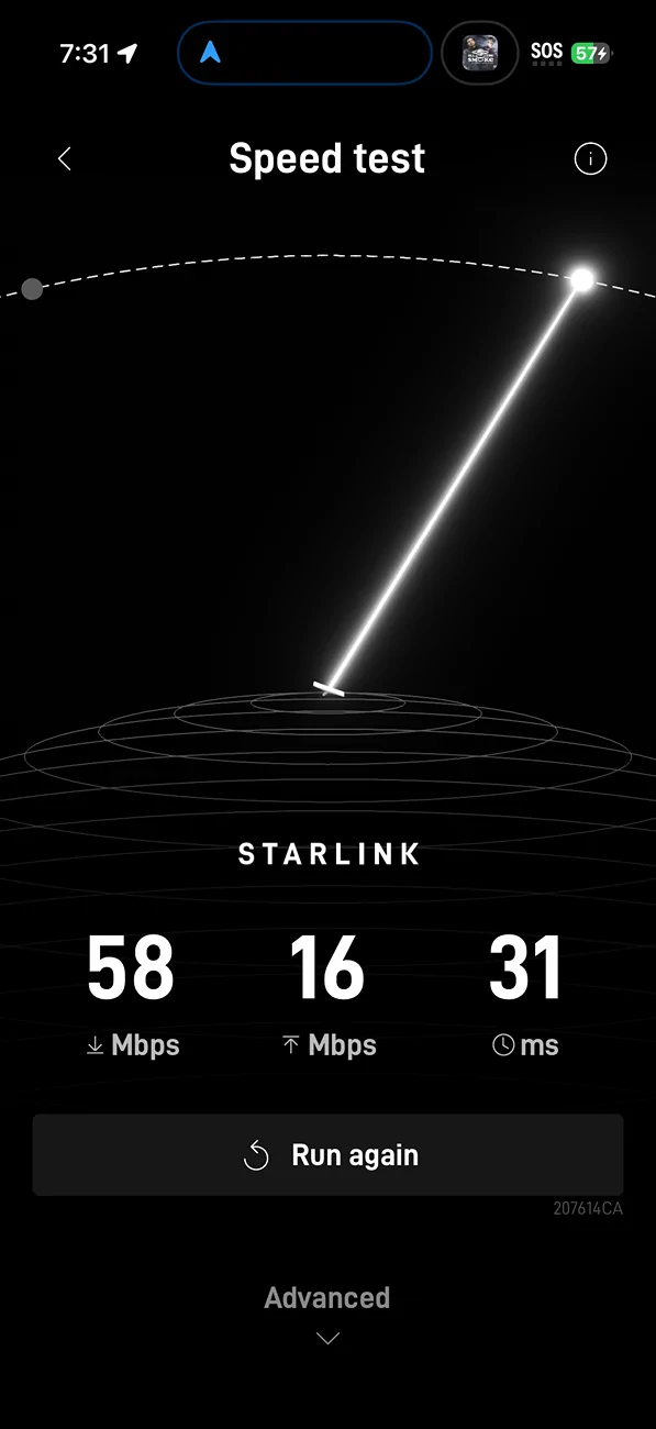

mine worked fine facing the front windshield.

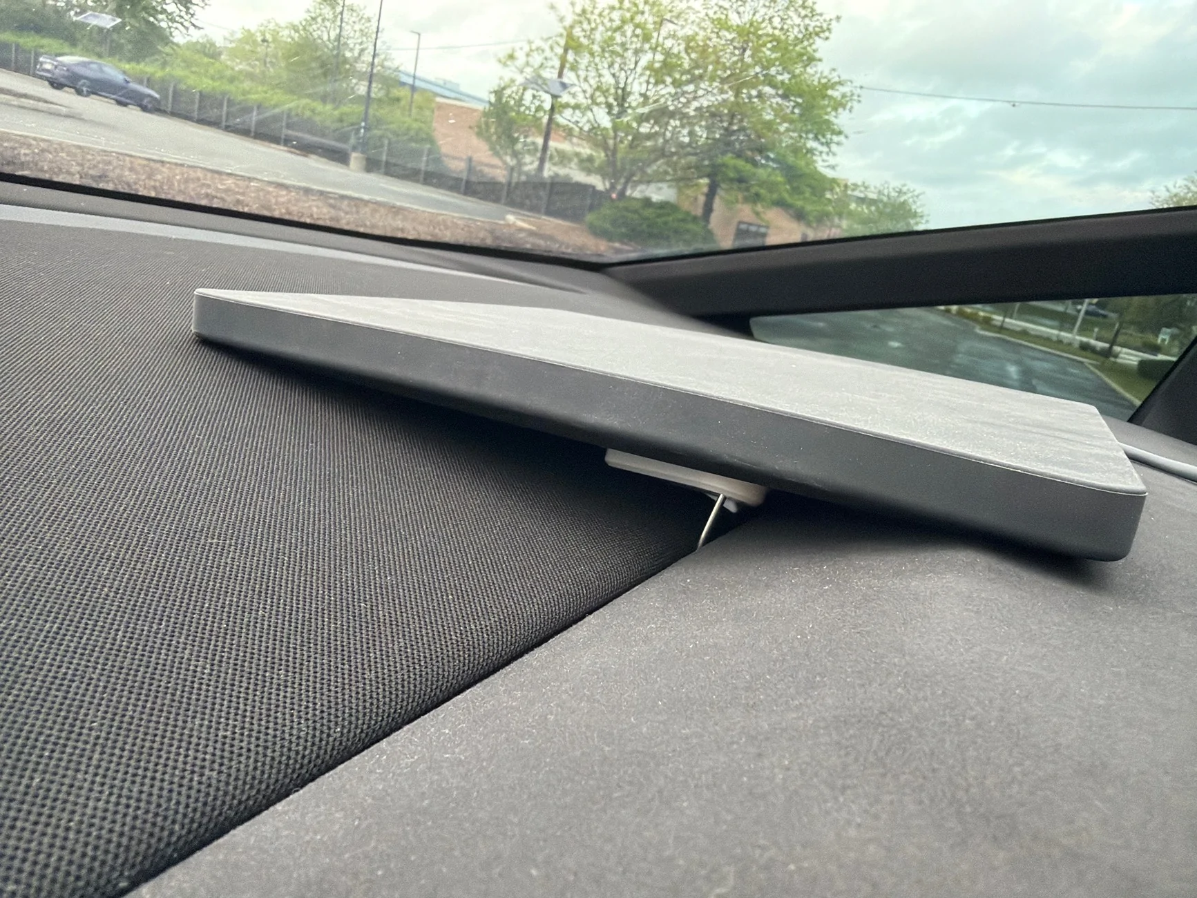

That’s is how I setup mine super simple and does not move at all. One cable splits to power and cat6. Goes into a router that has multiple connects.
116
8,357
9,589
Love that. What’s the piece lodged between the Alcantara and fabric dash?
