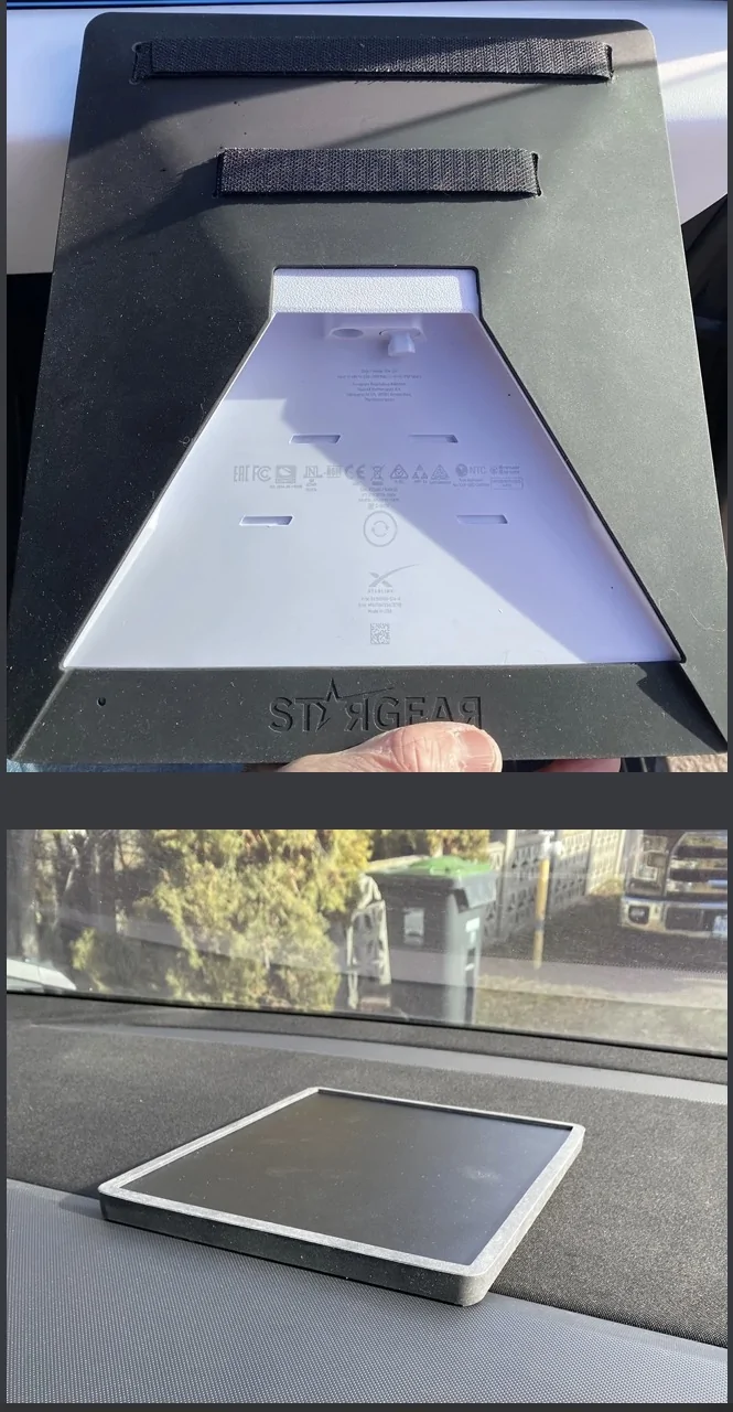

I bought the one shown below. It did fall once. However, I saw where it was recommended that you should wipe the inside of the roof glass and the suction cups with Isopropyl Alcohol prior to installing. So far, it has not fallen. I have the roof netting that came with my Foundation Series AWD. I run the cable from the back of the mini antenna to the back of the roof netting, down behind the back seat, under the floor, and plug into the 110AC outlet in the back of the front center console. From the outside, you can’t tell there is a StarLink antenna in the car.

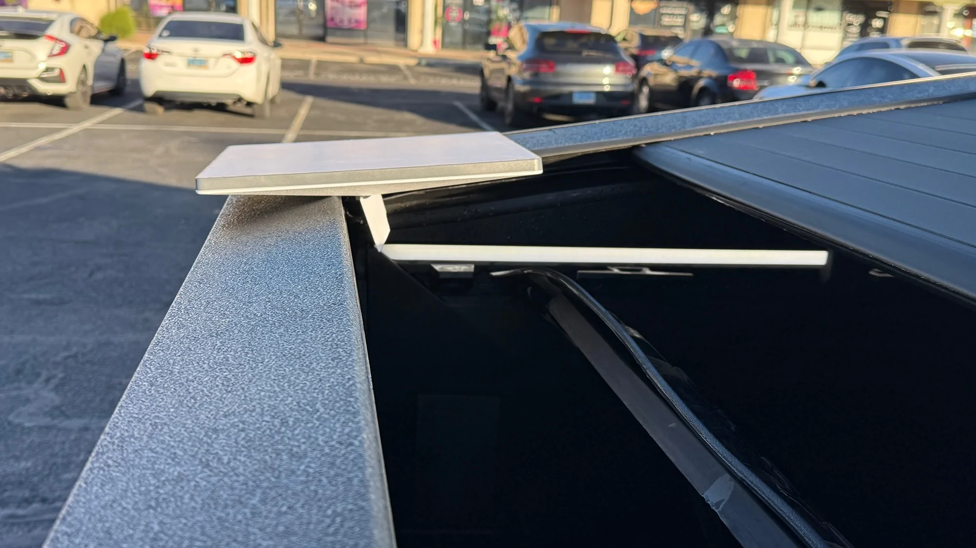

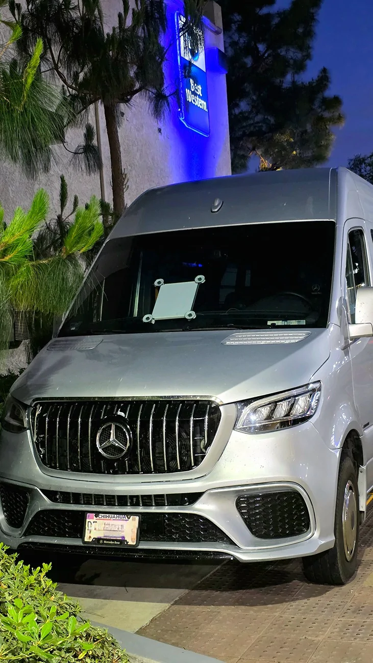

Good day y'all. I'm currently visiting Disneyland and came across this very expensive Mercedes camper van from Chihuahua, Mexico, at the hotel parking lot. And that looks like a Starlink mounted on the front windshield with suction cups 🤓

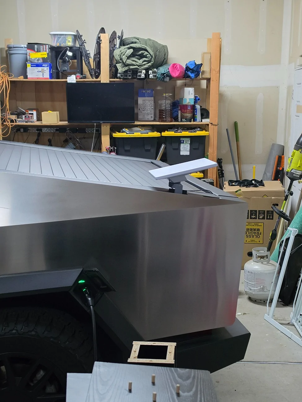

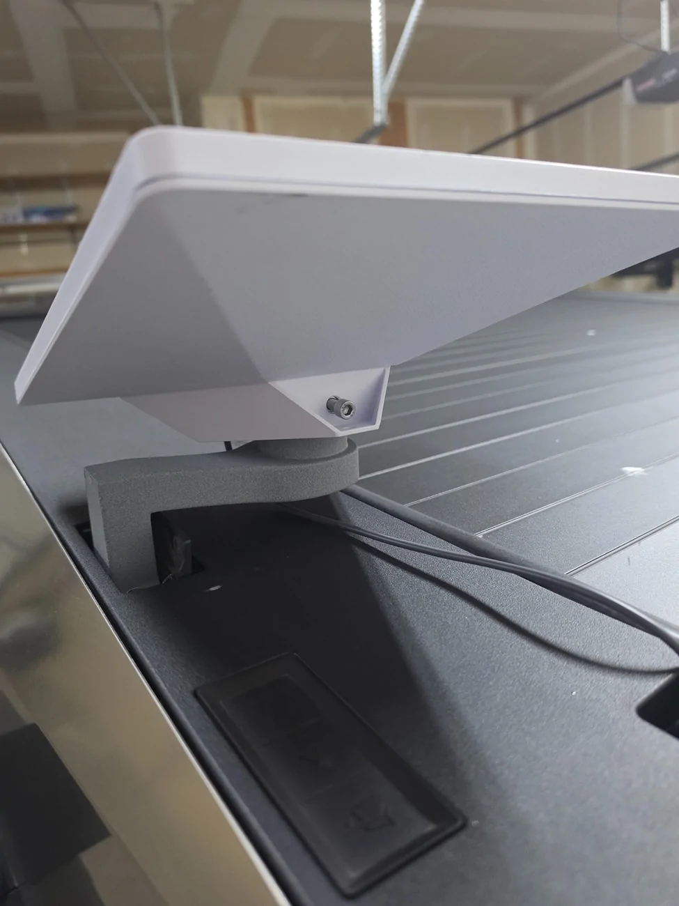

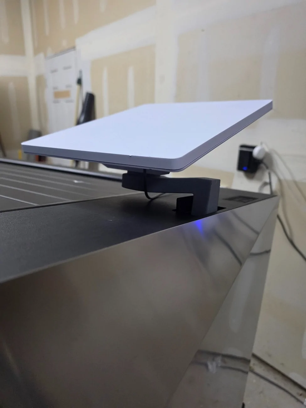

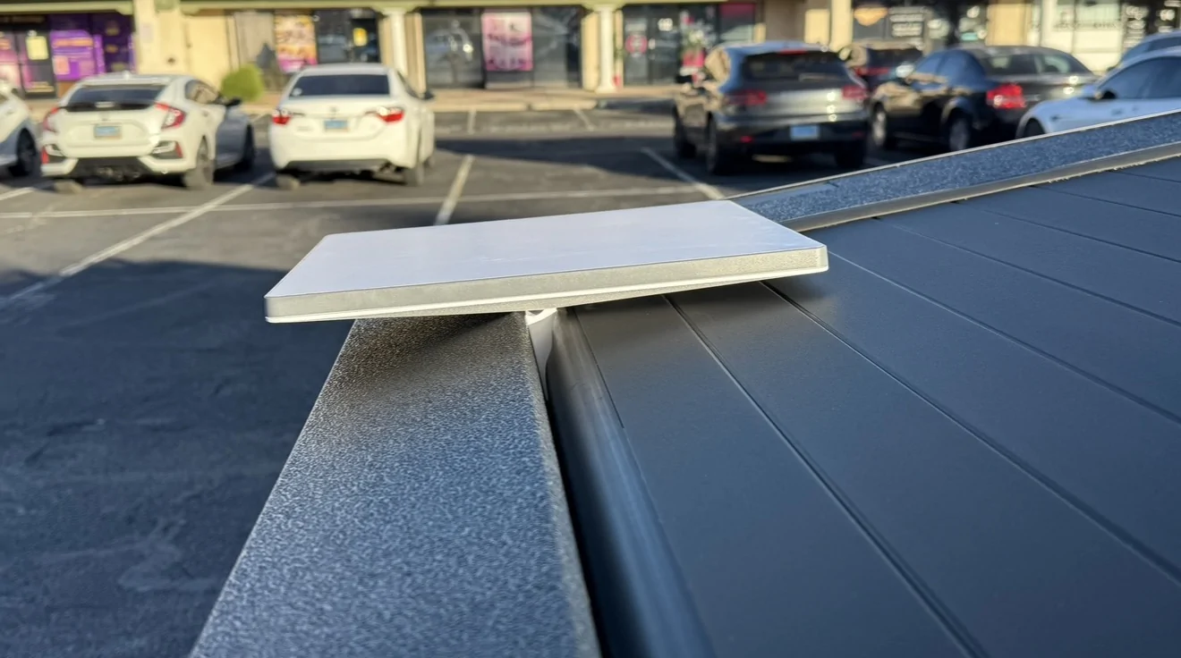

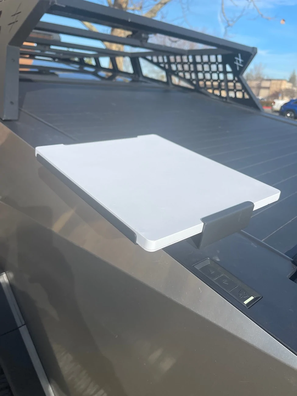

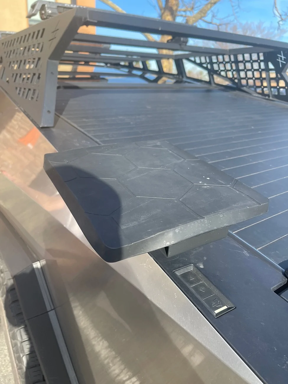

Thanks everyone for you input and ideas. Ended up finding a 3D print online that I went with. I had to modify it a bit by adding length to top otherwise it was too short to mount the mini. Original designer i think went with regular ASA but I ended up using ASA-CF (carbon fiber). I made the walls a bit thicker as well and increased the infill.

I just uploaded it to Makerworld, but the changes are under review. Here is the link to the original. If you want the updated profile with mods, you'll have to wait until Makerworld approves it or you can send me a DM with your email and I'll send the .3MF file that way. The original print was too short and would not work. I ended up remaking and modifying it from my original post here, too. Increased infill to 75%, added more wall loops, more walls, and other small changes as suggested by Grok. Definitely less flex and is extremely sturdy.
Edit: New profile was approved so you should be able to download it directly. It is the one with ASA-CF in the title.

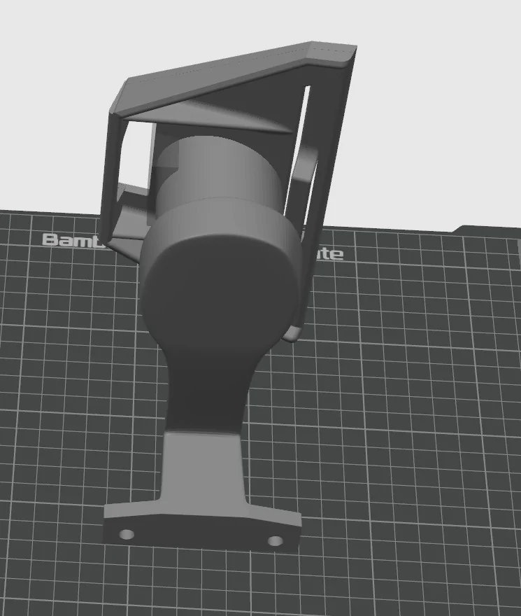

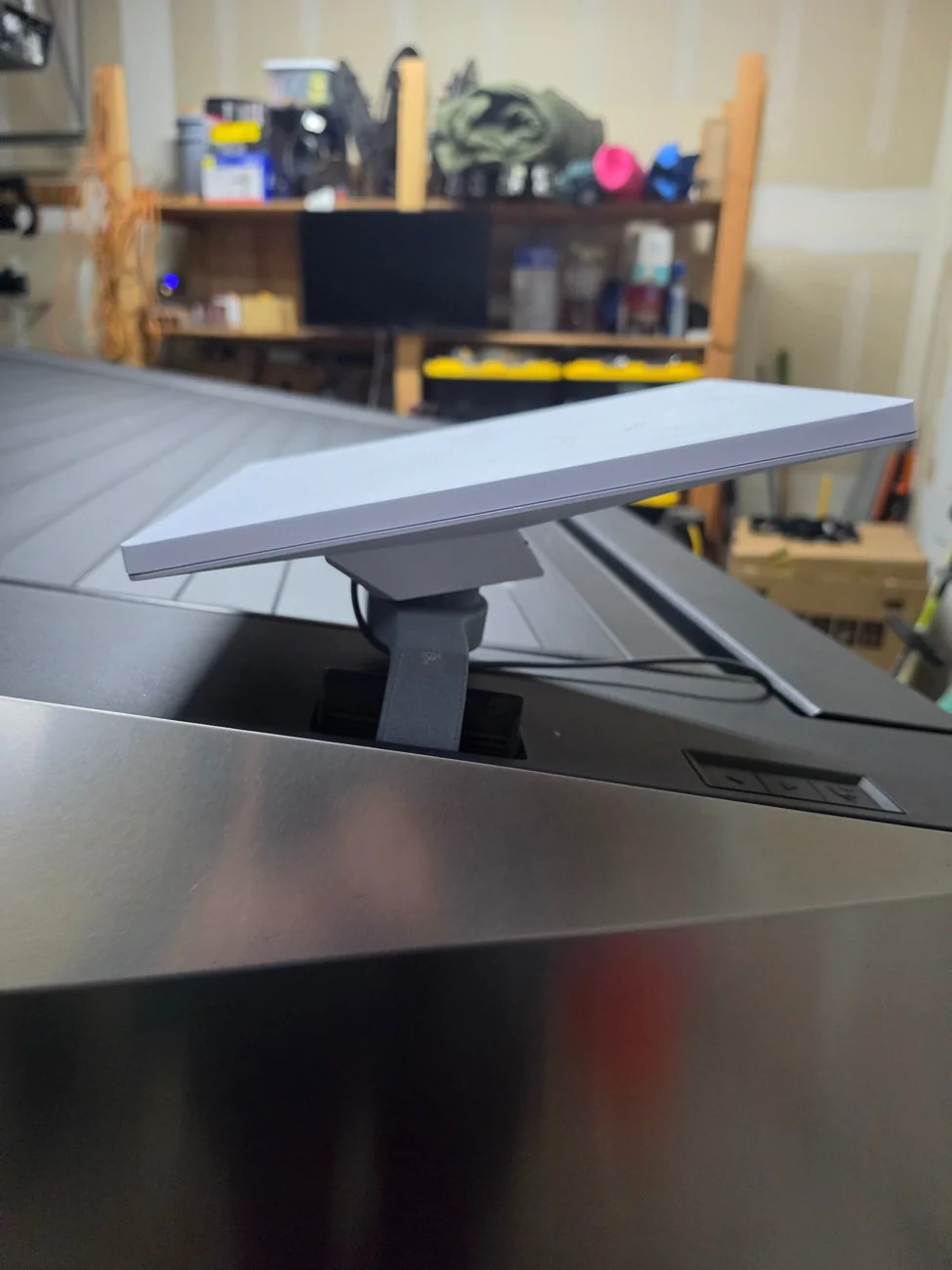

I am tinkering with merging two different models together right now. I did a test print and it fits great except for when i go to plug it in. The original mount file is too thick and too close to the plug for it to fit and the other model i merged it with is also too lose. Trying to add a negative shape so the plug will fit. also trying to beef up the actual mount itself. Anyone with a bit more experience in Fusion or Bambu Studio willing to give it a try? My knowledge/skills are still only basic right now as i try to learn.
