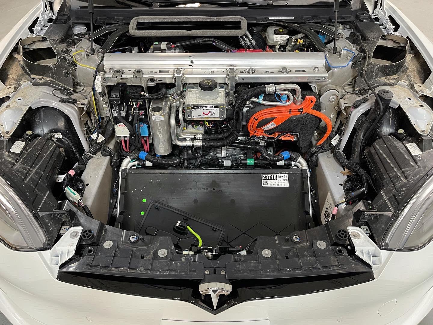

Where is the heat ejection radiator on a Tesla? It must have a fan than moves air across the radiator when parked. When the car is moving does the fan stop? Is it better when moving?
It's under the frunk, in front of the firewall.
Eventually the radiator is the weak link in the system on the hottest days of summer. I tried to see where it is was actually located, but unsuccessful. Is there an air tunnel from the grill plus a fan?

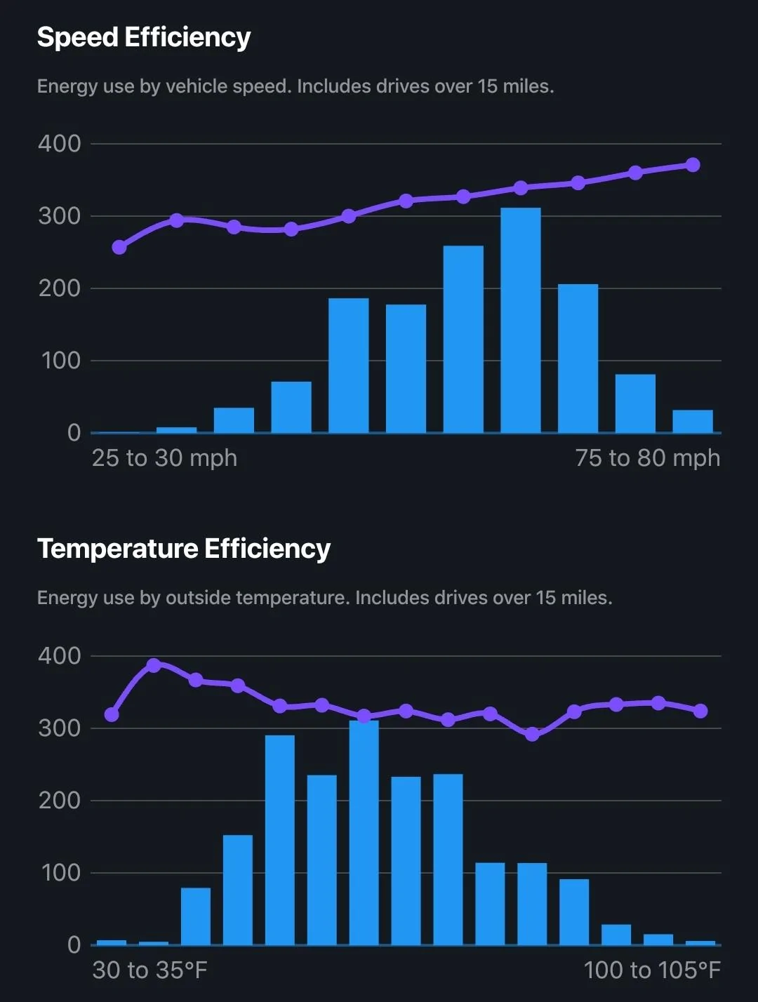

Been driving my model Y since Thanksgiving and been in below freezing and above 100° F weather, the only thing I did was buy a sunshade for the windshield to keep the seats and the wheel cool. The sun can be biting at times through the glass roof, but it's as severe as any other vehicle.
Besides that, it works just as well as any other car I've owned, even better if you precool or preheat the car with the app. Preconditioning the battery and setting cabin temperature is a massive boon for cabin comfort.
As far as battery consumption mine seems to do very well in hotter conditions for efficiency. I attached my Tessie info below. Thermally the car just manages itself well, especially with the heat pump. The Cybertruck will probably do even better with a larger cooling system managing thermal stability.
Note: I have 32,580 miles of info for reference.

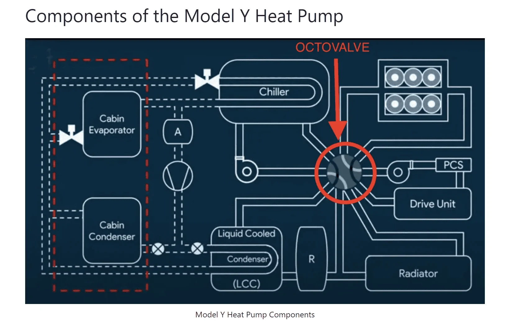

Thanks that make sense. There must be a outlet for the air. I don't see a fan on the radiators but maybe convective flow starts up when parked.
It has electric fans as its impossible to get enough airflow from convection only to cool. Would need a chimney for that. Also cooling should work better whilst driving seeing there will be more airflow and less stagnet air around the cooler that can build temperature.
The air inlet temperature of the Tesla radiator is the same as on a ICE as it gets fresh air in both cases. Both my Prius's have electric heat pumps, in fact most A/Cs in ICE still use a compressor, its just that those aren't reverse cycle for heating as that comes from ICE waste heat instead.

Thanks CG, whats the purple line?
