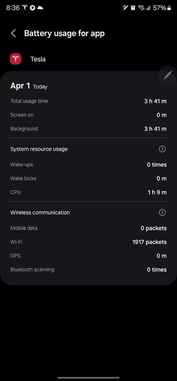

Turning off UWB dropped app power consumption to near zero on my S22 Ultra.
(No actual vehicle driving in that time period)

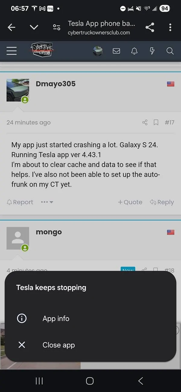

My app just started crashing a lot. Galaxy S 24. Running Tesla app ver 4.43.1
I'm about to clear cache and data to see if that helps. I've also not been able to set up the auto-frunk on my CT yet.
Auto frunk needs UWB turned on (update phone key) and the option enabled in the truck settings (2025.2 or later).

Literally just got done clearing the cache and data, and re-setting up the phone keys.... And this happens:
Try turning off UWB.
No autofrunk, but it may help
Edit: also force stop the app, or reboot phone

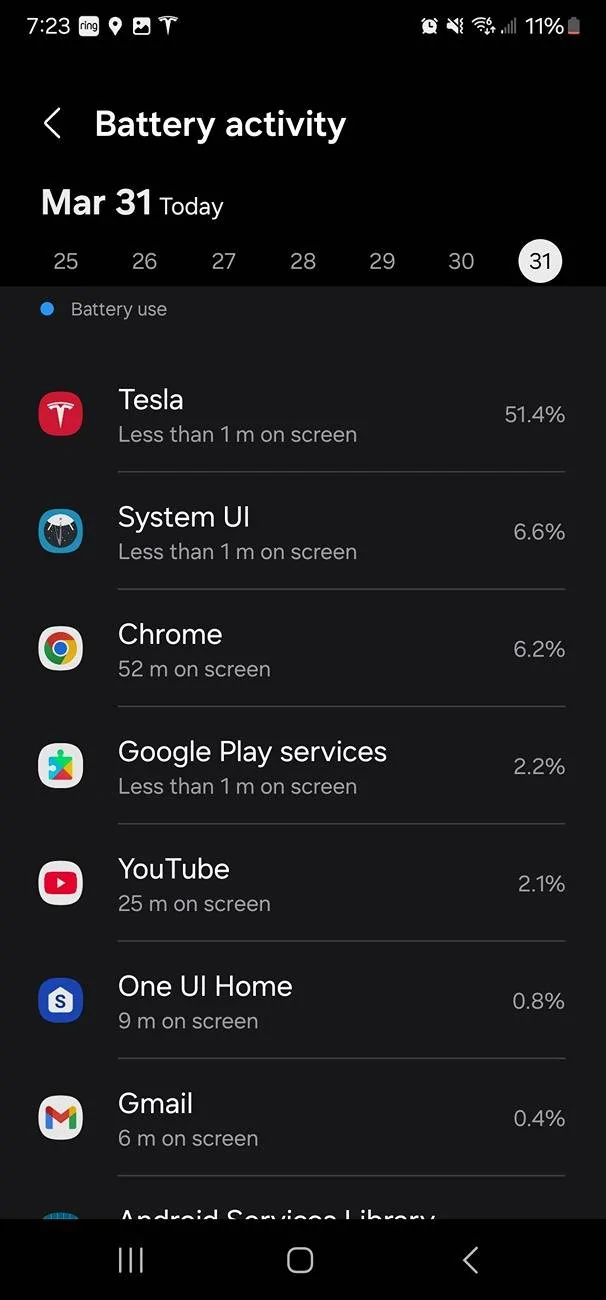

The last few days, my battery has been tanking a lot faster than normal. I looked at what apps are causing it and since the 28th, Tesla app has been going crazy. Anyone else?
Last 4 days, it has accounted for most of the daily battery usage percentage by far.
25th, 26th, 27th - 2, 4, 1%
28th - 28%
29th - 19%
30th - 32%
Today - 51%!!!

Android, Samsung Fold 4. Tesla Model 3 LR (refresh)
Tesla app won't even load, Android asks "wait, or close app?", and the app is somehow wakelock'ing the phone to stay chewing battery for HOURS o_O
Battery maybe lasts half a day and Tesla app is 20-30% of the drain within hours.

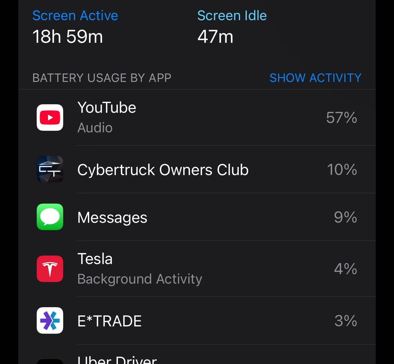

I couldn’t find a toggle in the settings of my iPhone 16 Pro that has the latest iOS to turn off UWB. So I asked ChatGPT and discovered that there isn’t one, but there is a way to turn it off, but it also turns off a lot of other things along the way.
here’s the response and additional information that it offered, and I accepted (a long one)

I have a Samsung s25 ultra, a Cybertruck and model X. Both cars had several updates to the software over the last couple of weeks and I currently have 2025.32.8. Two days ago, my phone battery died by 1:00 p.m. and when I looked in settings I found that the Tesla app was the culprit training 66% of my battery. I keep my phone on the charger overnight and unplug it around 7:00 a.m. to 8:00 a.m. so the Tesla app is draining my battery in just a few hours. If I can't figure out how to fix this, I will have to uninstall the Tesla app which would make me want to sell my cars!

Solved: I had to uninstall the app and reinstall from the Google Play Store. I believe the app failed to update and as soon as the new version was installed it stopped draining my battery.
Previously I tried logging out and logging back in again and other things but nothing worked until I uninstalled the app and reinstalled it from the Google Play store.

Definitely the App draining the battery. Here I thought it was my screen brightness and I kept turning that down.
Uninstall the app and reinstall from the Google Play Store
