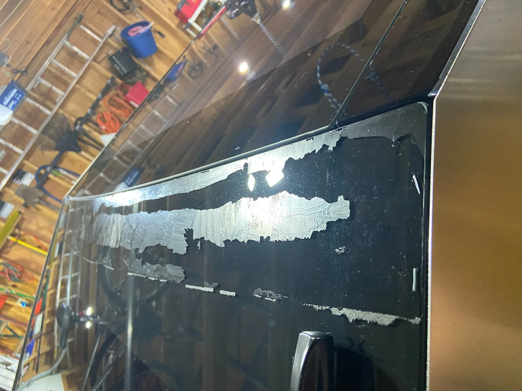

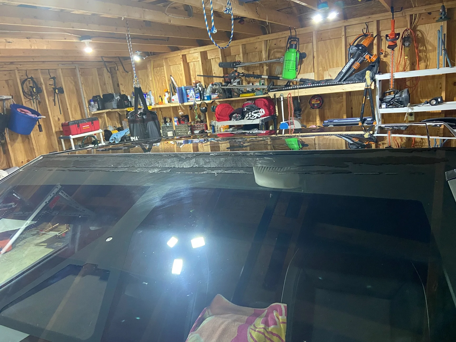

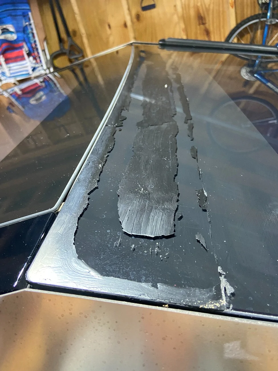

Be careful folks, had mine installed also, two months later it flew off (glue separated
in the middle of the bead, some left on glass & light bar) while on the highway. My beast is garage kept, and few long trips. See pictures

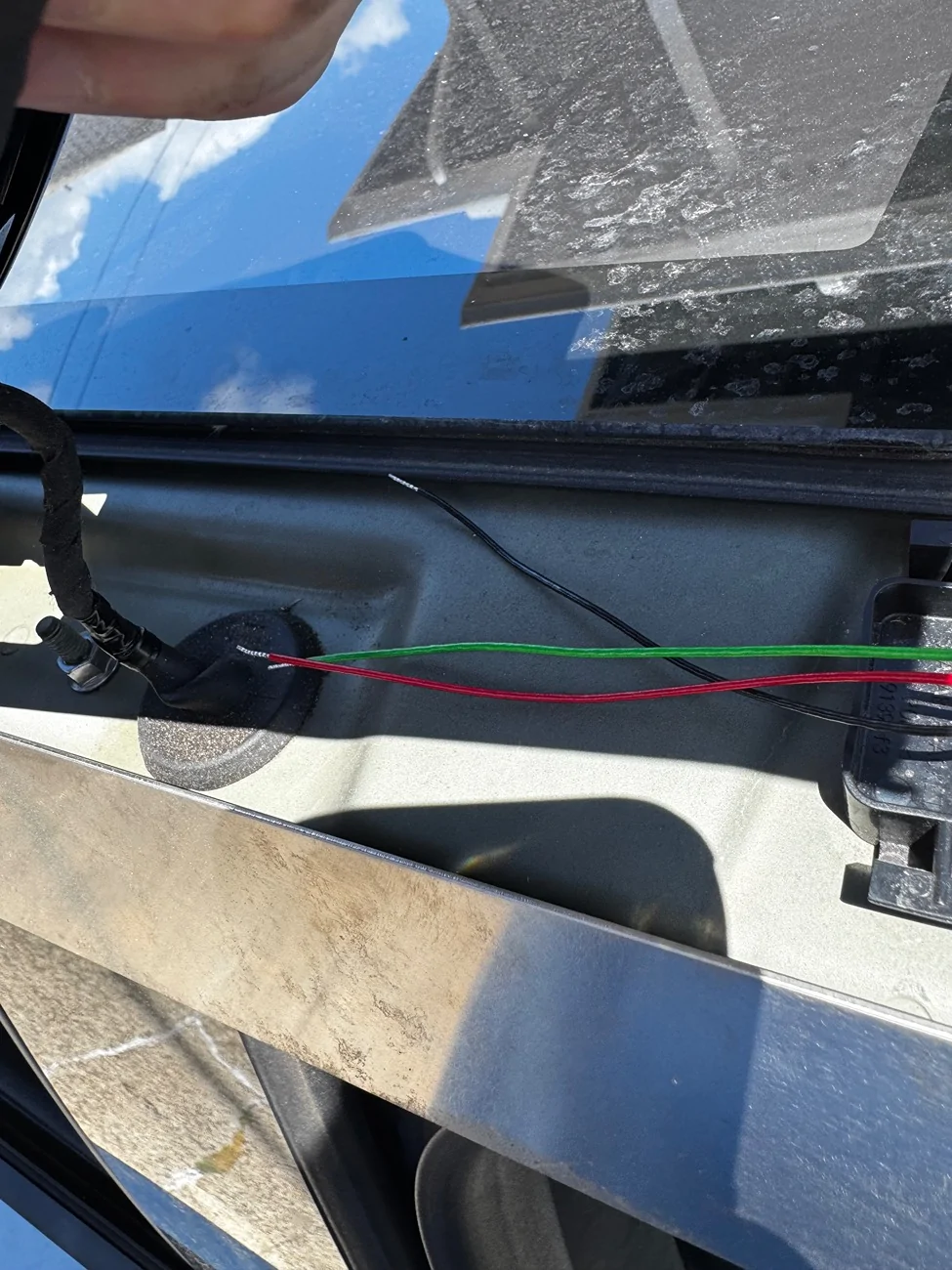

No instructions on how to connect it, so I opened up the side panel to find that Tesla Service had already made the connection, something they are not allowed to do:
Service didn't connect it. Early gen trucks came with that connected and capped wires up top . First gen instructions left soldering to owner. Second gen instructions had the service soldering and disconnecting the connector.
Later lightbars came with a connector on the harness, no soldering needed. It replaced the pigtail.
what a mess, will this be covered under warentee?
What about last week lightbars. Are you saying it's an early lightbar? There was no connector on the lightbar, just three bare wires.
Same, installed two weeks ago and service left me with the three bare wires, no soldering or connector.

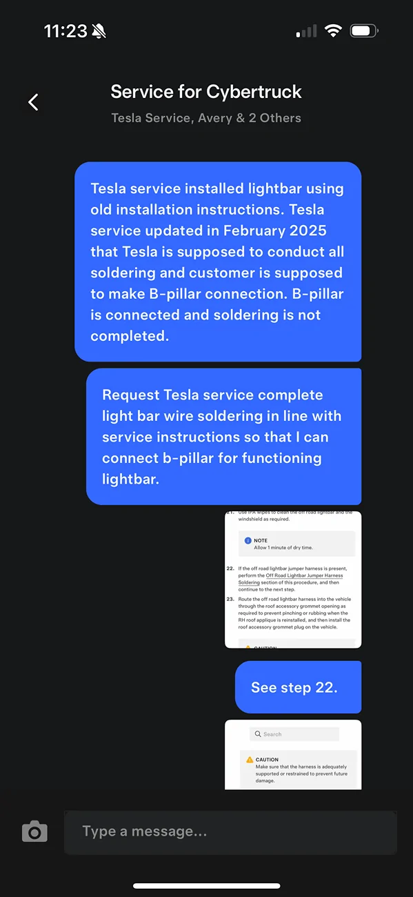

so this was the phase one light bar, they should had given you a packet and install instruction, and 3 wires with a plug on the end that you would have to solder and insulate. phase 2 light bars that came out in Feb along with the new adhesive, have the plug on them and all you have to do is remove the passenger's side B Pillar Camera cover with a 10mm and plug it in, i would ask for the wiring kit with the plug from the service center.
Oh I did. And they have been going back and forth. I’m the first one installed at this service center.
