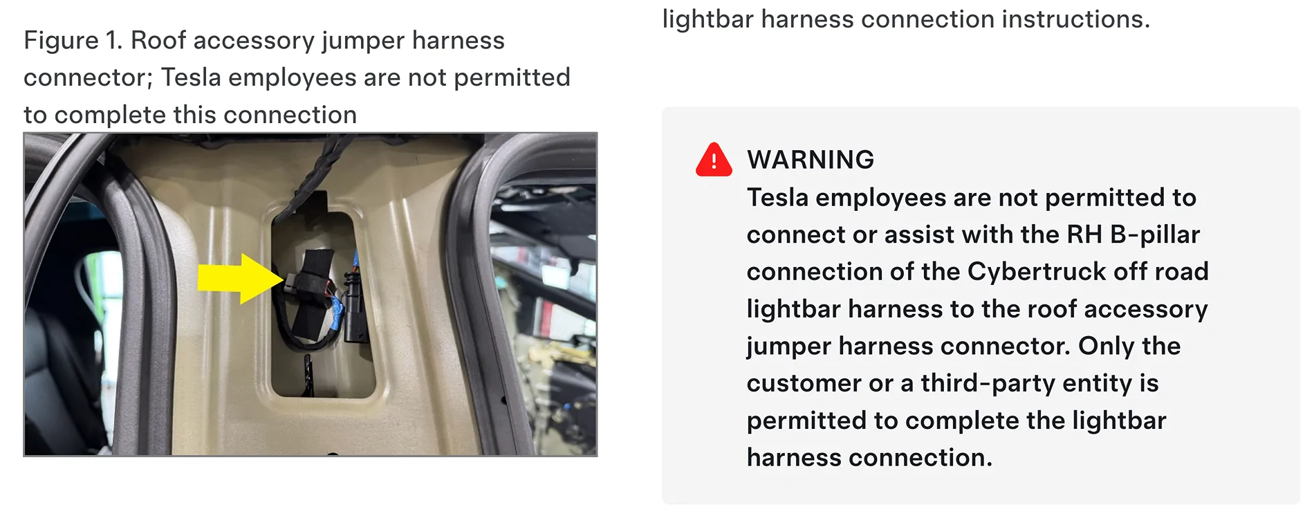

After an 11-month wait, I finally got my lightbar installed.
No instructions on how to connect it, so I opened up the side panel to find that Tesla Service had already made the connection, something they are not allowed to do:
Tesla Cybertruck Tesla Lightbar delivery & install experience Screenshot 2025-08-15 at 7.30.05 AM
So I put the side panel back, and tried to power up the lightbar. No dice. Tesla Service didn't make the solder connections above the cantrail, leaving the difficult part for me to do, and going against the instructions above.
So I found all the wires, at the top, in two bundles. The one that goes down the side panel had the wires all touching. So by making the connection behind the side camera could have been a huge problem when I turned on the power to the lightbar. So I made the solder connections, and used the heatshrink tubes they gave me (which were too large). It worked, and the light works, but I'm not happy with the placement.

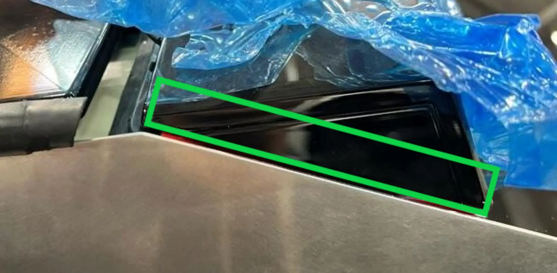

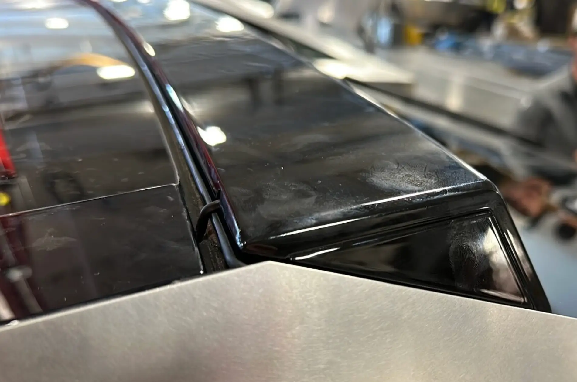

The Service manual says to mount it like this, flush with the sunroof, for a clean look:
Tesla Cybertruck Tesla Lightbar delivery & install experience Screenshot 2025-08-15 at 7.29.13 AM
Tesla Cybertruck Tesla Lightbar delivery & install experience Screenshot 2025-08-15 at 7.39.21 AM

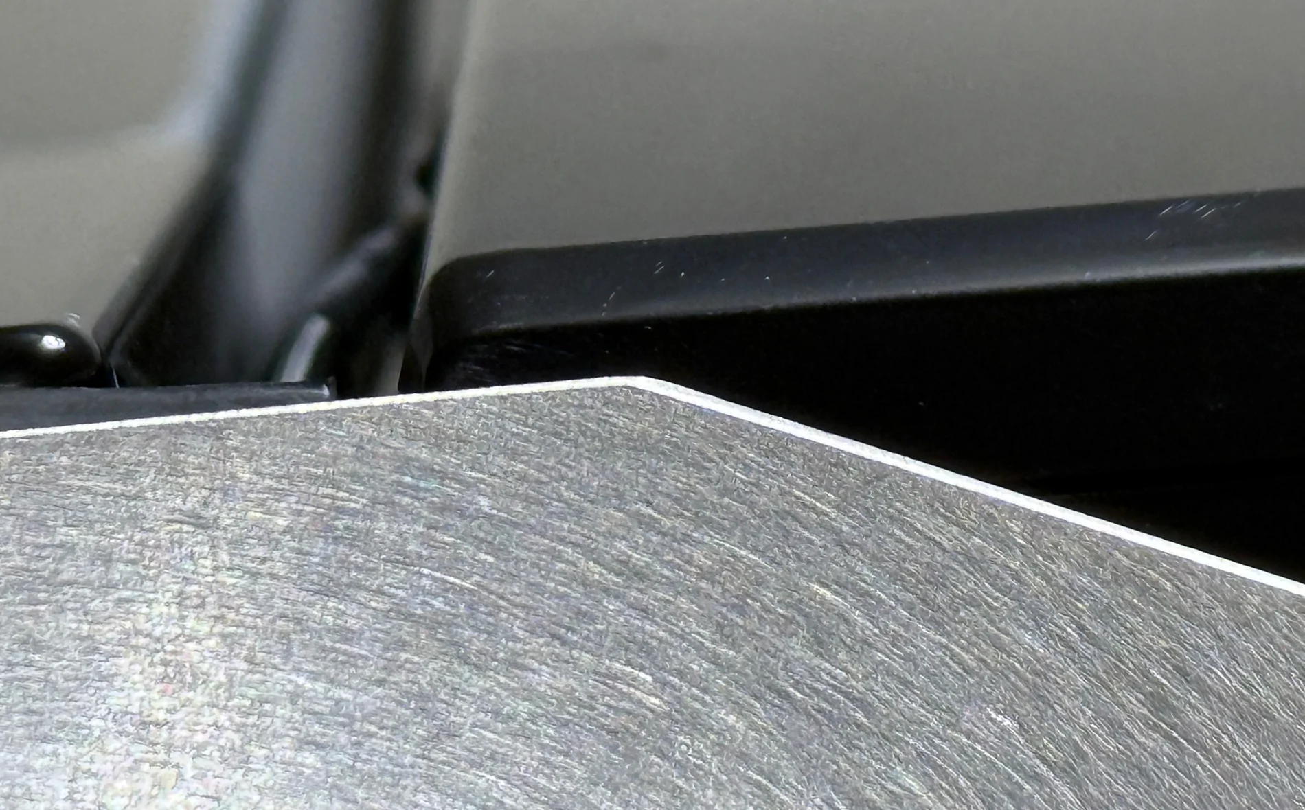

They mounted it like this:
Tesla Cybertruck Tesla Lightbar delivery & install experience 1755258539948-qm

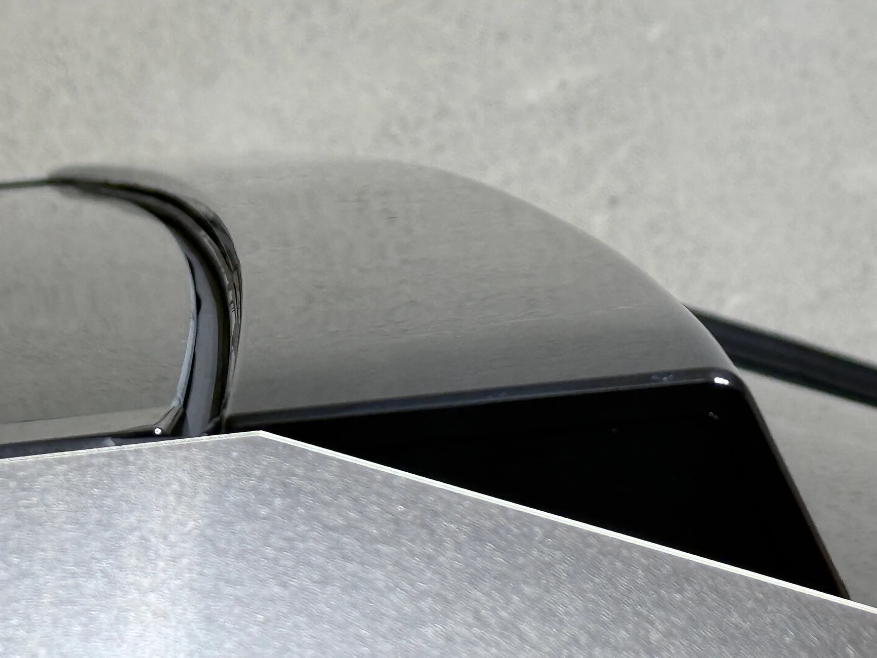

Which results in the lightbar floating above the sunroof by about 5mm or more:
Tesla Cybertruck Tesla Lightbar delivery & install experience 1755258591414-ml
This results in noticeable wind noise at higher speeds, and poor aerodynamics.
