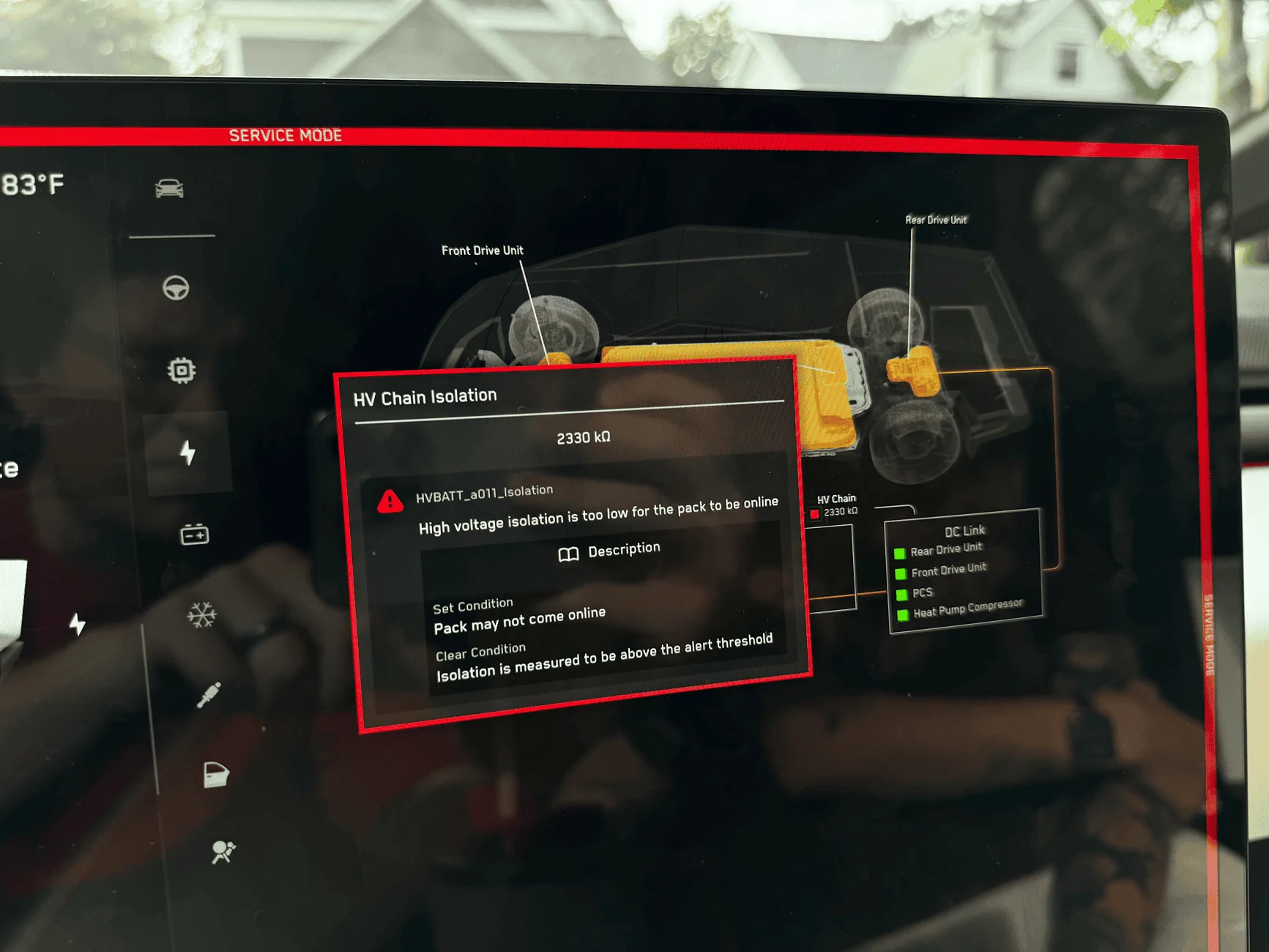

While pulling out of my driveway tonight for a road trip for the holiday weekend, my truck displayed and error saying "Vehicle may not restart. Service is required." The following error codes appeared;
  1. HVBATT_a011
  2. HVBATT_a122_IsolationDegradation
  3. RSAM_a134_LPSError
  4. VCREAR_a117_VCFRONT_MIA
The truck still drove normally, but I turned around and parked in my driveway. The truck then shut down most systems with an error saying it could not support all onboard electronics. (this is a safety feature so Teslas with current leakage don't electrocute people)

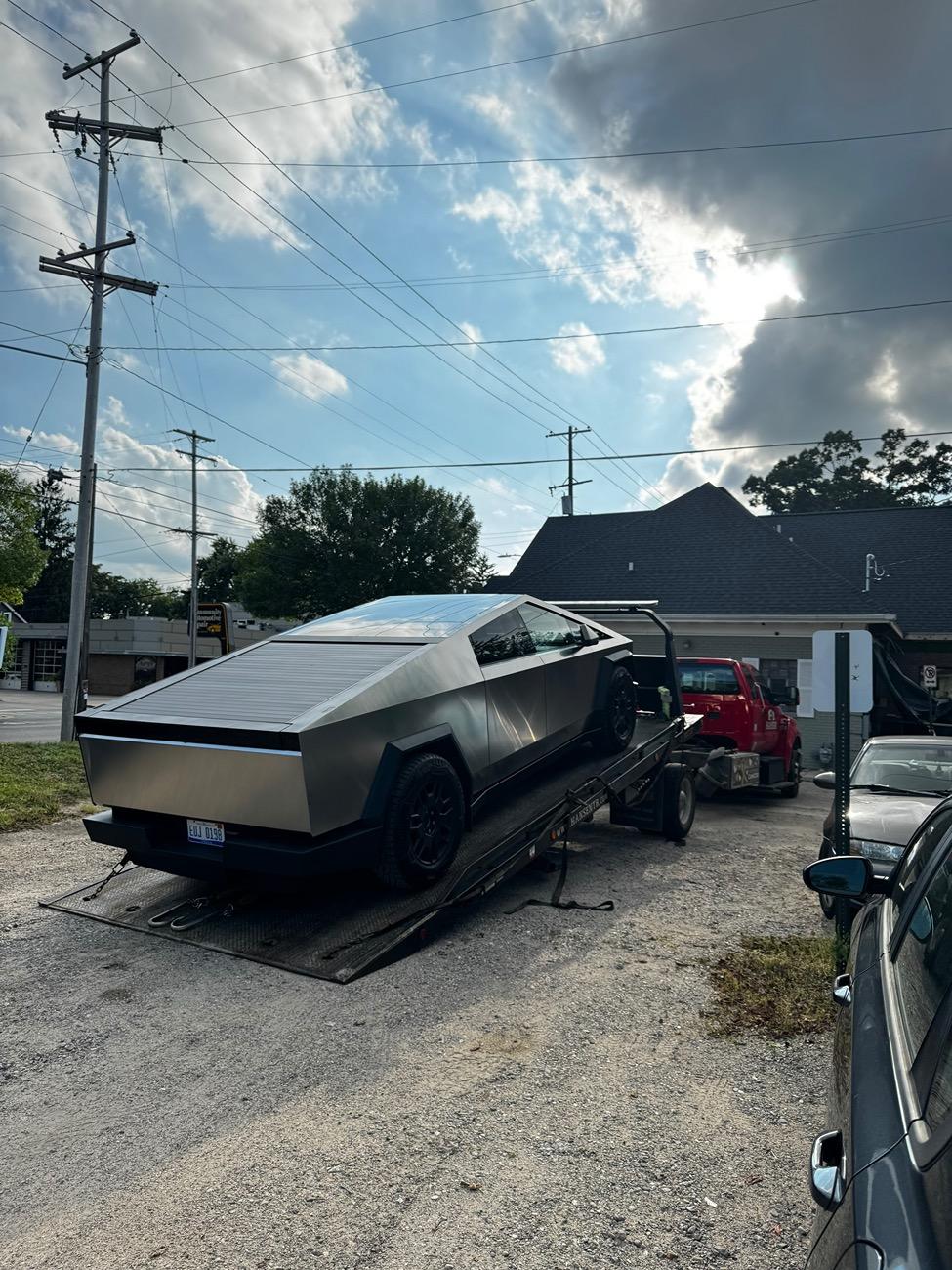

I called Tesla Roadside Assistance, and they essentially said: Whatever you do, don't drive it anywhere. They sent a tow truck and brought it to my local service center a few miles away (Grand Rapids, MI).

After reading other stories of Isolation errors on other Teslas, I have some speculation on the problem on my truck. Isolation failures are most commonly found in the motors, HV connectors, inverter, and HV cables. It's possible my truck has a cracked connector or unseated water seal (any range of issues can cause this, including a bad factory assembly). Any water ingress will cause a jump in current from the connectors/wiring to other areas of the truck. In any case, it shouldn't have anything to do with the high voltage battery itself, but rather the wiring surrounding it.

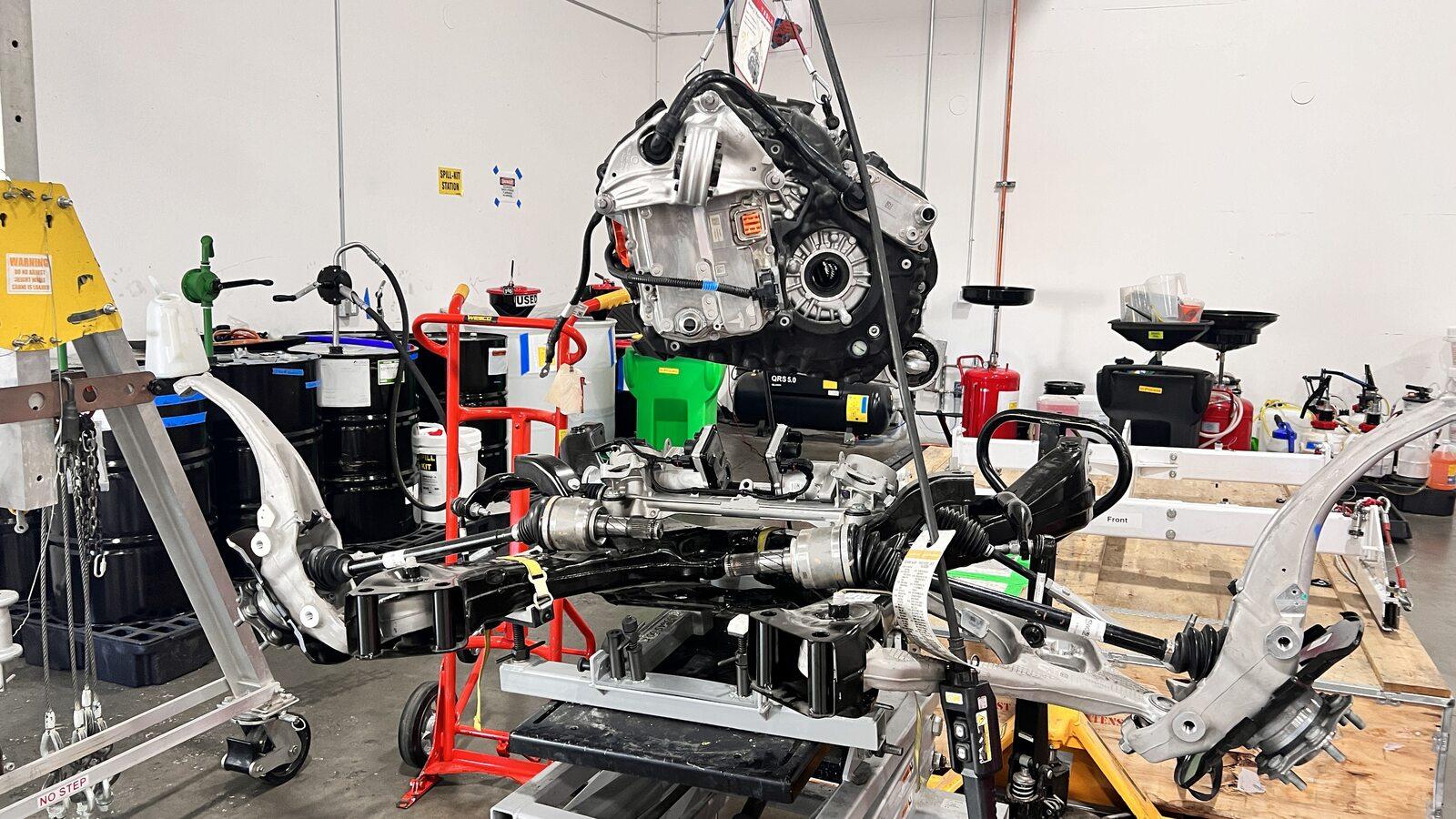

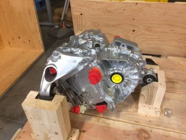

Tesla has identified my Cybertruck's issue as either the front drive unit or the front drive unit's inverter.
Usually, these parts have to be shipped in from Texas, special delivered on a pallet / crate. Sometimes, these shipments can take weeks.
Installation, according to the service manual, requires the complete removal of the front subframe, draining of the coolant system, disassembly of the front facia and frunk, front suspension, and more. It takes... a long time. (photo below of part of the disassembled Cybertruck & motor).
