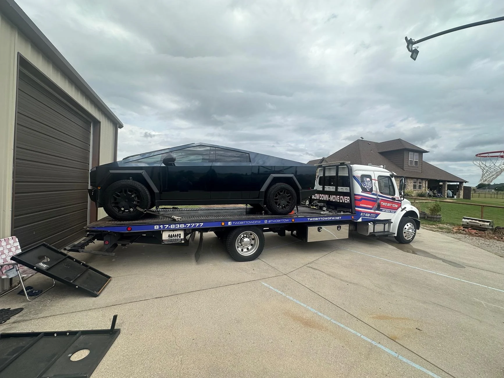

Woke up this morning to an alert that my Truck stopped charging at 75%. Didn’t think much of it until I tried to go to work and the truck was completely dead. Contacted support and they asked for it to be towed in to run diagnostics on it. Tow companies are very unfamiliar on how to tow a Cybertruck so that process took a few hours while they spoke to Tesla directly. Hopefully it’s repaired quickly.

Agree it shouldn’t have taken a few hours. I was at work and you would think Tesla would send a tow company that knew how to do it.
