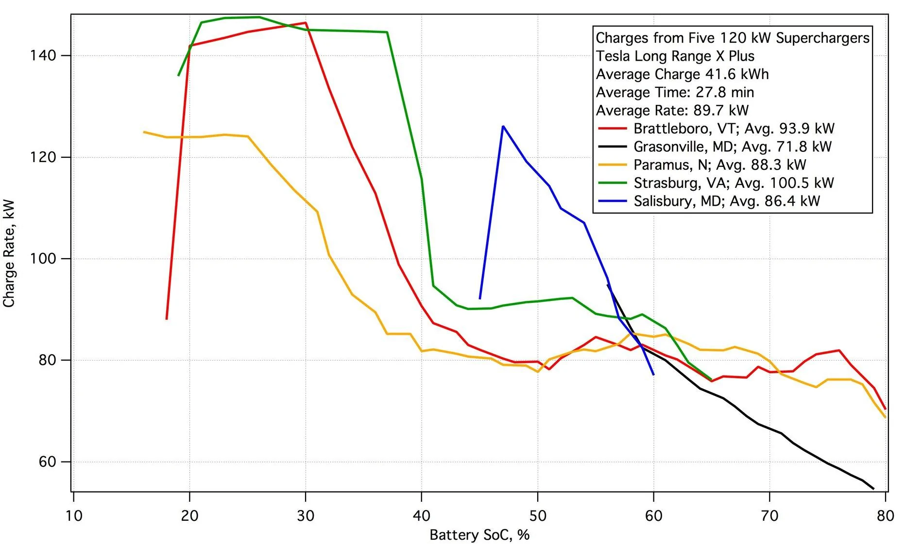

Tesla website says the V3 supercharger will provide up to 1000mph of charging rate, but we all know when the battery is full, or close to full, that rate of charge will become very low. So what is the happy medium? Charging rate (therefore range) vs. wait time.
Also, the charging rate presents by 1000mph is very misleading, too. if CT has larger battery capacity, the same KW charging rate will certainly not going to get CT to 1000mph rate. <=== agree /not agree???
Anyhow, with your experience, if you start the charge at around 20%, what do you expect 15 min later? Same question for the more common V2 supercharger. Thanks,

The charging rate you will realize will depend on many factors. Starting SoC of your battery is one of them but so is your battery's temperature (if you have the Nav system on and the car senses that you are approaching a super charger it will condition the battery temperature to be optimum at the time of arrival) and what's going on at the charging station. Here are the histories for the 5 charges I've done on my Raven X:
Tesla Cybertruck Tesla Vehicle Questions, Answered Charges
As you can see charging is most rapid when the SoC is below 30 to 40% at onset. The thing I found most interesting in these curves was that early on the rate of charge was appreciably greater (by 20 -25 kW) than the rated rate of the station as given on plug share. But note that this was at stations that were not occupied (I was the only car there). At busy Paramus, NJ, the initial charge rate was at the stations rated 120 kW. The other general message from these charges is that the rate slows to about 2/3 of the station rating once SoC passes 40% though it may start sooner than that (as low as 25%). Note also that the charger will taper the rate further as the end of the charge (determined by what you set as the desired charge limit) is reached.
Of course you must understand that these example are just that, examples and that you can't draw global conclusions from them. Nor can you predict exactly what charging profile you will experience when you pull into a station except that if it is very full it is going to take longer than if it is empty or nearly so.
These example data and the charging instructions Tesla gives make it clear that if you want to spend minimum time with a charging hose stuck in your car you don't charge above 40%. This, of course, means more frequent stops so you must consider in making your plans that there is some overhead time involved with a stop. How far is it off the freeway? Is it well hidden behind some warehouse in the shopping center (some are). Is your SO likely to wander off to an adjacent antique shop?
With a little experience I expect you will find that charging stops aren't much different from fueling stop in an ICE vehicle. "We're getting a bit low. Should we stop at Paramus or see if we can make it to Newburg". "Are you sure we have enough for Newburg? I really like that little ___ store there. "Yea, but I gotta pee." is usually how the conversation goes.
Tip: try not to think of SoC in terms of miles. That's because the miles per % SoC can vary appreciably depending on whether the road is wet, you have a tailwind, or the upcoming terrain is hilly. Have an idea as to what SoC you want at your next stop and determine how to charge based on that.
Play with ABRP.
Disagree. That's one of the reasons its better to not think of SoC in miles. A 140 kW charging rate will load 140 kW in an hour. If I am burning 400 Wh/mi that rate will be equivalent to 140/.4 = 350 miles added per hour but if I am burning 500 then it is only equivalent to 280. Note that this has nothing to do with the size of the battery. Of course it is true that a car with a bigger battery pack will weigh somewhat more and hence burn more Wh/mi but the increase is not going to be that much because battery weight is only part of the vehicle weight and because the mass related loading in a vehicle with regen is less, relative to the whole, than in an ICE vehicle. This a 33% increase in battery weight might only translate to a 5% increase in Wh/mi.

@ajdelange: One of your record started at about 45% and was able to sustain a charging rate above 100kwh all to way to SoC close to 60%. so, do you think if you disconnect/reconnect charger when you see the rate comes down (like those red curve at around 35% SoC, for example), will you be able to shorten the charging time? Worth doing it all the time?
ajdelange
A. J.
Dec 8, 2019
3,203
3,409
Virginia/Quebec
EE (Retired)
I don't know the answer to that question but I'm guessing that it wouldn't change things much. The rates you get are the result of a negotiation between car and charger. I have started a SC charging session only to terminate it two minutes later and resume it in another stall. That was with my older car and so I no longer have the records but I doubt that it would change anything. The actual charge rate is determined by what the car wants as modified by what the charger can give. What the car wants is to charge your battery in a way that is not detrimental to your battery. I believe it would see through your trick and simply resume the same profile.
That particular profile clearly doesn't look like the others. The car is taking on power at a higher rate than it normally does at SoC levels this high. I suspect this is because the car takes into account that this was clearly a range anxiety top up of only 15% and allows, therefore, the higher than usual rate knowing that it won't take long. But that's a guess.
