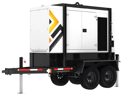

A portable DC fast charger like the Lincoln electric 50KW requires an additional 3-Phase 480V generator to supply it. Both should be able to fit inside the storage of trailers this size. How much is Evotrex’s optional RangeBoost system?
What 50kW genset fits in a trailer?
A Model 3 pack plus a couple modules gives 70kWh of fast charging at ~1,200 pounds along with DC fast recharging. Could theoretically direct link too...
Are there any companies selling tesla battery packs and inverter + PDU to do this? That gen includes a trailer and fuel tank, both of which aren't needed. Gas/Diesel is so much more energy dense and easier to obtain nearby in those remote locations to continue your trip. If you're stopping at camp sites, I suppose you'll just use the 120V or 240V RV outlets anyways?

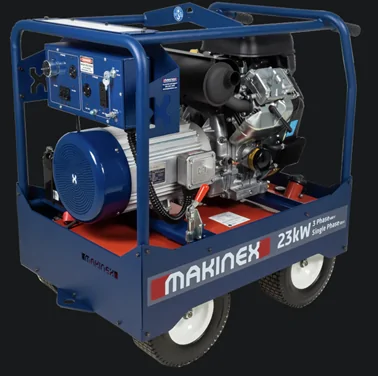

Something like this would fit in most trailer storages or in front of the trailer frame:
https://powergenusa.com/products/makinex-23-kw-480v-generator ($18k)

That's a pretty dense generator. It still takes 5 hours for a full recharge though.
