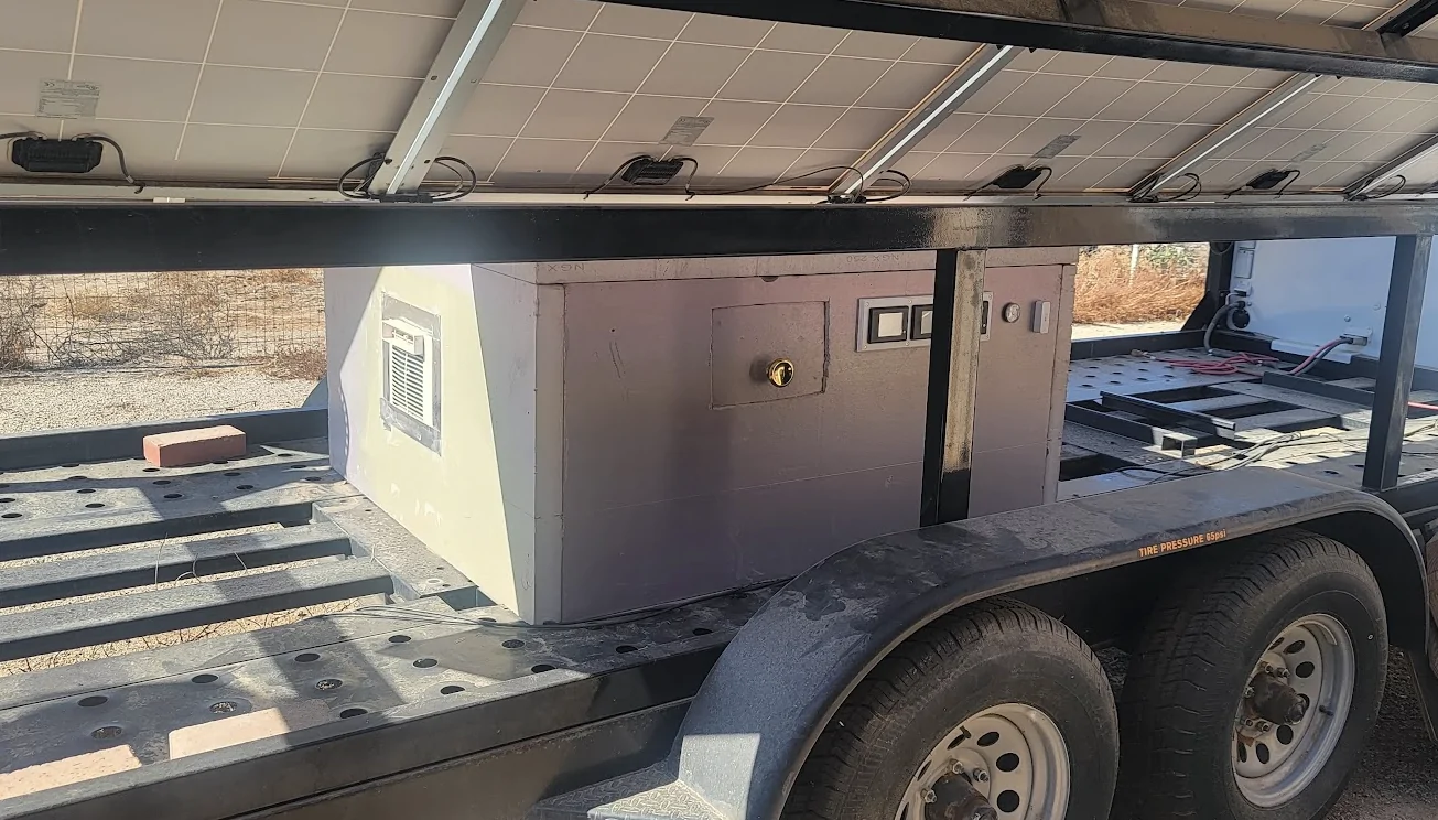

I was actually asking about "TMS" (Thermal Management System), not "BMS" which is, necessarily, built in to essentially every LFP on the market. Even if the battery is rated to operate at 140F, it will incur significantly faster degradation at higher temperature (per Arrhenius Law) - this is why almost every EV manufacturer (*) has turned to active thermal management. It doesn't have to be liquid cooled like most EVs for the sustained power levels needed here, but simply making the battery compartment climate controlled should make a huge difference on long-term reliability.
(*)Nissan Leaf being the exception. I have replaced the battery in my Nissan Leaf twice now with just over 100K miles. Second time was on my dime. Perhaps why I am particularly sensitive to this subject. :)
FYI, it doesn't have to be expensive or heavy. I bought a couple of the solar trailers that went to auction. Immediately recycled the Lead-Acid and replaced with same capacity LiFePO4. This was my <$300 TMS. Cheap but works great:

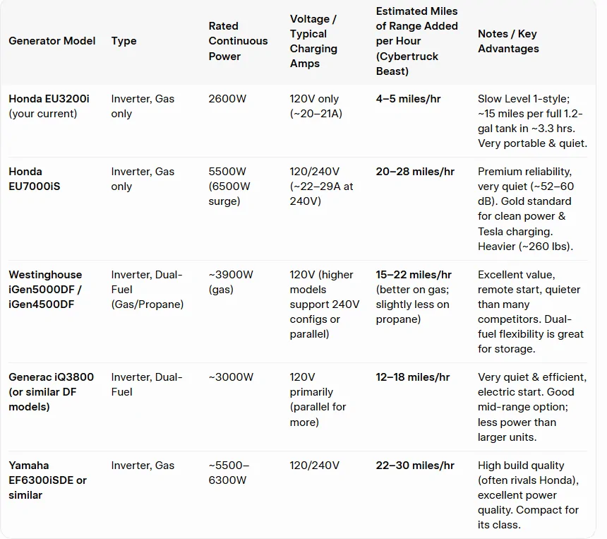

I do the same analysis, tow a Casita RV (3,500 lbs) and looked into DCFC and decided the cost, weight and range is ridiculously a non-starter compared to a gas generator. I have a Honda EU3200i for $2k that can get me 15 mile range on full tank of gas (3.3 hours). I don't use it except in emergency, and if I wanted to get a 5-10 gallon container and run all night at a boondocking setup it would provide all I need. There are level 2 generators for less and more range. Grok produced the following table:
How about iGen8200TFC or the iGen11000DFC?
