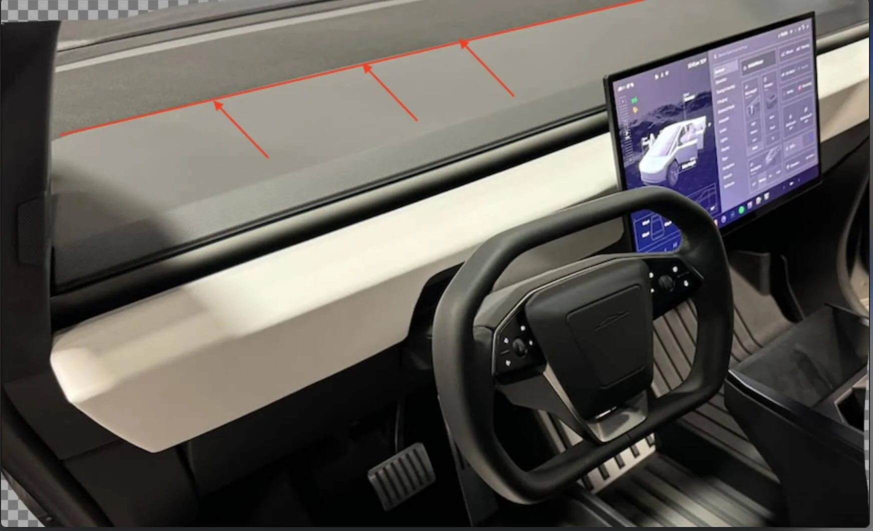

I "may" have isolated one of my last rattle locations. Still one to go after, but this for sure is the area as I can press down or lift up with my finger and it stops. Right where the long red straight line is, arrows pointing towards, that part lifts up, can get a finger under it, or press down, and rattle stops.
I'm going to maybe put some weather stripping just under it and I think that'll solve mine.

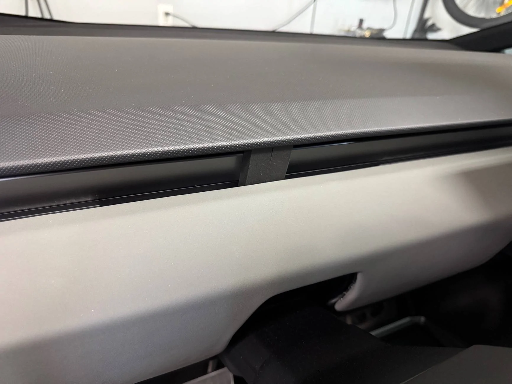

I 3d printed some rubber isolators to slide along the dash to help identify the rattle. I could have sworn the rattle was coming from the airwave because moving the blade all the way to the left or the right seemed to alleviate the rattle for a bit. Still, after sliding my isolators around in different locations, it appears to be coming from the grey plastic trim piece and specifically directly inline with the steering column. I didn't want to replace the airwave unless absolutely necessary because I feel like that will create more rattles from them removing panels and installing the new parts. With my isolators in the middle location, I've forgotten about the rattle, so I guess they are going to stay there for now.
