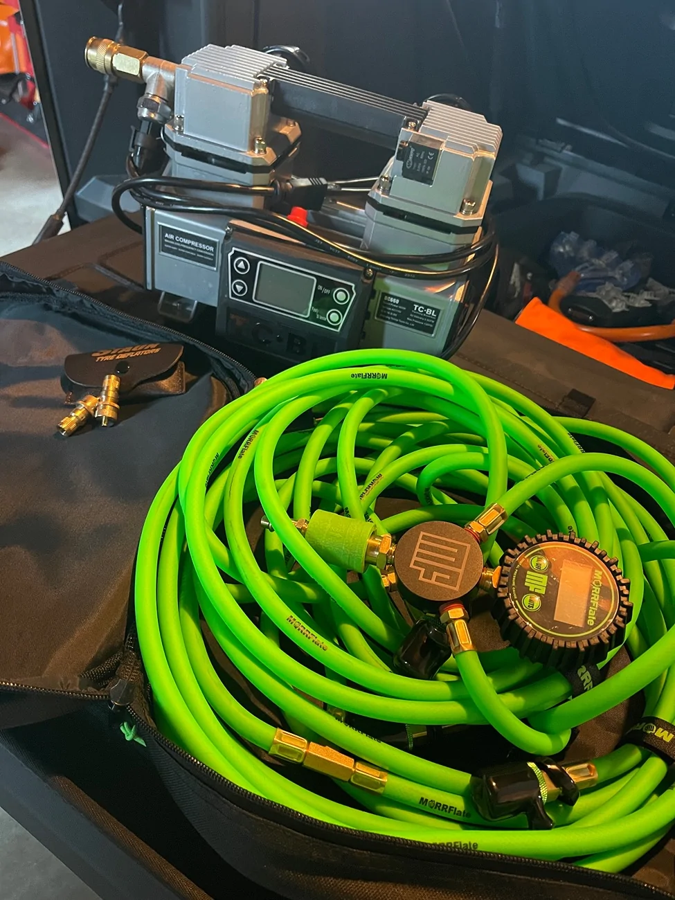

To be clear, the TC-BL can inflate one tire at a time too. I'm unfamiliar with the term "chocking" used in this context. I recommend the TC-BL be used on it's 50% power setting when inflating one tire at a time, and that works great, it's just that an inflator this powerful goes mostly to waste when inflating only one tire at a time. You could also leave it on 100% power but you would waste energy and put unnecessary load/heat on the motor and pistons.I got this big compressor that supposed to hookup to the 12v battery directly https://a.co/d/b5d9tN1
And then a power brick to power it through the 110v https://a.co/d/4qySkBs
It works nicely, and as compared to the haulingass’ compressor it could work each wheel one by one without chocking so no need for 4tire inflation system.
it is a pain to find a good compressor for a CT, I went through a few 110v ones myself and none of them were perfect.
Although that compressor may be available for a few less bucks, the savings are rather insignificant. Especially considering that you still need a power supply (since it can't run on 120V).
It also has the unusual/odd design choice of putting the air intake filters right on top of the cylinders, where it not only nerfs the ability of the compressor to radiate heat where it needs to, it also pre-warms the intake air unnecessarily. The TC-BL comes with cold air intake filtration. It also has two speeds and it's going to be more efficient with it's built-in rectification of the AC supply current.
