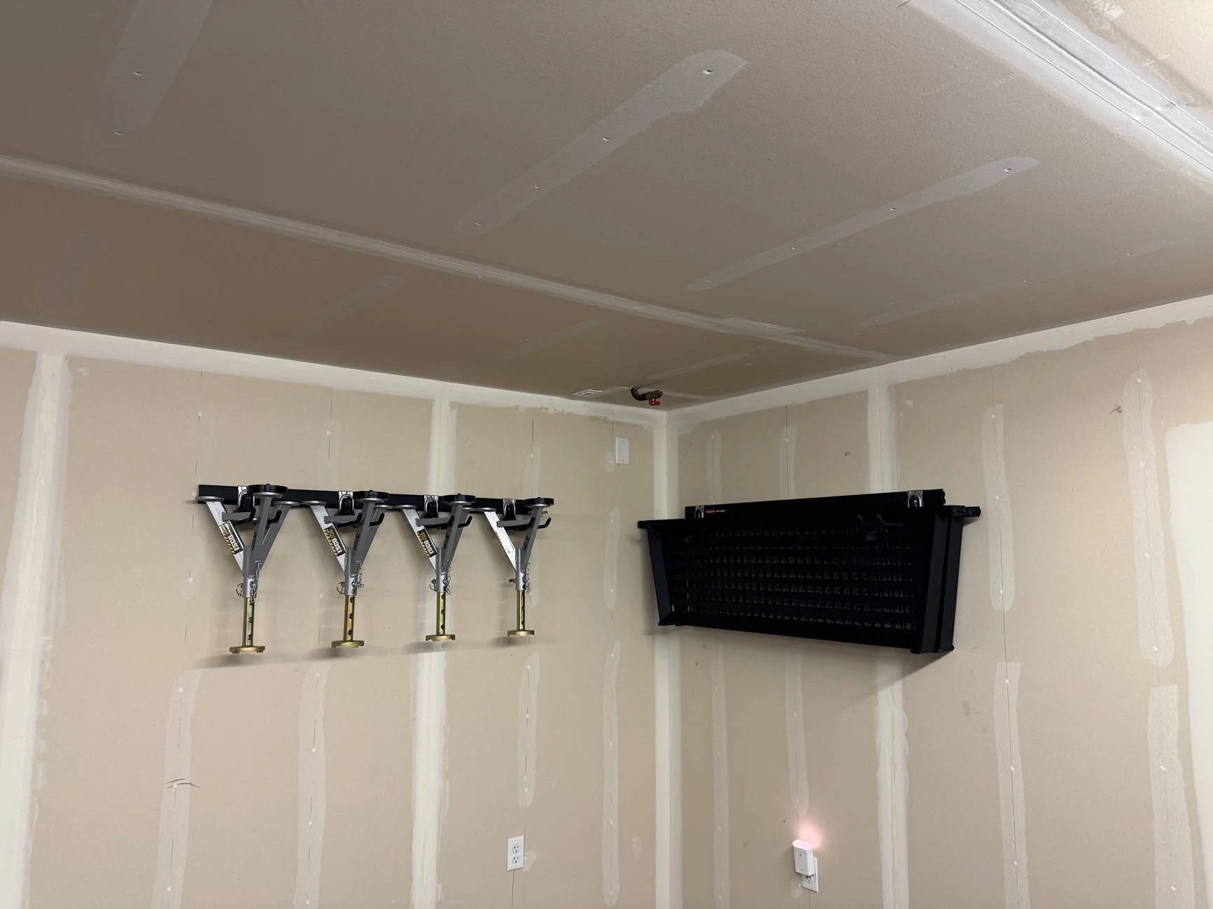

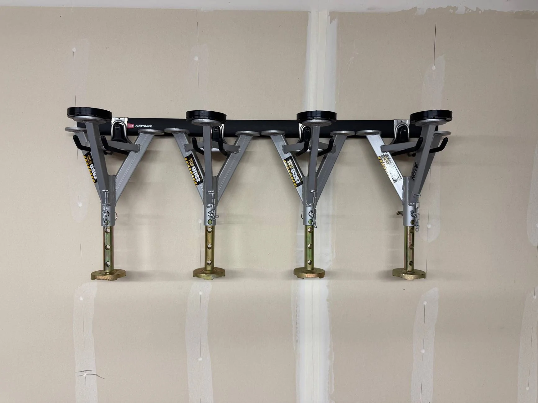

The jack stands store great on some FastTrack rails. I just leave them at the height I need for the truck because it is the only thing I use them on.
