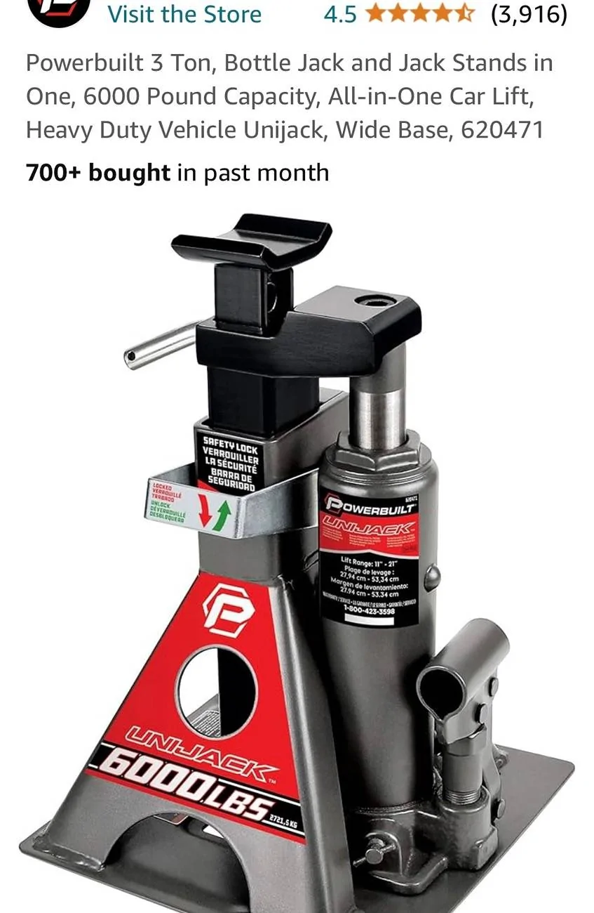

I’ve been using 2 of these bottle jack stands. Perfect since you can set to higher height. I’ve rotated twice so far with no issues. See image:
Tesla Cybertruck Recommendation for DIY tire rotation equipment? IMG_0071

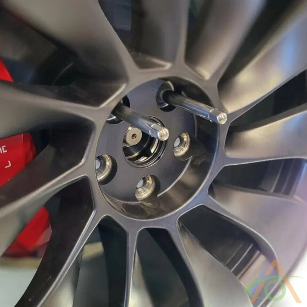

I purchased a spare tire/wheel and have been using it to get some wear on it and rotate with the OE wheels. I struggled the first time because the wheel/tire set up is HEAVY (about a hundred pounds) and it is difficult to align that much weight precisely onto the lug posts. I discovered this product which made the job way easier on my second pass at this:
https://abstractocean.com/products/threaded-lug-guide
It's a little pricey at $20 for what it is but really made aligning the wheel so much easier. They seem to recommend buying two but one got the job done just fine. Highly recommend.

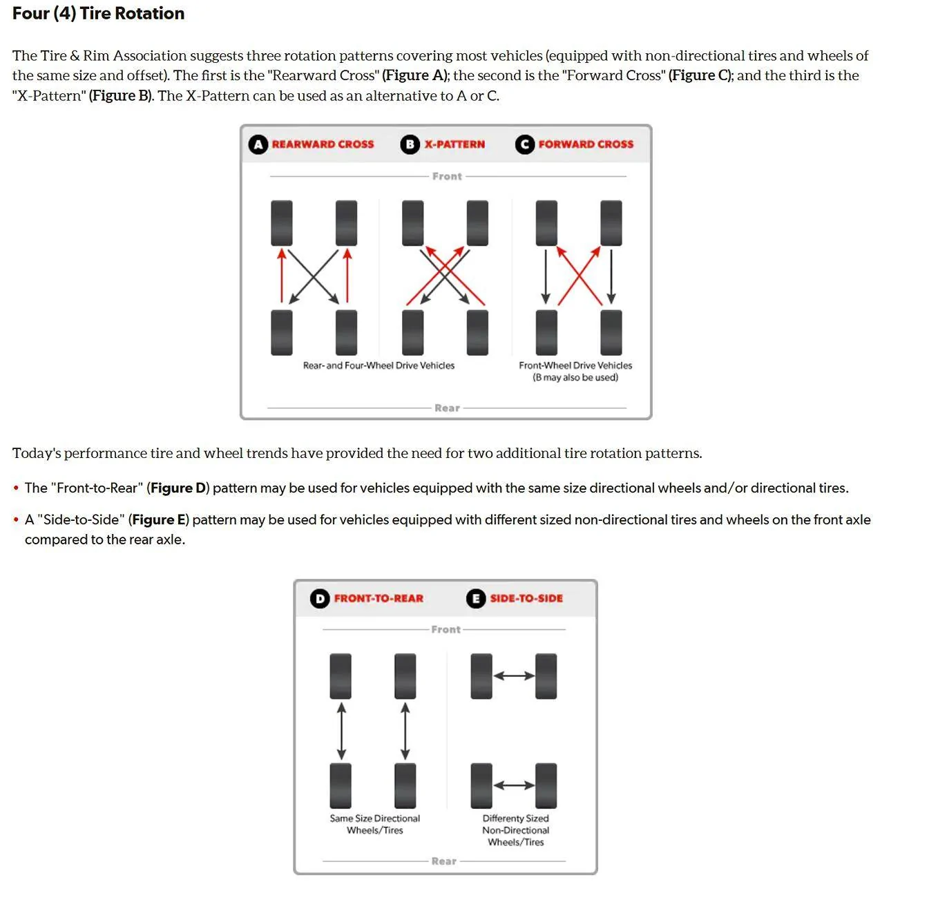

Are 3-ton jack stands enough for the 6600 pound Cybertruck? Not sure how they're derated... I saw some 6 and 12 ton stands at the store, so that just had me thinking....
What is the standard operating procedure to get the truck on 4 jack stands?
Tesla Cybertruck Recommendation for DIY tire rotation equipment? 1729872191111-8m
Wouldn't you need to put the whole guy on 4 jacks to do the appropriate X-rtation?
