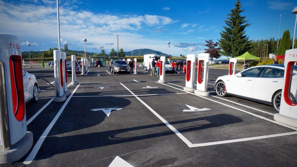

Question. Why do you need to unhook to supercharge? All the new superchargers are pull-through stalls?
New ones built now do. However, existing ones do not and that is the majority right now. Even with pull through I am not sure all locations can accommodate a 30Ft travel trailer not blocking the way for others. i will use them but based on traveling over 150k miles in Tesla's I know the majority do not work without unhitching. Also, most spots have 1 pull through at least for the ones built pre 2021. So if its taken you are out of luck. I am okay unhitching and doing that but love the freedom of being able to charge my vehicle anywhere. It's like having my garage wall charger on the go!

Check the Plugshare photos of the Strassburg, VA Supercharger station. These are not "pull through" but you can obviously "pull in" and charge leaving your trailer out to block traffic. Several stations (Vienna, VA; Joyce Kilmer) have on or two terminals set up for pull in at one or the other or both ends of a row of back in's. You can charge at those again leaving your trailer out to potentially block traffic. True pull through I don't think I have ever seen.
