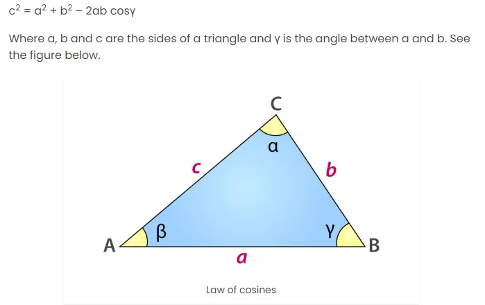

I'll take a stab. Fun geometry problem.
Drawing a triangle from the center of the front and rear outer wheel and the center of the circle and using the law of cosines (twice) and assuming the front outside wheel is what defines the circle, I get 40.8 feet.
a=distance from rear wheel to circle center
b=distance from front to rear wheels (12.6 ft)
c=distance from front wheel to circle center (currently 21.75 ft)
gamma=angle of rear wheel axle
1) a=?, b=12.6, c=43.5/2, gamma=90-3=87deg and solving for a gets a=18.4
2) a=18.4, b=12.6, c=?, gamma=90-10=80deg and solving for c gets c=20.4. Twice that is the new turning circle. 40.8 feet.

[Edit]
I don't think this is accurate either since it assumes the *outer* rear wheel angle increases from 3 to 10 degrees. That would mean the inner rear wheel has to turn more than 10. So I recalculated based on the inner wheel being limited to 10 degrees and now get 38.95ft
[/Edit]
Hmmm. I think it is better than that. I now realize I had a false assumption in this method. a is not the same when you change the rear steering angle. Here is my new method:
1) LOC (Law of Cosines) to find a (distance to rear wheel)
2) LOC to find the max steering angle of the front wheels
3) LOS (Law of Sines) to find the new distance to the front wheels
1) a=?, b=12.6, c=21.75, gamma=90-3=87deg and solving for a gets a=18.4
2) a=18.4,b=12.6,c=21.75, alpha=? and solve for alpha (angle at front wheel) gets alpha=56.7 deg
3) Beta, then, is 180-56.7-87=35.3 degrees
4) changing rear wheel angle to 10 makes Beta=42.3
5) using law of sines, c=sin(80)*12.6/sin(42.3)=18.4ft !!!
New turning radius is 36.8ft! Now we're talking!
I welcome peer review.
Yep! I agree! nice work! I did a quickie in my head. If 3 degrees gave us about a 4’ improvement over no RWS then an increase of 7 degrees should give us another 7/3 x 4 = 9.3 feet decrease. For around 34.2 feet….wow! Much better than my MYP!
