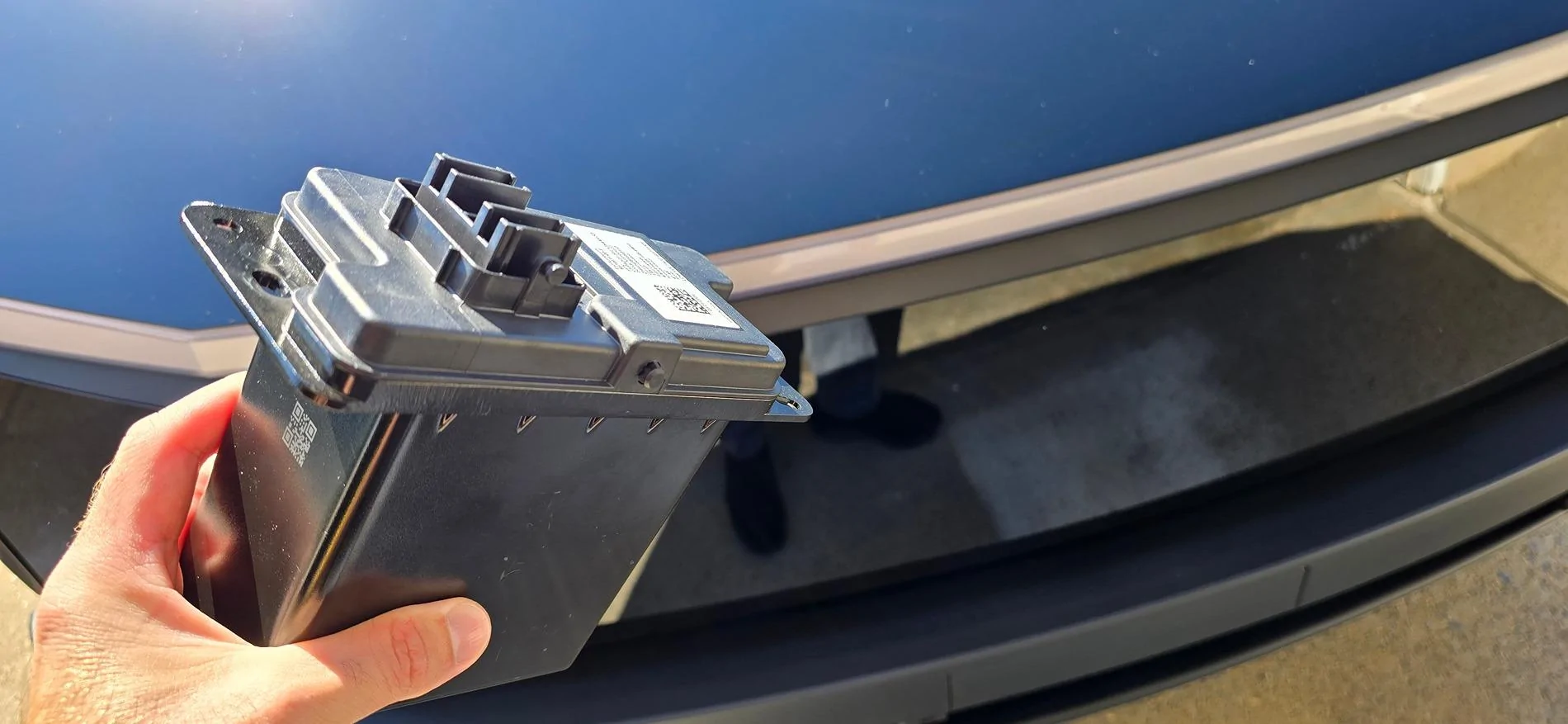

Uhhhhhh, spare 12v battery, anyone?

Was your truck ever in service?
Not that I'm aware of. I haven't had it in for anything but can't speak to what happened before I got it. I received it with 15 miles so I can only assume it was a factory mishap?
