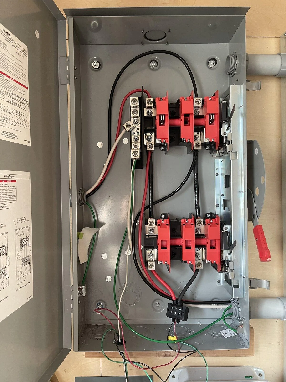

Also check out a sliding lockout bar, e.g. https://www.amazon.com/generator-lockout-kit/s?k=generator+lockout+kit which is simpler than a transfer switch box I think, or perhaps it's the same thing you were referring to.
Very different. A transfer switch looks like this:
Tesla Cybertruck V2G IMG_1718
The utility connects to, say, the upper-most set of lugs and the emergency source to the lower-most. Depending on the position of the handle either the upper set or lower set of contacts is closed allowing power flow to the panel through the center lugs (joined by the black vertical wires). Mechanical interlocks prevent both sets being closed at the same time and thus insure that the emergency source can not be connected to the mains.
