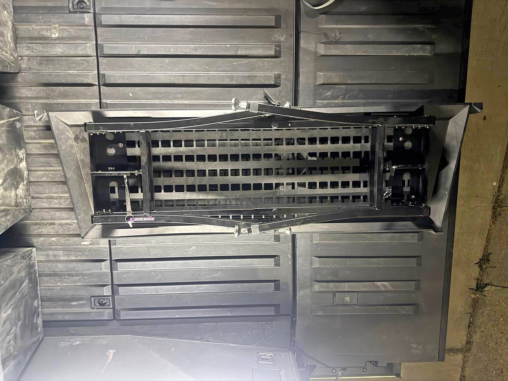

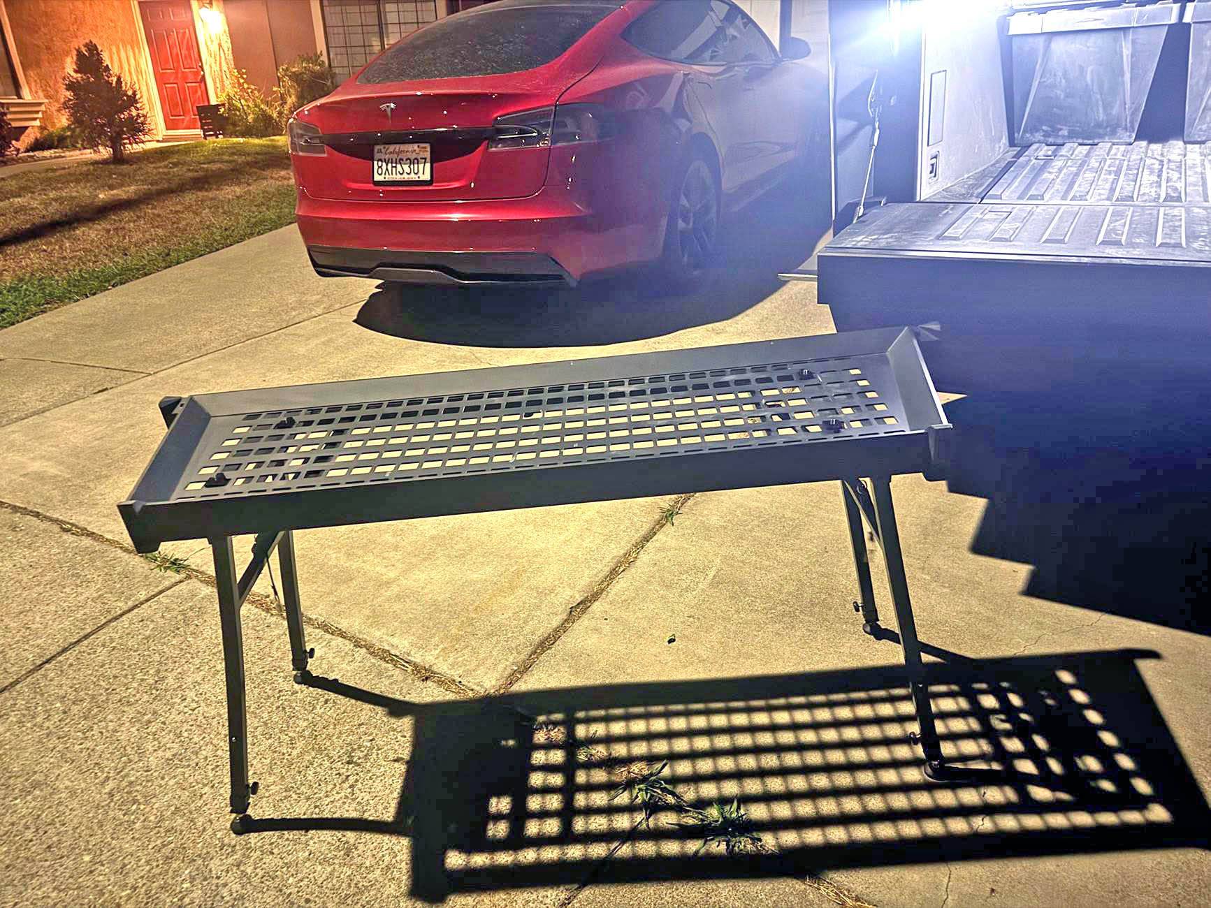

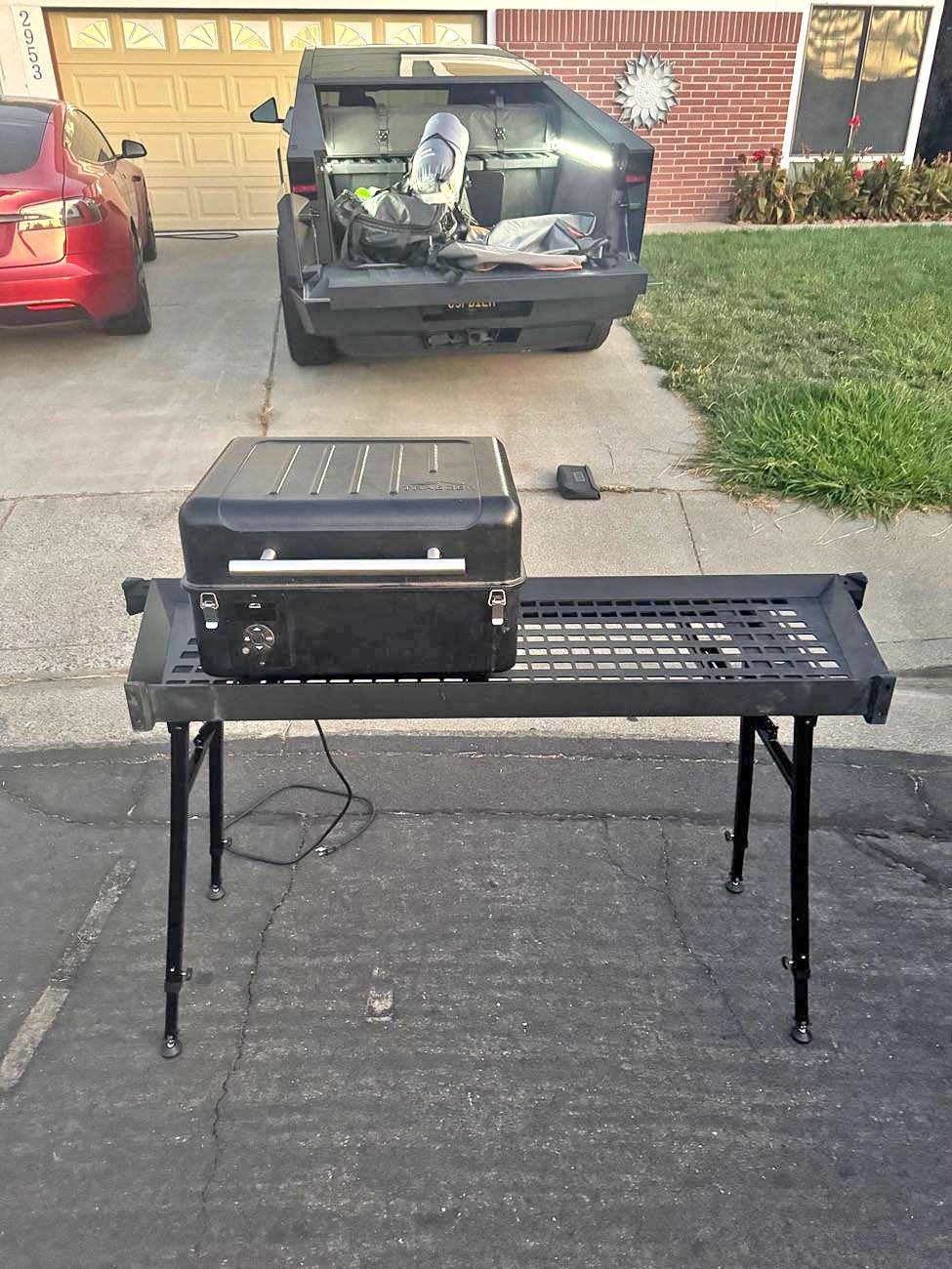

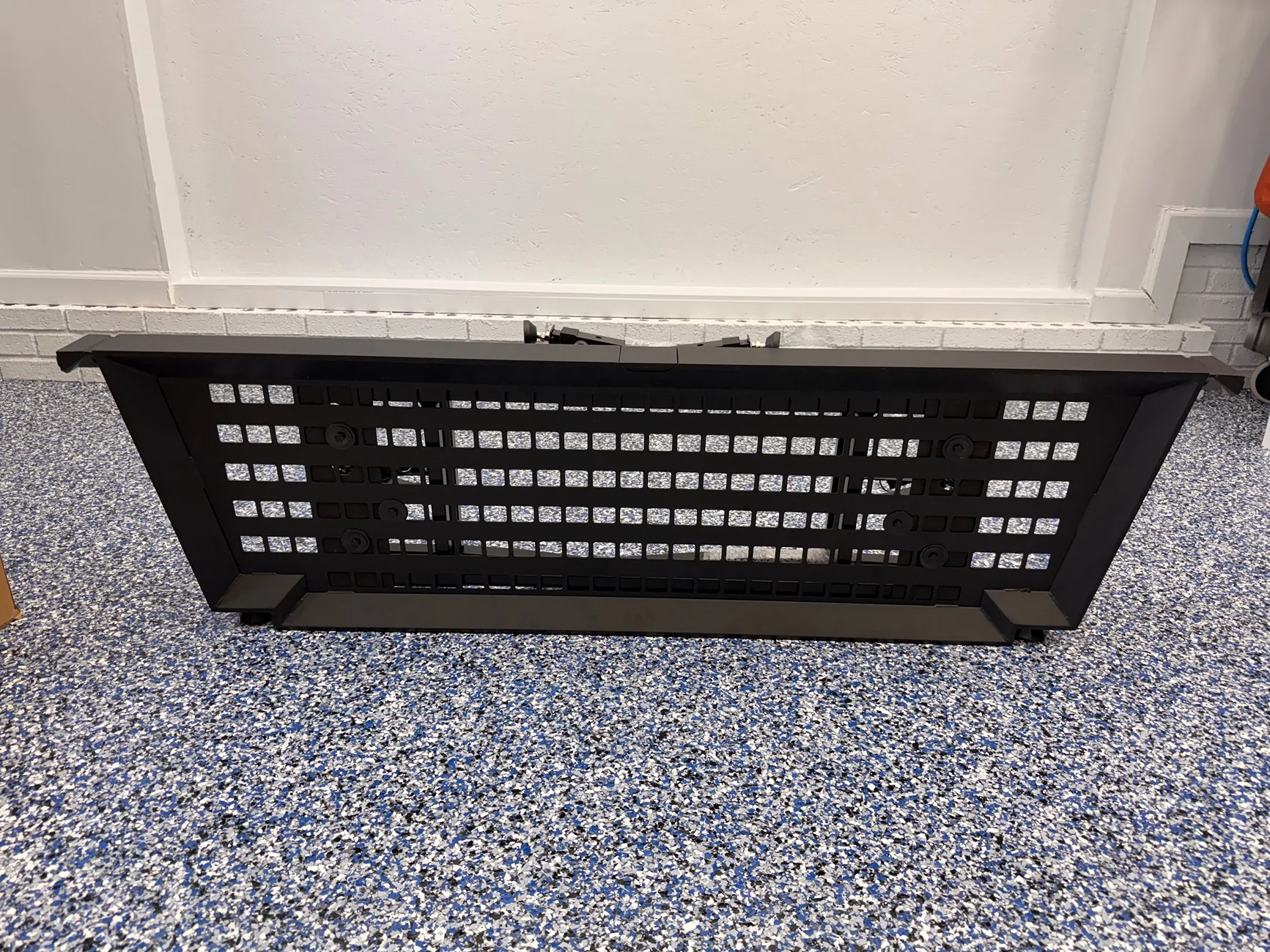

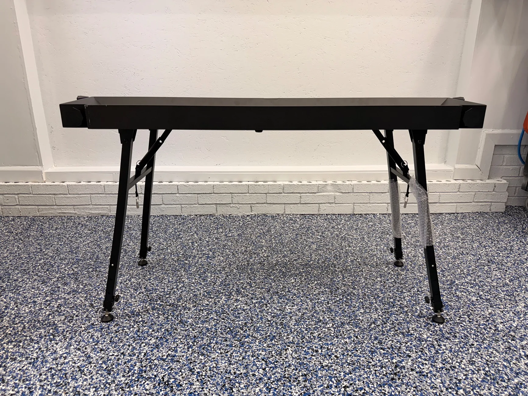

I have been using my Cybertruck and Cybertent as an overlanding setup while working near the Mohave desert since August 5th. Adding and eliminating equipment each trip. I came up with a use of the Vault Divider while the Cybertent is deployed. For around $100, I was able to convert it into a camp table to be utilized for cooking, eating, etc. It has worked great this week and I cooked on my Traeger Ranger every night with no issues from the heat effecting anything on the divider or the stand.
Parts Utilized:
https://www.amazon.com/gp/aw/d/B0BYKFSFD4?psc=1&ref=ppx_pop_mob_b_asin_title
https://rebeloffroad.com/molle-panel-accessory-nut-kit-set-of-4/
Tools:
Drill
1/4 Drill Bit
4mm Allen Key

I looked at lighter and more compact options first. I went with something more robust due to the weight of the smoker and my use case. I like that the height is adjustable. It feels super strong and stable as I adapt my setup each trip.
I usually bring MTBing stuff too. So the ability to camp, cook, and ride has forced me optimize the space available for sure.

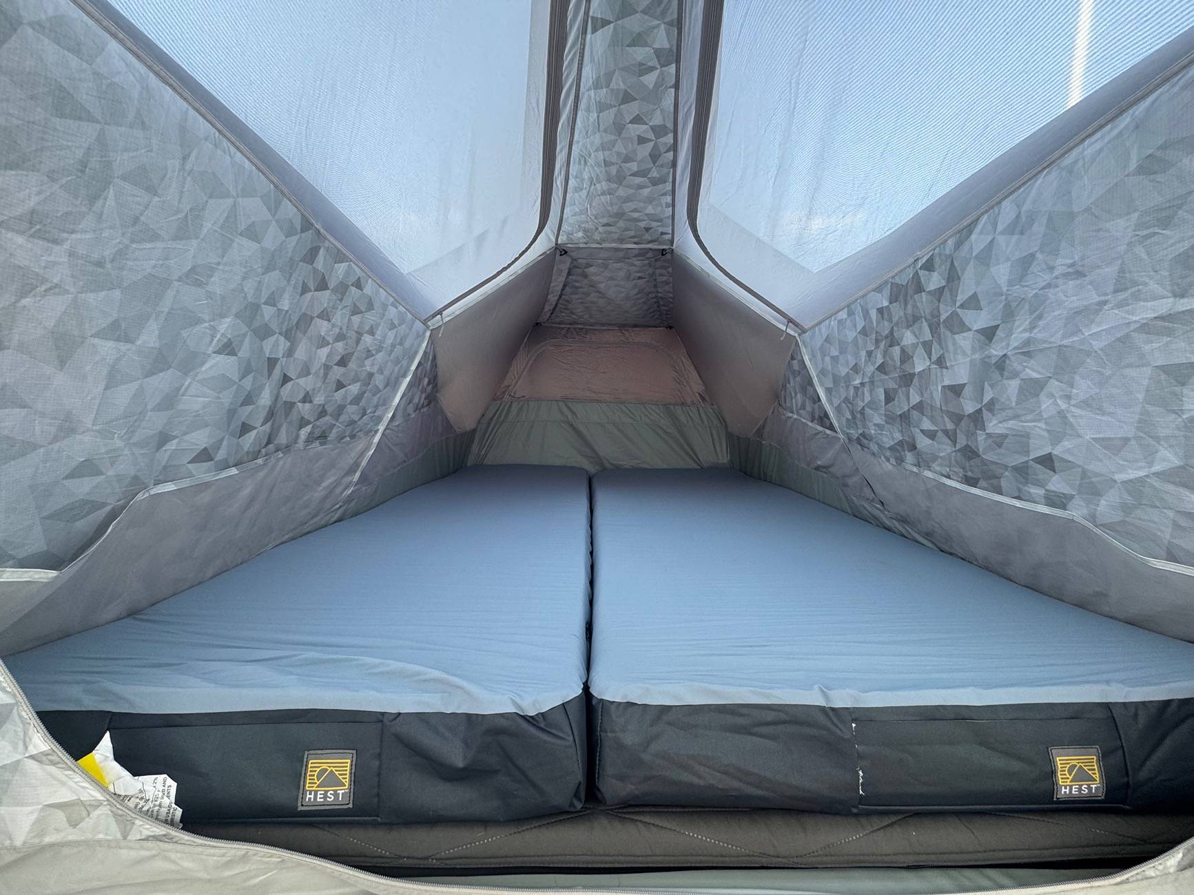

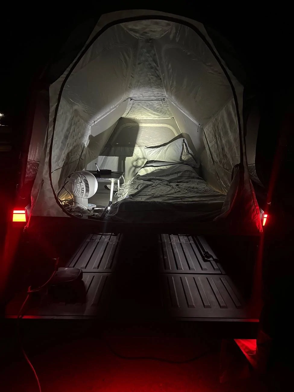

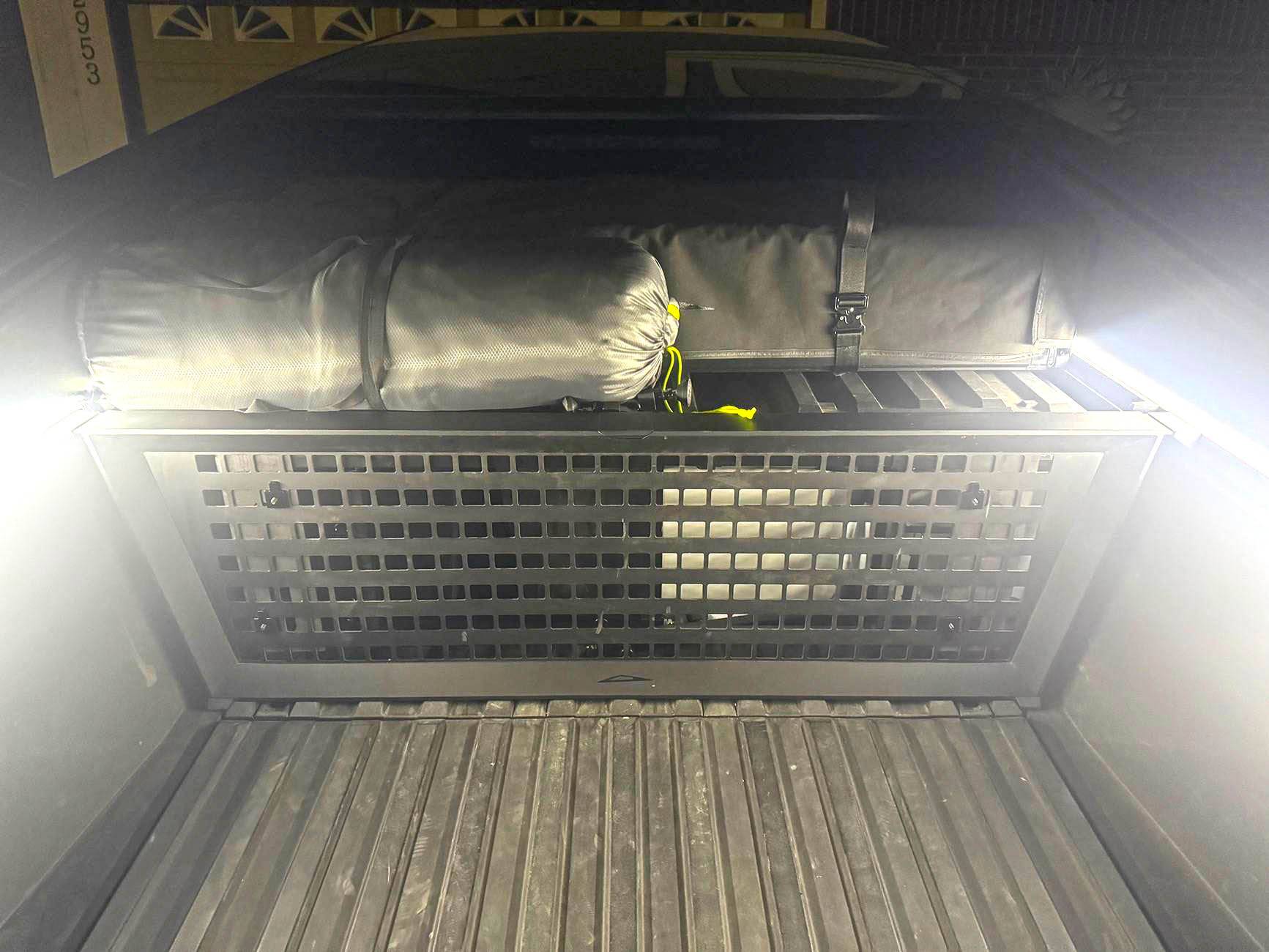

How do you like the Tent? Do you feel it has good build quality? What is your opinion on the mattress?
I like the tent a lot actually. I prob have close to the record because of the way I am using it. I’m coming up on 60 nights in it so far. Half of those I slept on the provided mattress which I wasn’t a fan of. I upgraded to the Hest Foamy Wide and it has been awesome. I also purchased the Hest Foamy standard which they fit together perfectly in the tent for whenever my wife or kids wanna go camping with me. It’s more comfortable than my high end Tempur Pedic Mattress at home. They also fit inside of the Cyber Bins so they are protected when not being used.
The build quality of the tent is awesome IMO. I can set up and tear down in under 10 mins. Go through the car wash if I want and no effect on range. I’m a fan.
I recently did a pump upgrade for the Tent and it has been great:
https://a.co/d/0CuMrOD

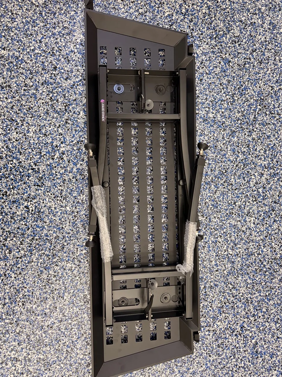

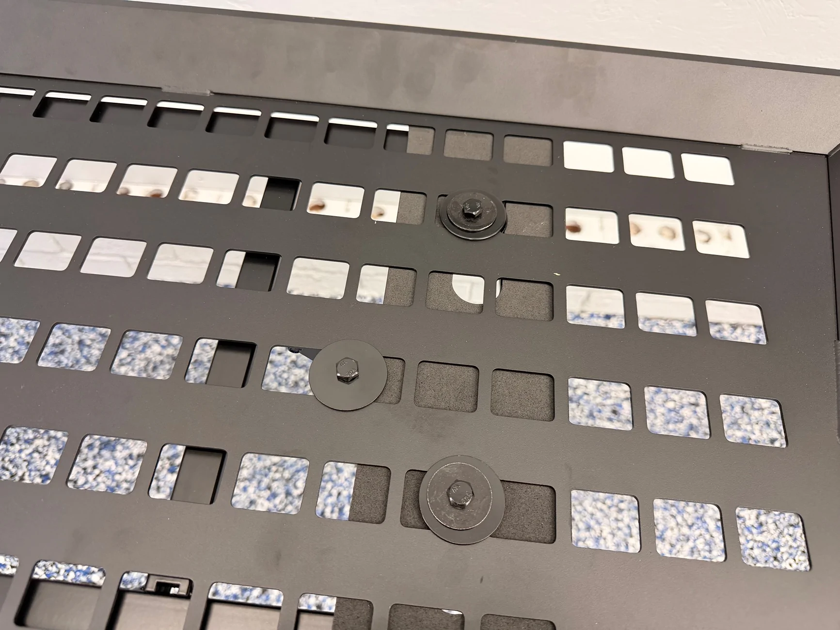

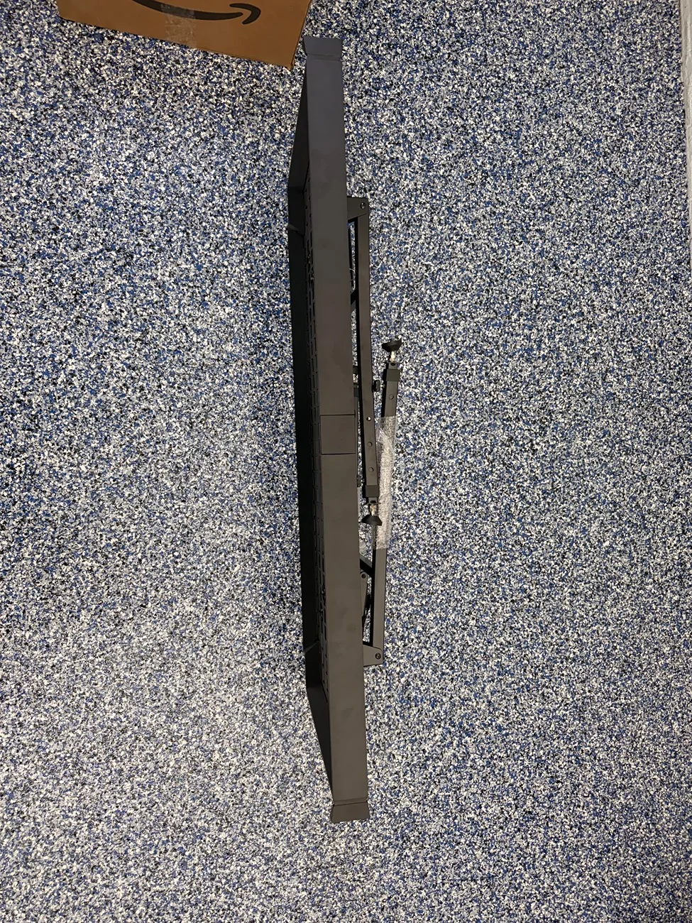

Just did this, very happy with how it looks and fits. Seems super sturdy. Thanks, OP!
I actually only used fender washers and some nuts off Amazon, seem to work better for me than the Molle attachments. Also, no drilling needed so you could easily revert back to just the divider.
Parts, for any DIY'ers!
Vault Divider Off Brand - Seems to be just like some others and has the adjustable feet. (Look for coupon). One note you can't extend width of the keyboard stand as far but its far enough IMO.
Hex head bolts and nuts
Fender Washers 1/4" x 1 -1/4"
Fender Washers 5/16" 1-1/2"
And of course the keyboard stand OP listed.
Tesla Cybertruck Vault Divider Folding Camp Table Mod IMG_4436
